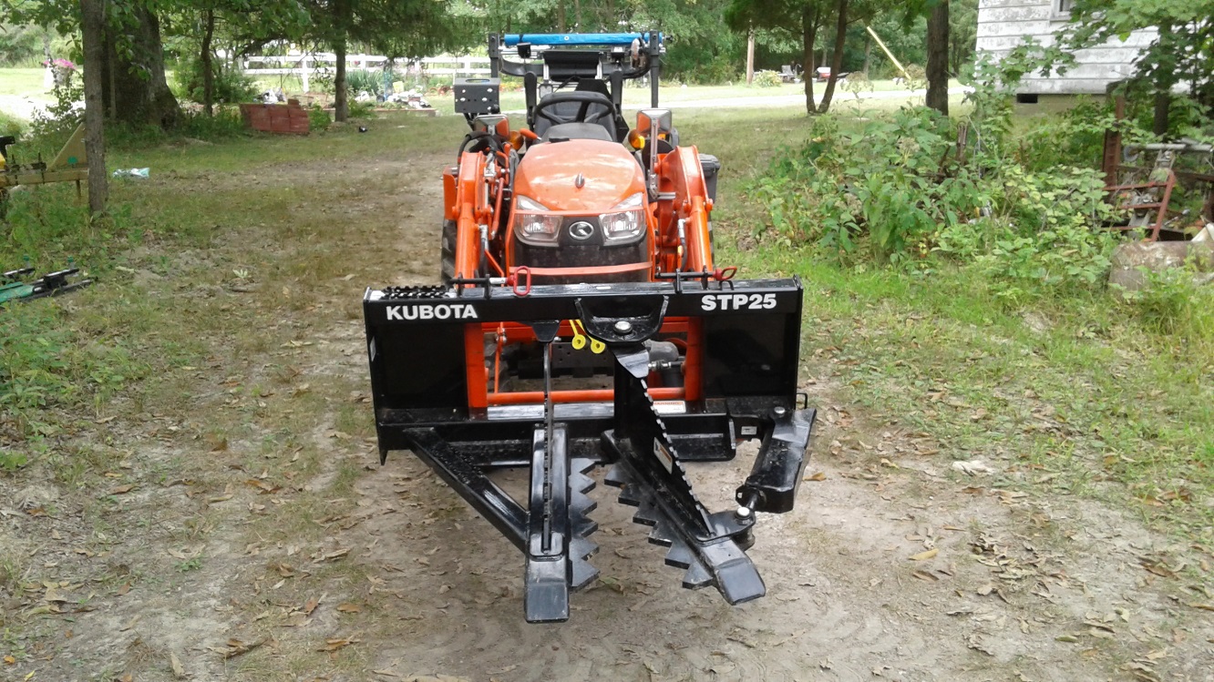

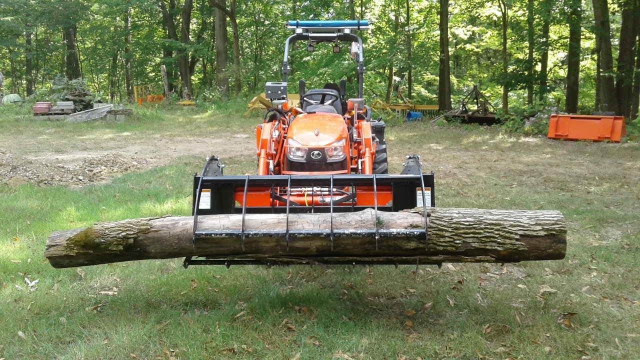

The ebay grapple looks good don't know about steel quality. EA made youtube videos where he's trying to break/abuse it seems to be a quality product. I prefer to purchase from local equipment dealers. I have a kubota root grapple and use it often. Dealing with brush (moving to burning pile) somewhat disappointing, larger lower tines would grab more bush per trip. The only ideal grapple depends on what job your doing.
Once the brush gets too large you may need a tree puller.
