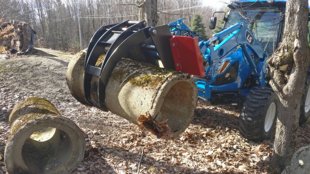

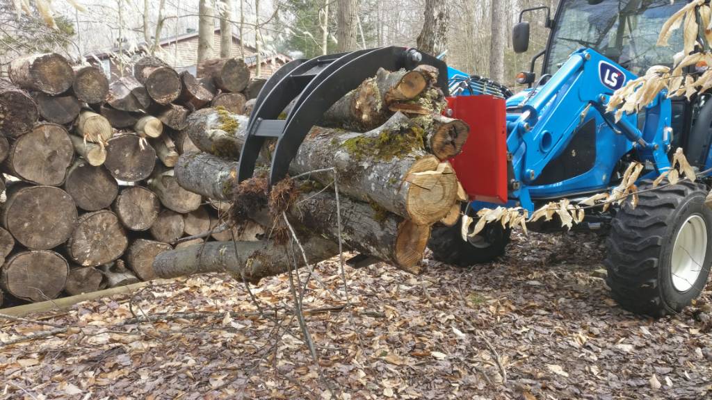

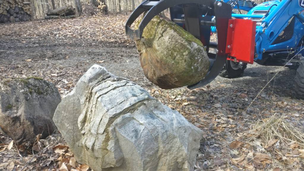

I'm always surprised there aren't more Frost bite/Igland GR20 style grapples in use. That is what I have and love it. I use it primarily for moving logs and rocks. It is much lighter (~350 lbs) so it doesn't kill lift capacity, and much cheaper ($1,200 - $1,500).
About the only thing it isn't quite as good at is picking up large piles of brush, but I don't have that need. For moving rocks/logs I think it's superior.
It also has a cross plate that bolts between the two lower tines so you can pick up smaller rocks easily. IMG_20200404_154817.jpgIMG_20200404_154107.jpgIMG_20200404_152233.jpg
