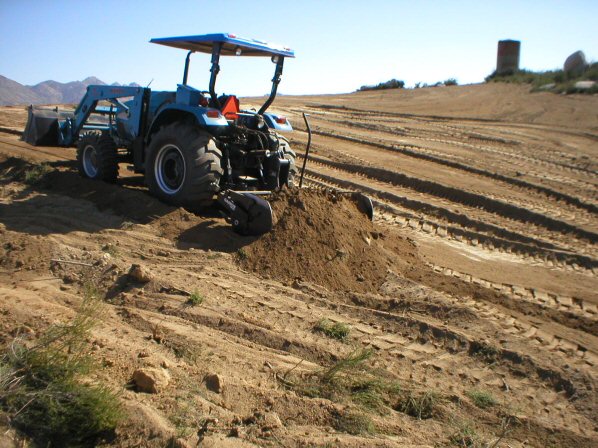

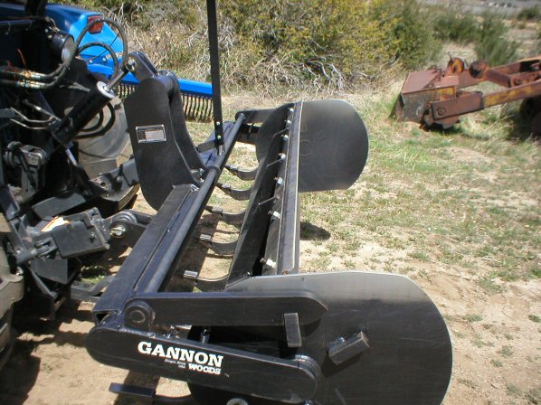

Obviously this is only my opinion, but to be clear, you are asking about maintaining the road. I also maintain over one mile of road. I have 4 implements that I use at different times. I have a roll-over box blade, a landscape rake, a rear blade and a grader blade very similar to a Road Boss grader. They each have a purpose, and each can and will maintain a road. But, if I only had one, the one that I would prefer to have to maintain my roads would be the Road Boss type of grader blade. Relatively easy to use, hard to screw things up with it and no moving parts to fool with. A very tough implement. I actually have 2 of them, a 7 footer for my bigger tractor and a 5 footer for my 32 horse tractor.

How do you like your rollover box blade? I've never seen one of those before. It kind of looks like a cross between a box blade and a rear blade.
One of those might come in handy for my needs.

Ronnie, it is a great implement. They were first made this way before anybody had any rear hydraulics to get the rippers down, and yes it sort of does work like a rear blade. I prefer these to a std box blade and might even have an edge on a good heavy duty box blade with hydraulic activated rippers. But then that probably is just me. Here are a few more pics.
