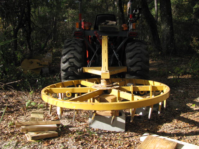

What is that circular implement?
   / Best Attachment for Breaking Up Ground? Box Blade to Plow/Break Up Ground? #17
I believe its called a rotary harrow. It has pins on the bottom with a slight clockwise or counter clockwise angle. As you pull it, the angle of the pins causes it to rotate. Used for smoothing & leveling, primarily in arenas with softer ground or sand.
