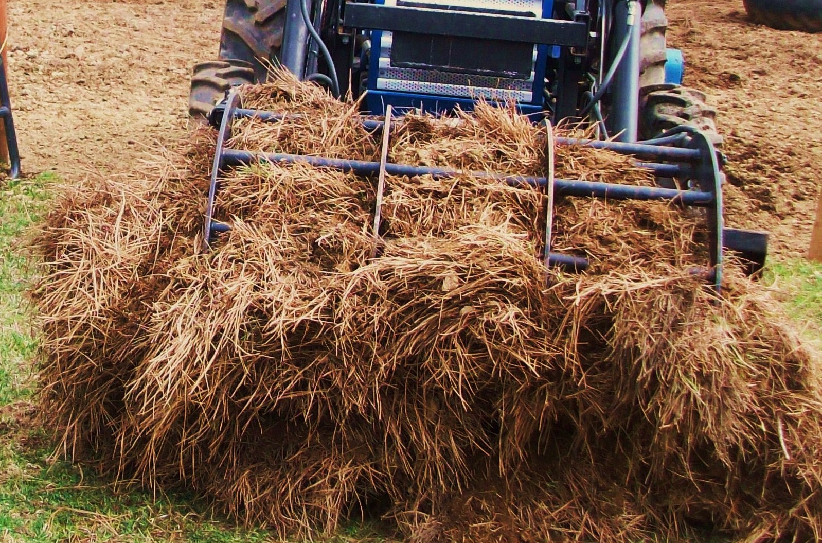

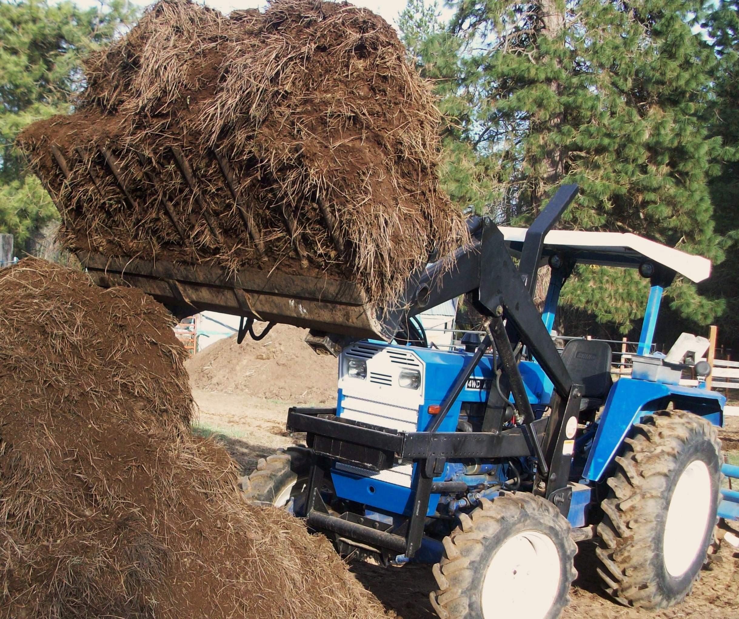

It's a pretty good amount of trails and rolling hills with a few shallow creek crossings.
Looks like the grapple is the way to go. Spoke with EA today and they seemed to think also that the grapple would be best but both would be better..... (naturally). Made sense though. Said run with the grapple down to grab the bigger stuff and the rake pulling behind will grab all the smaller pine needle sections and looser debris that would fall through the grapple.
I will agree with EA on this one . If the stuff in the road you are trying to remove is pine needles and not full size tree roots a landscape rake and grapple will probably work. we cleared pine needles this way...
Salaras field -pine needle removal 001.JPG Salaras field -pine needle removal 004.jpg
If you have larger embedded slash in the road- and your box blade has rippers you could loosen the debri and then rake it .
Once that is done grapple it up and go from there... In removing these pine needles the rake did all of the gathering and then the grapple just removed the piles.
good Luck with whatever method you choose :thumbsup:
