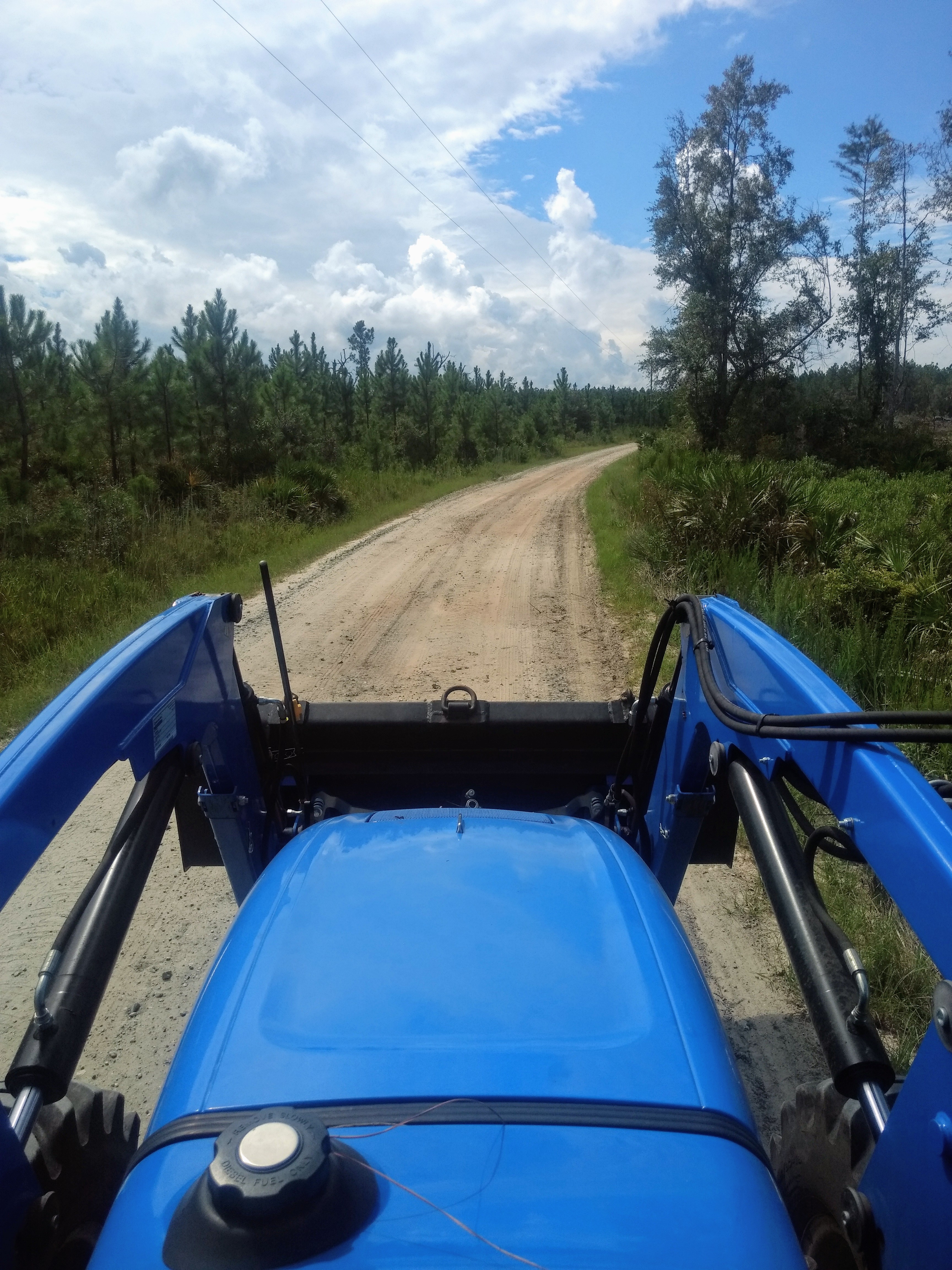

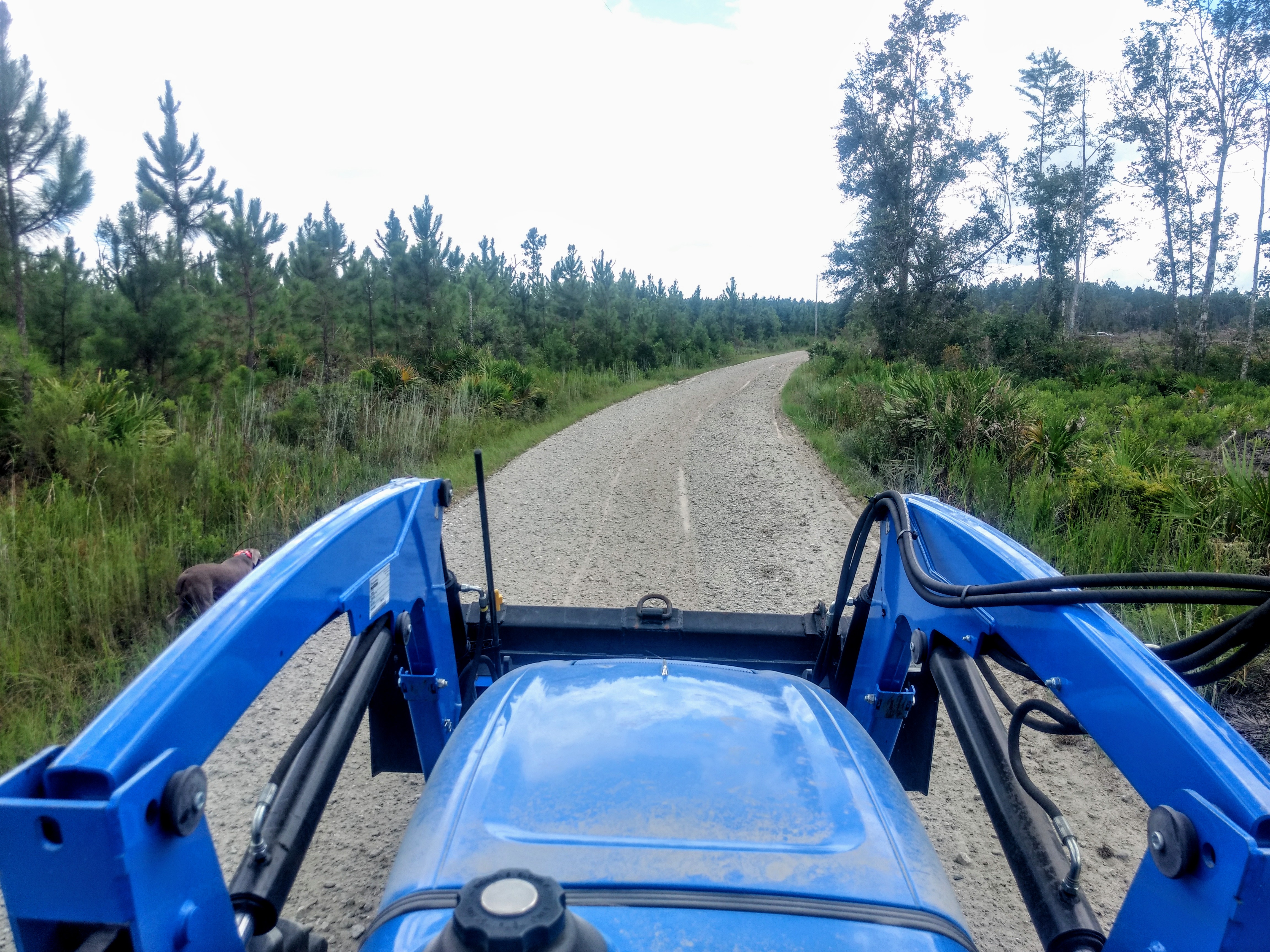

To maintain gravel though hands down a Land Plane/Grader. Here is a road I did a few months back with one I built. I'll add before & after pictures for you to see what it will do after 500+/- semi's use the road at about 90,000 lbs each. They are extremely easy to use as well and give the smoothest road of any pulled behind you.

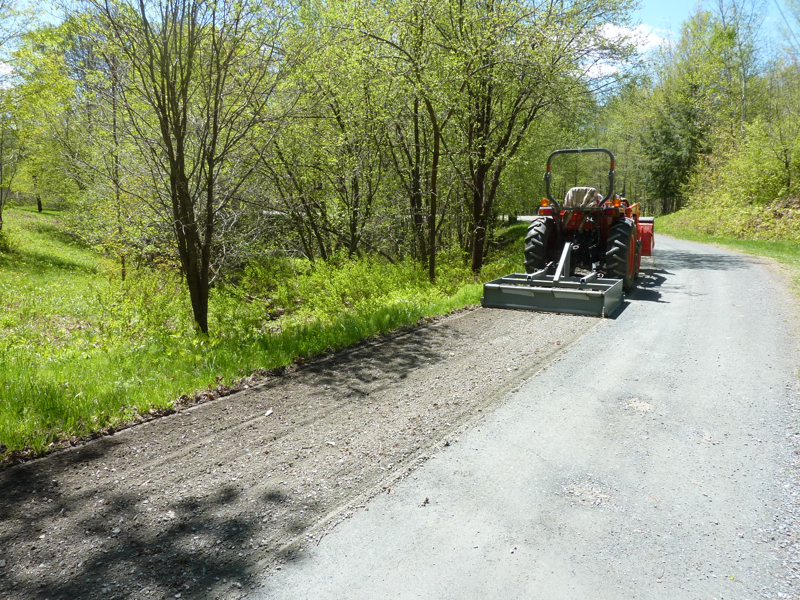

Actually my road packs pretty hard - probably as hard as yours. The finish material is a mixture of crushed ledge products from 3/4" down to stone dust. All the angular edges and sizes lock together very well after being wet and compacted. My after grading pictures look like loose material because the landplane cuts and remixes the top layer of the road surface. Here is an in process picture
I also have lots of road to maintain. I have a rear blade, box blade, and land plane. The landplane gets used the most by far. I have no trouble maintaining the crown with it but use the rear blade to build or rebuild an overly worn crown. I use the box blade the least - almost never, for road maintenance except for a severe washout. For new road construction it is great.

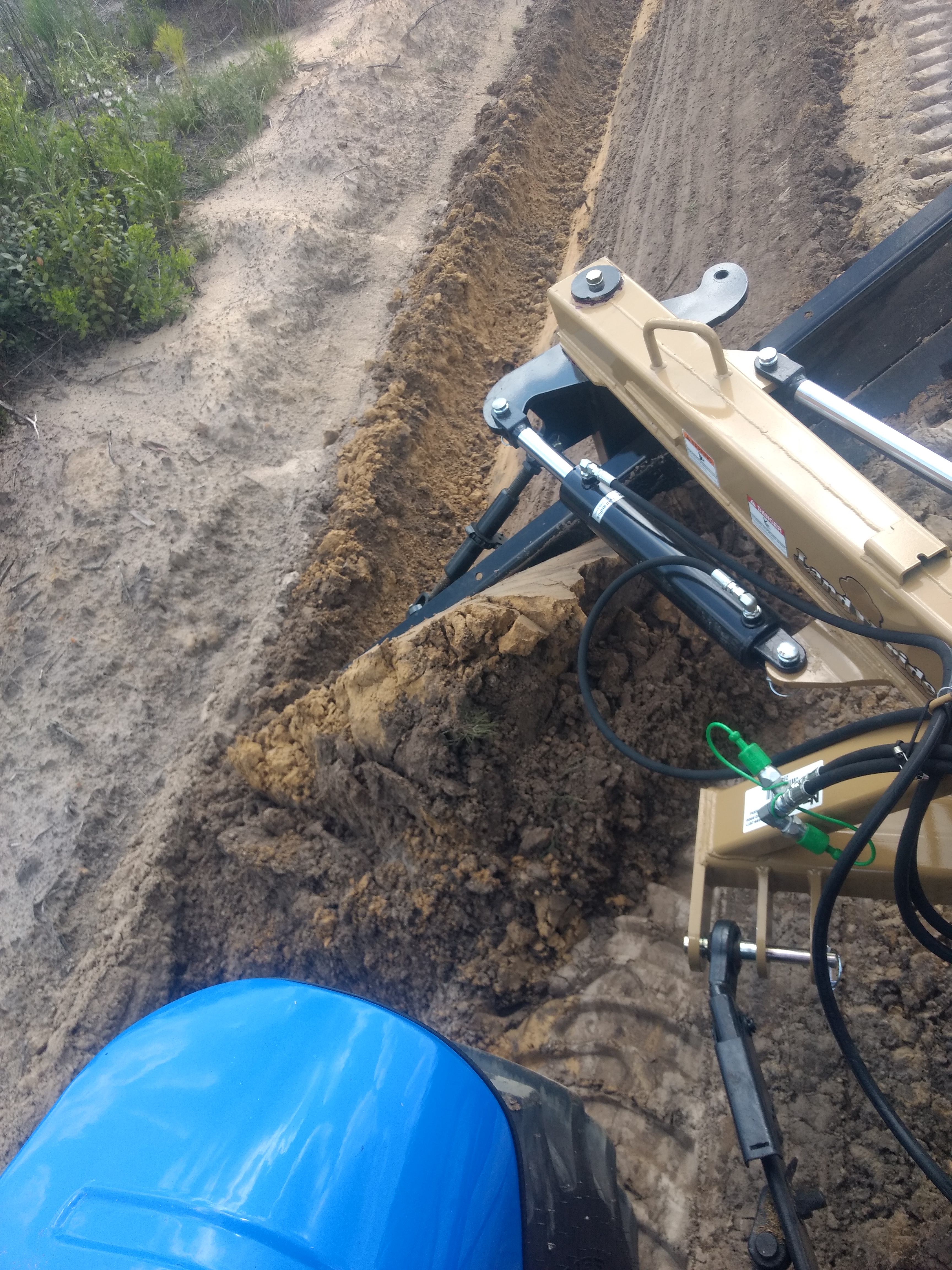

Here is my Land Pride RBT4096 pulling ditches on our drive.

You have a pretty road, but not much of a crown from what I can see in this one photo. I'm not being critical...it just seems pretty flat/level straight across. Nothing wrong with that if that's the way you like it...except water will lay in the road instead of running off. Our house site is up a mountain, so we need a better crown to keep water running off the road instead of down the road. A really good crown solves most maintenance issues, especially with a solid rock base.
