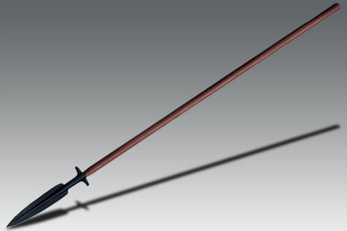

Bah. .30-06 is for boar is for panty-waists. I understand Cabellas has a really nice boar spear for under $100 for those of us who want to prove how manly we are when it comes to hunting dangerous big game. 95BOASK_m.jpg

Bah. .30-06 is for boar is for panty-waists. I understand Cabellas has a really nice boar spear for under $100 for those of us who want to prove how manly we are when it comes to hunting dangerous big game. View attachment 413940
:)Count me in with the panty-waists:p
