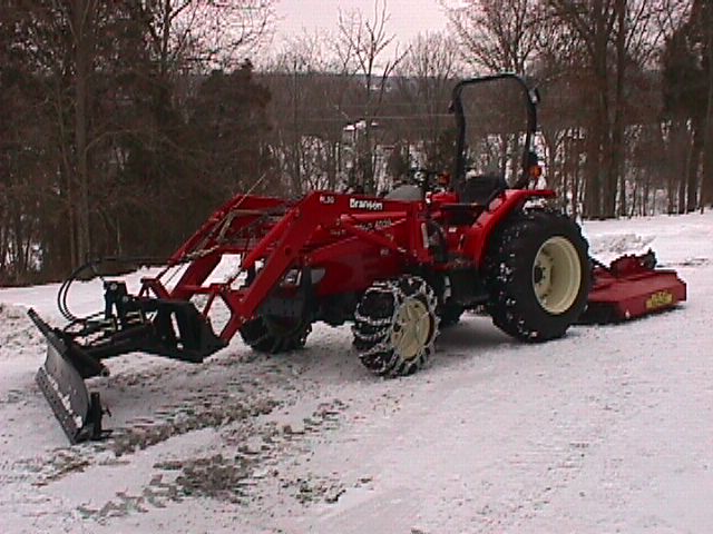

Such a refreshing topic, to talk about snow after having 6 straight days of 90+ degree heat with humidity to kill a guy. I started with bucket and back blade, turning the blade around and going backwards....and using the bucket to manage the larger snow piles. I think I started dreaming about snowblowers , but decided they were not justified where I live...( however a freak 2' snow we had last yr got me thinking about them again. ) Anyhow, I got concerned about going backwards down my steep drive and hills around my house. I bought a Fel mounted blade made by a local Indiana company in Shelbyville, Indiana... called Kasco. Since I have a lesser know brand tractor.... (kukje - branson) , my dealer had the kasco people make a set of quick mounts to fit the branson fel. It is a nice piece of equipment, and has hydraulics to change the angle. I didn't have my tractor plumbed for front hydraulics...so I just use the curl circuit of my FEL. The drawback using the curl circuit , is that the angle of the blade...top to bottom remains fixed.... but overall it works for me. The blade is very heavy, especially mounted out on the end of your FEL. You will need counter weight on the back. Mine has skid shoes. Even with those, I have a hard time on my gravel drive not pushing out some gravel...eg the shoes will dig into any soft gravel and make small ditches. I have been thinking about trying wheels...someday. It really does a fine job on the county road (blacktop). I can use both my back blade and the front blade at the same time...pushing a large portion of snow with the front blade, and letting the back blade clean the spoils. As for the gravel drive...after the drive gets frozen in real well, the issue with digging into the gravel goes away.
If I were you... I would first try using just the rear blade and your bucket for awhile and see how that works for you. This is the cheapest option. You can always use the rear blade for other things like Egon mentioned. You may find these work perfectly well. The fel mounted blade is going to run you 4-6 times the cost of a rear blade , so you can afford to test the rear blade out for awhile.
I don't know if you are in the flat part of Iowa, or hilly. If you have hills, you may want to look into front tire chains. These work well for me on my 4wd tractor. I don't do much slipping, and helps me control my steering. I am including a picture of my rig...and my counter weight just happened to be a bush hog (I wasn't really mowing snow... just took delivery of both implements when this picture was shot).
