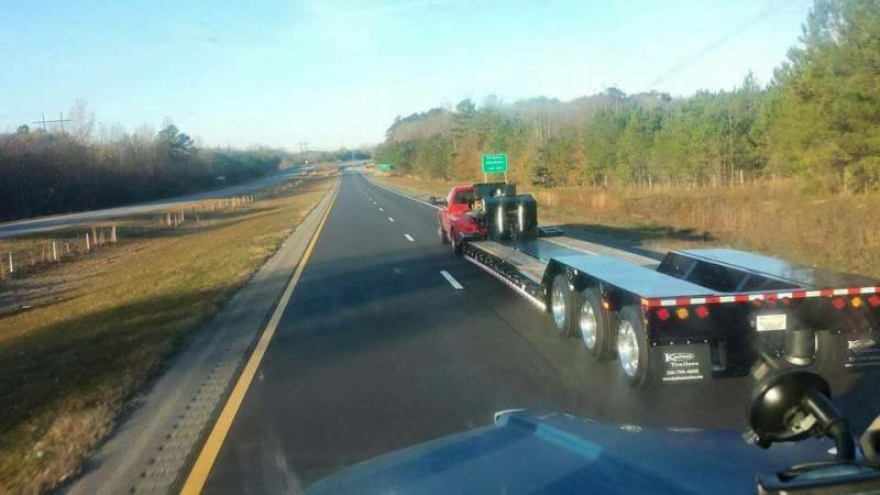

Rare, but it has been done. Kaufman apparently has a Dodge 3500 with one:
Here is a thread where someone put a belt driven air compressor and valve that ran off of the OEM brake pedal: Air Brake Trailer behind a hydraulic brake truck? - Pirate4x4.Com : 4x4 and Off-Road Forum
