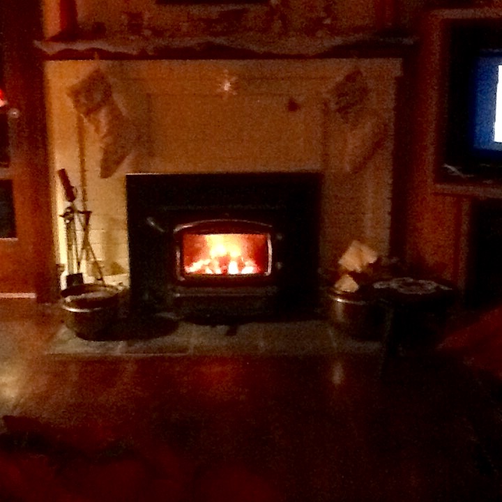

<img src="http://www.tractorbynet.com/forums/attachment.php?attachmentid=522011"/>
Yes, a previous house had a medium and large free standing stove. Our present house has a small fireplace insert.
Is that insert a Regency?
   / Best Brand of Fireplace Insert or Wood Stove
#40
Harman stoves are very nice stoves.. they make probably the best pellet stoves on the market..
I see one wood insert. Looks like a very good brand.
