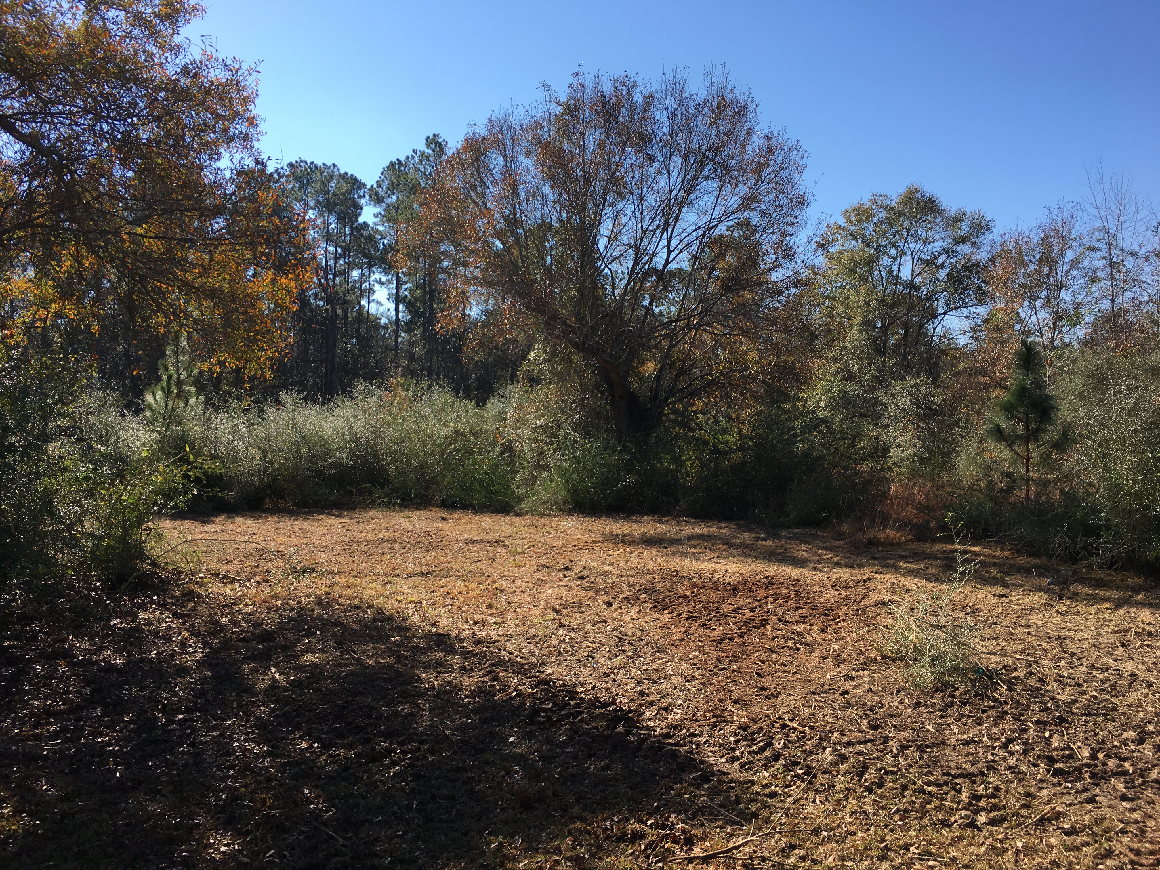

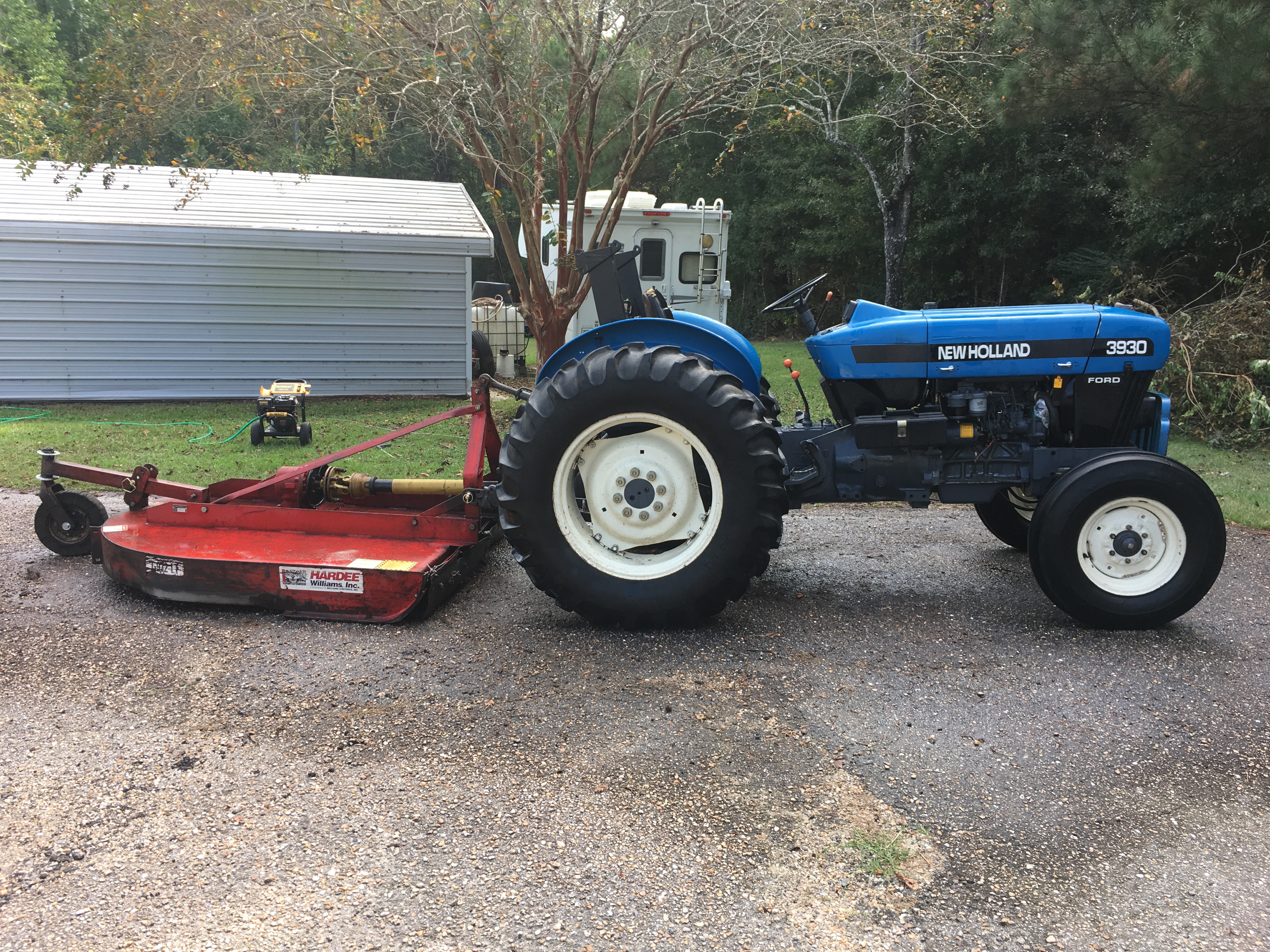

My vote for bang for the buck is a Hardee 972, 1072 or 1172. Awesome cutters and very heavy duty and well made. This one has extensive time behind the ole NH 3930 and done some amazing clearing behind my M7060. It not only handles what ever you can drive or back it over, it also does a super job mowing grass. I would buy another one without a second thought. Another good thing is the 972LT that I have owned for over 25 years is still going strong, only having to replace the belting guards and tailwheel hub. Parts for even discontinued models like mine are readily available direct from the manufacturer and ship out fast. Kubota M7:cool: with 72" Hardee 972LT rotary cutter in heavy grass and weeds. - YouTube
