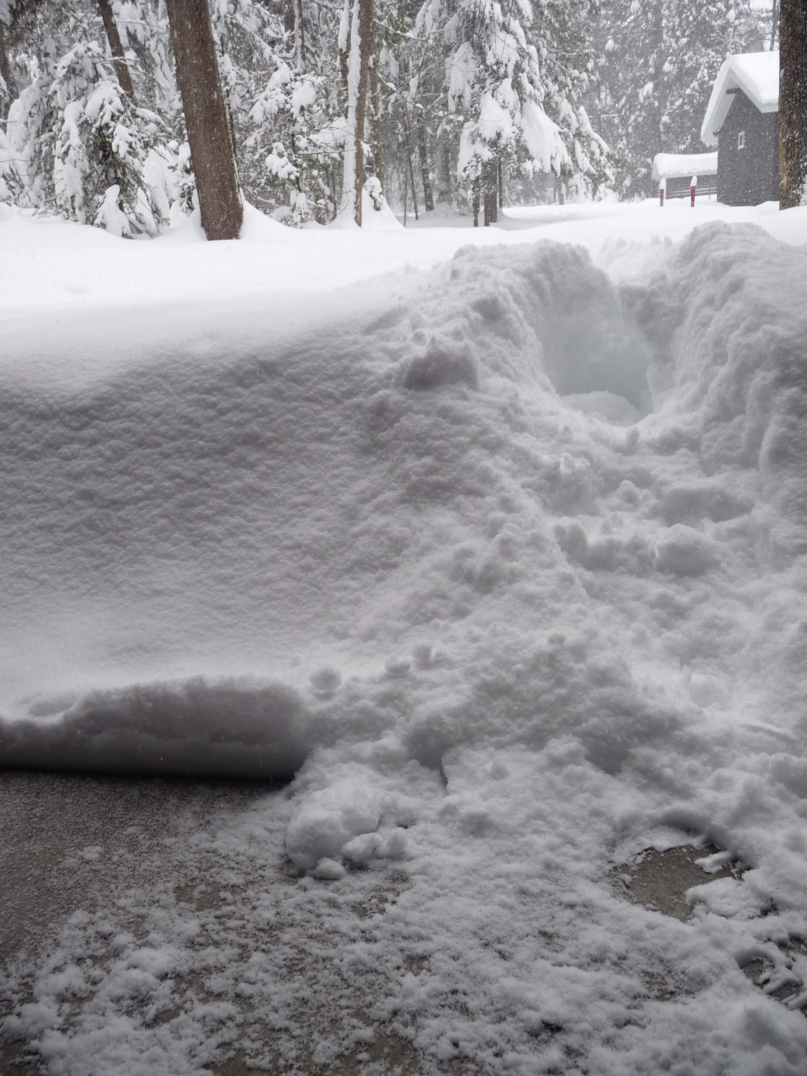

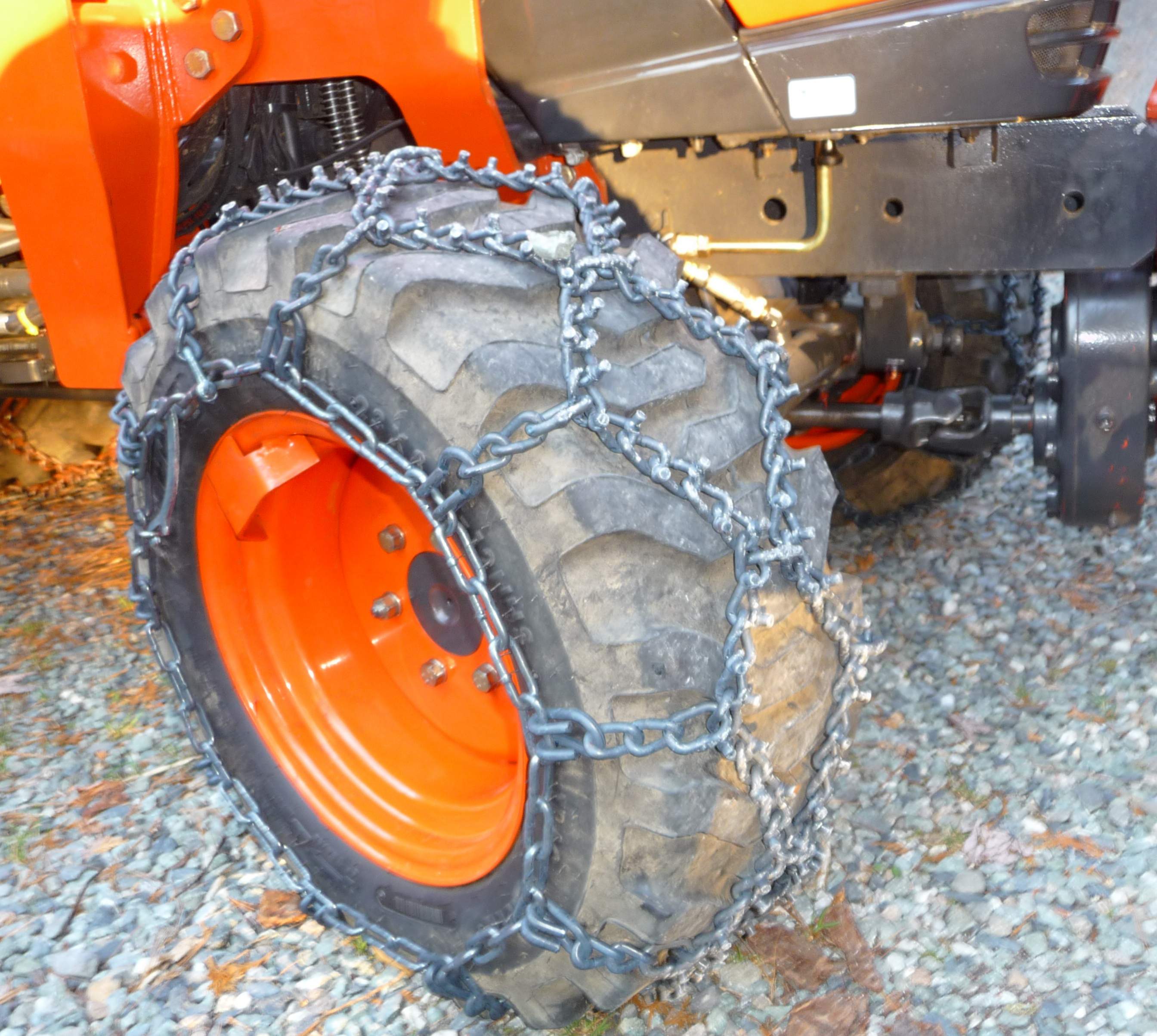

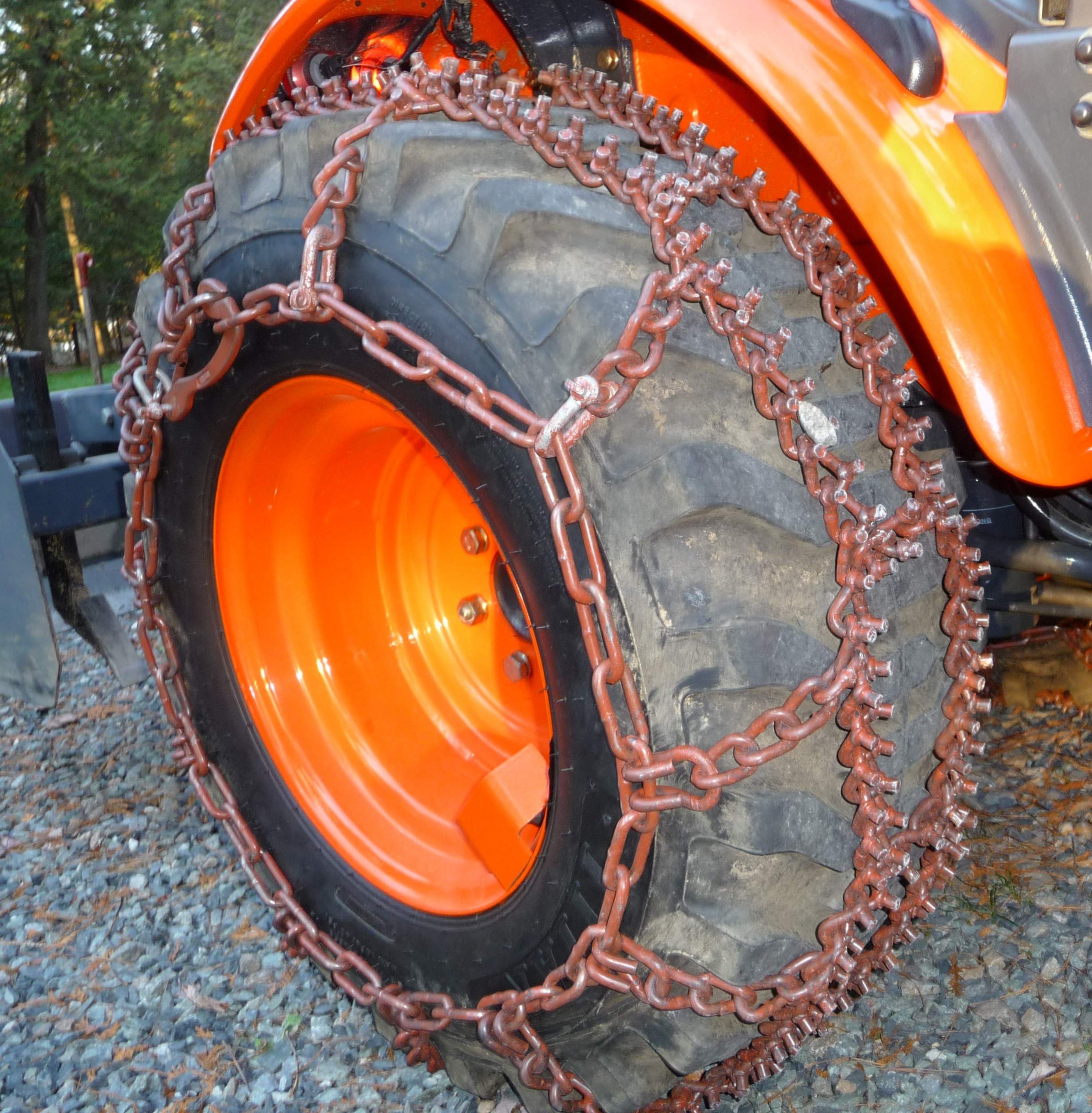

Nice pic GG! Same wheather here in Qc just north of the frontier, same type of chain as you, SMT back, Tryyg up front. It make all the difference: tarction or close to none!
2 pics of the chains, and one of outside the garage door, be prepare!
