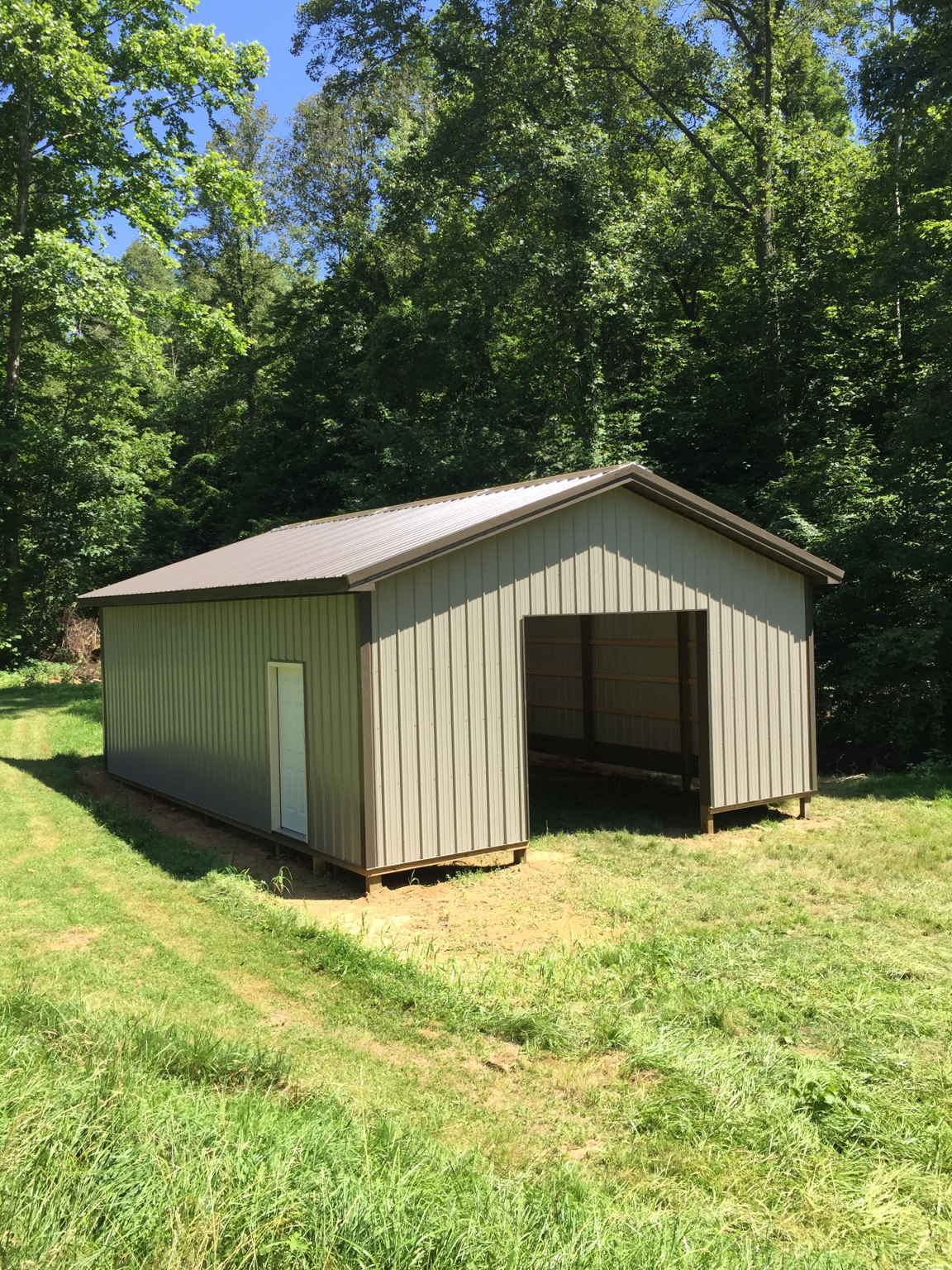

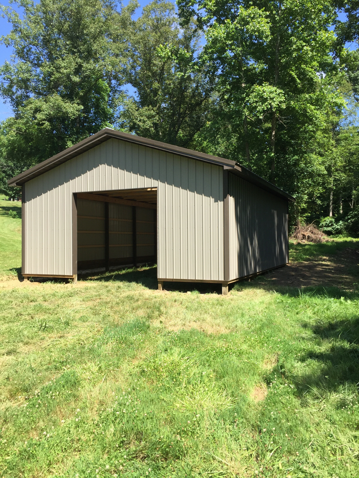

Some pics with the metal all finished up.
   / Best concrete floor prep for pole barn on downward slope #42
Yeah, I知 going to use 304 crusher run to fill. I agree that I壇 have rather had the slab down first but the Amish that built the building said they wanted it down after, the concrete guy wanted the slab first. I understand that as it causes issue for one or the other unless you plan on building on top of the slab, which I did not. I can see digging the post holes would have presented an issue if you had to do the right next to the slab, unless u dug then by hand.
As I measure it I値l only need to place gravel about 1-1/2-2 up on the first 2x8 on the bottom to allow room for the 4-5 of concrete on top. Not sure how much gravel it痴 going to take but I would imagine between 30-40 tons.

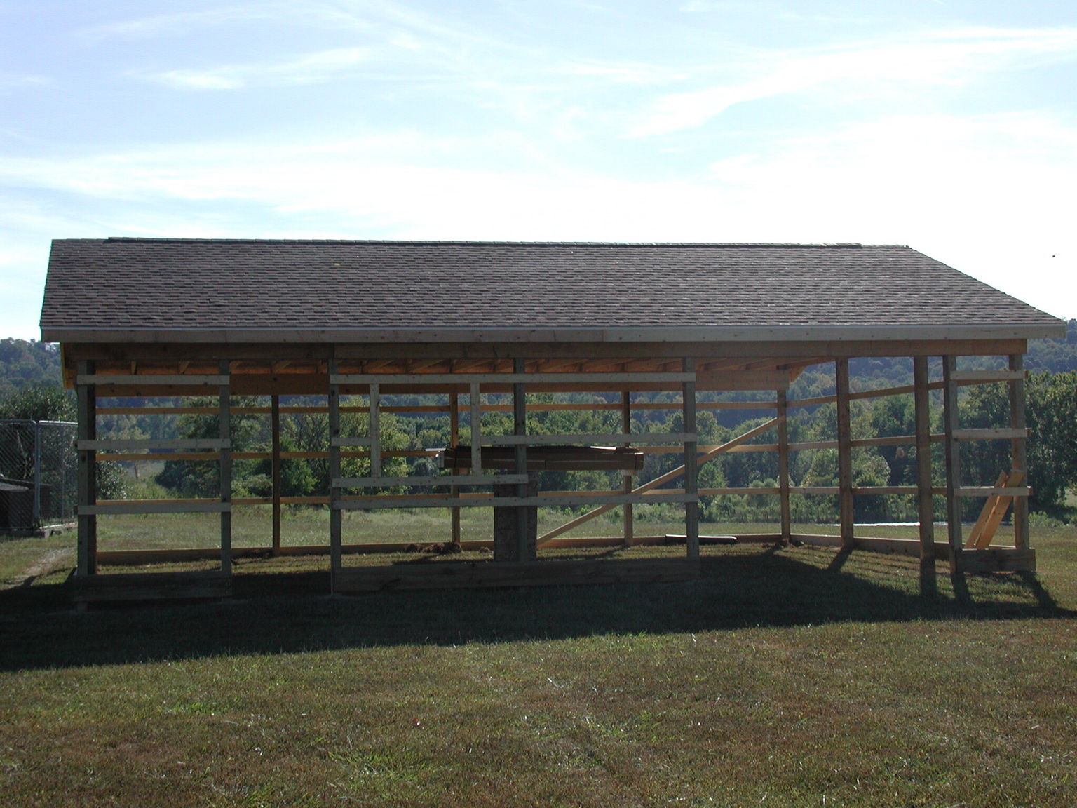

Just looked at another building - 24x30 - I had built back in 2002 and I never removed the sod on it either. If fact I don’t remember the concrete guy removing the sod from it before pouring. If he didn’t, it’s been 16 years and, knock on wood, there is not one crack in it. Also had a 15x30 dog park built and all they did was scrape the sod off with shovels and then laid plastic down and poured a 4” slab for it. Again, knock on wood, but it’s been over 5 years on it as well with no cracks. Oh, and neither one even has expansion joints cut in them.
Here’s a pic of the other building from 2002:
