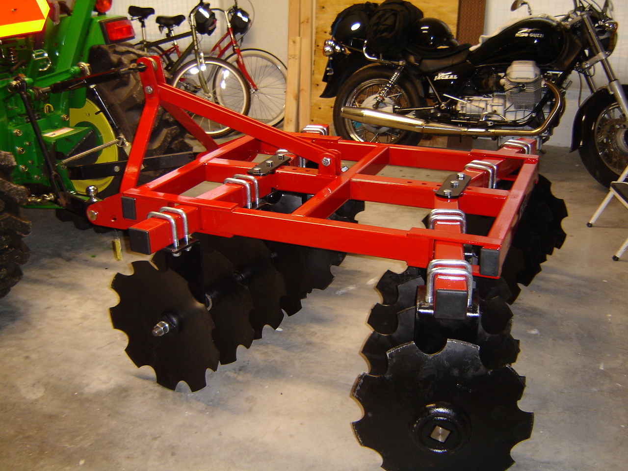

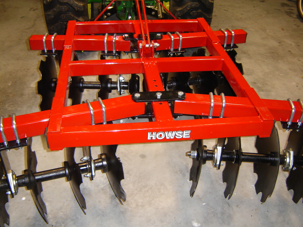

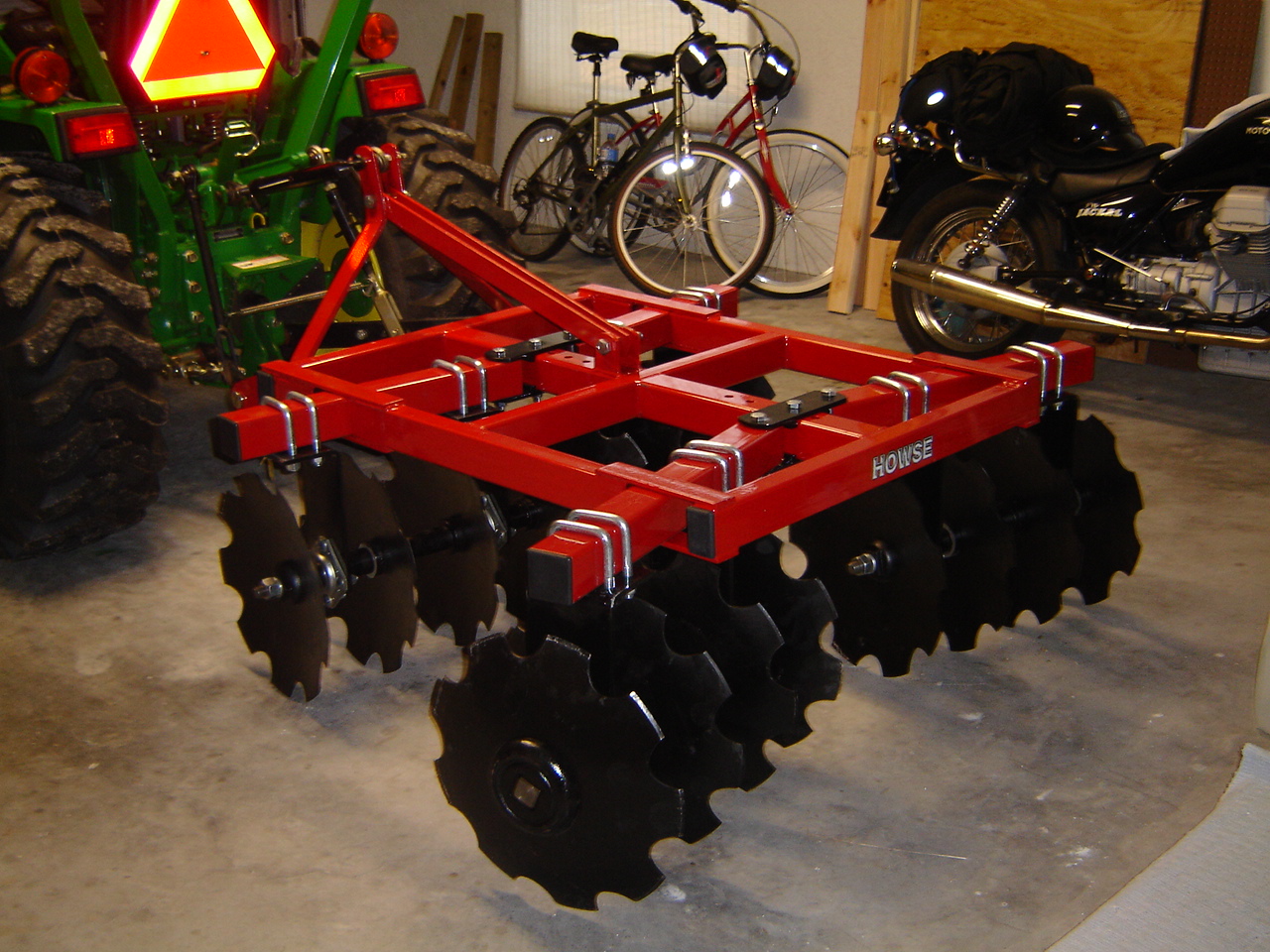

I purchased a DH today. A new Howse medium duty model # DLHT16822B. Appears solid/sturdy, welds look good and the dealer was very helpful, though about 65 miles away. Cost: With tax about $855.00. I think one of the following links should get you to the Howse site with a photo of this particular model if you want to look at it and get other specs.
DISC HARROW 16 18 BLADES W/BALL BRG [DLHT16822B] - $0.00 : Howse Implement Company, Your source for tractor and farm equipment parts and supplies
index.php
Its a 5 1/2' DH with 18" discs weighing approximately 618lbs. The frame is 2"X3" tubular steel, the gang arms are 3"x3". This DH has sealed bearings but you can get it with cast bearings. It has five adjustible gang positions. It also has drop down clevis hitches for the lift pins which may make attachment easier. I have a quick hitch, not sure if it will work with this type hook up or not yet. The only thing I don't like about the purchase, a slight irritant, is the Owners Manual is for a different model. The dealer rep advised the manual has not been updated yet for this model.
Its still on the trailer, stormy day today. I'll try to get it on the tractor this week sometime and will attempt to post a picture if possible. Not getting my hopes up here that I can do that.
If there are questions let me know. Thanks again to you all for your advice comments and info. They were all to the point and very helpful.

Hooked up the disc last night. Will try to post the photos here. Photos are prior to any adjustments being made. Just as I got it.
I adjusted the DH and tried it out today. Leveled it properly and experimented with it as Mr. Thompson suggested. DH Seems to work good. Of course I use the term "seems", because I don't have any experience with one to compare it too. It's not necessarily simple to adjust/ readjust the cutting angles.
