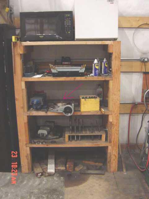

The last 10 or 12-years I've been buying those cheap drill bit sets from ebay, or where ever I can get them. Some of the bits have to be re-sharpened tho.:confused3:

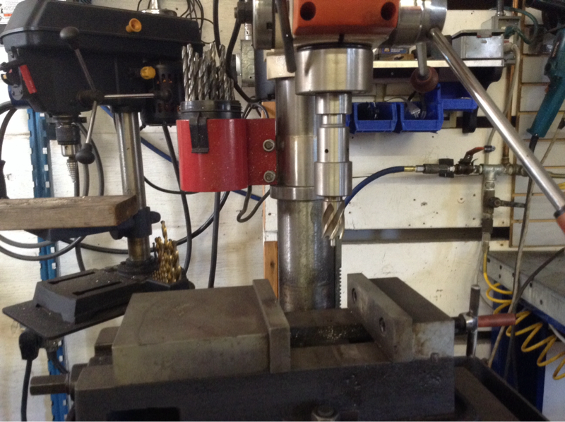

For a 5/8 hole in steel these days I would use an annular cutter. I think they used to be just for magnetic drills. But adapters are available so they can be held in drill presses, lathes. Some annular cutters are designed for hand held drills too. They cut fast and leave a smooth accurate hole.

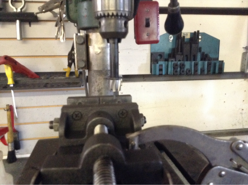

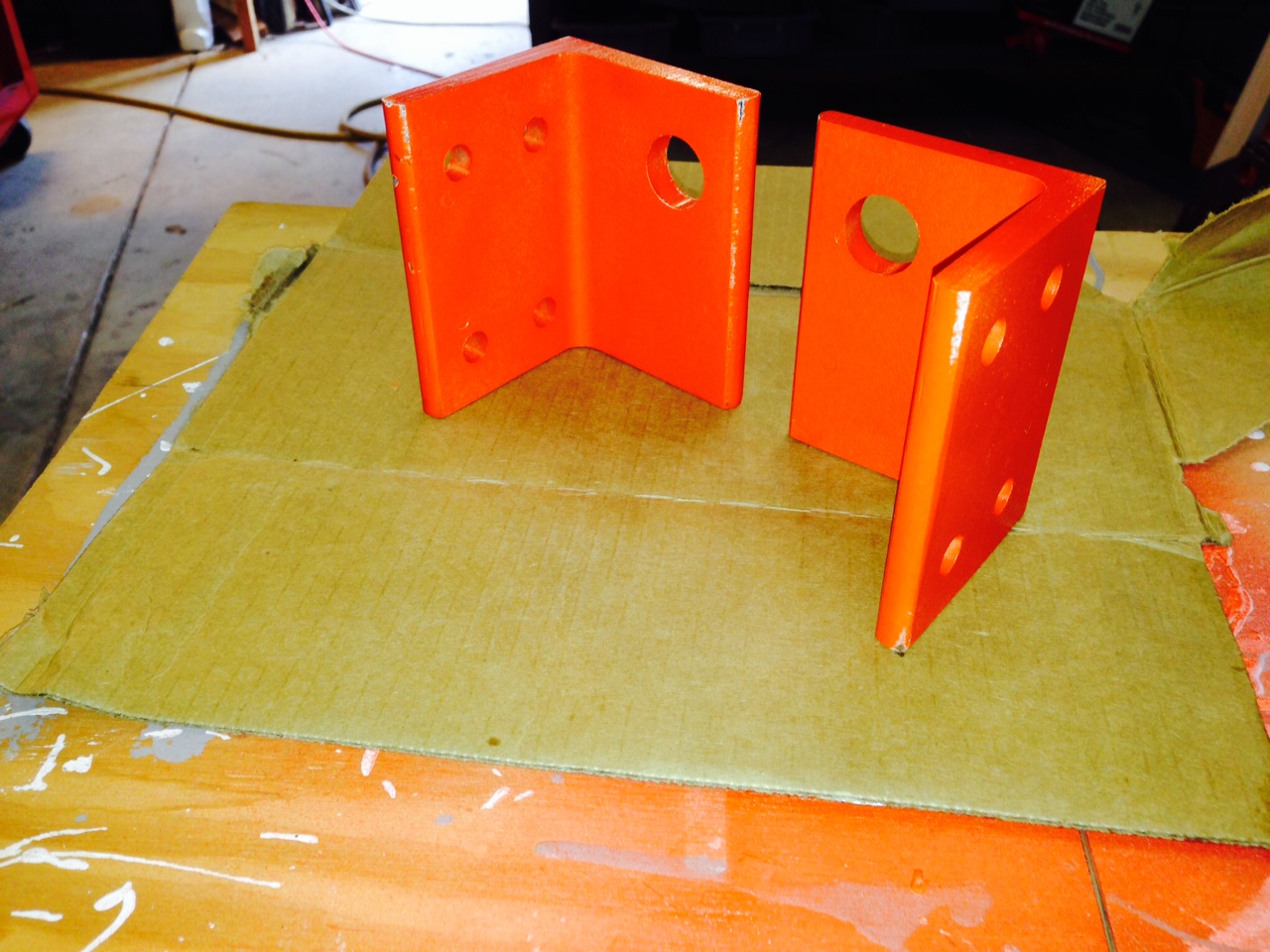

I went this route, but only recently. Wish I had done it years ago. Drilling holes is actually enjoyable now.
1" annular cutter with 1 1/2" cutting depth with shank adapter. (In my case MT 3)
3/4" Rota Cut sheet metal cutter with 3/16" cutting depth. The kit comes with arbors for hand held or drill press.
