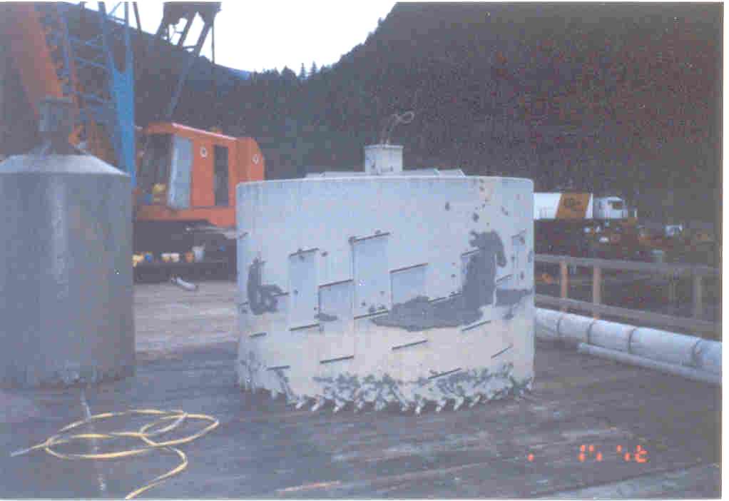

I've had pretty good luck with hole saws. Chewed through 200-feet of rock with this one. But it had a 750-HP diesel engine turning it. :laughing:
