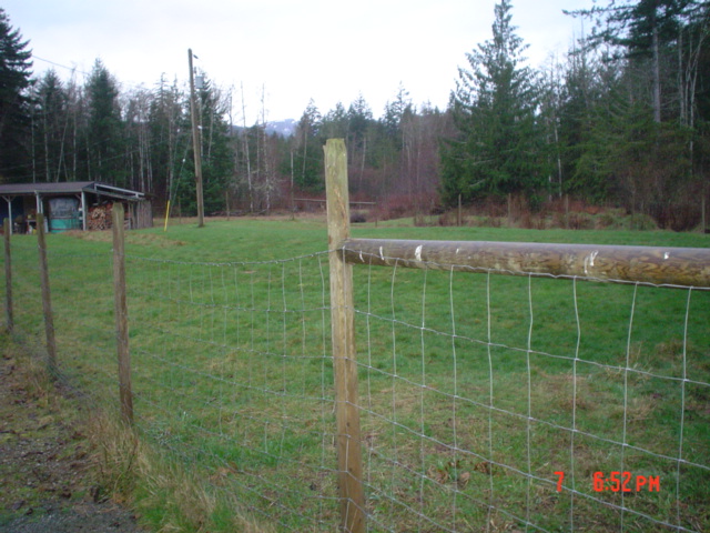

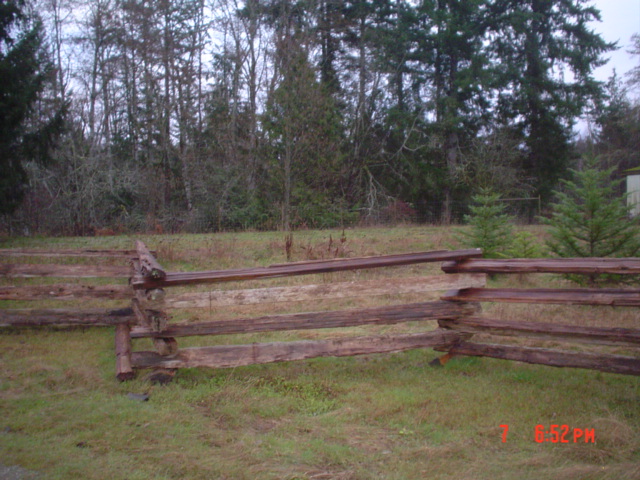

Depends on your needs. In our area most use round treated wood posts. Some will use cedar as it is somewhat common, steel posts are also used but not that common.
Our 3 fenced pastures for goats all use the round wood post, 4-5 inches by 8 ft. Our cedar snake fence is for decoration only.
