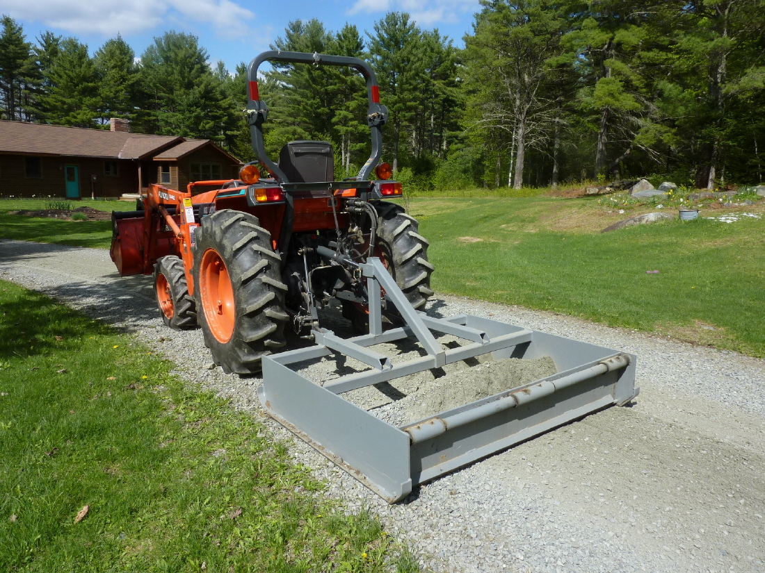

I've got 30 yrs experience using a rear blade just as LD1 said. Last summer I built a land plane that is 3' wide so I can work the tire tracks and leave the grass strip between that my wife is quite fond of. I prefer the rear blade but not doing the same work, no way to leave the middle untouched with it. I've never had a landscape rake or box blade to try.

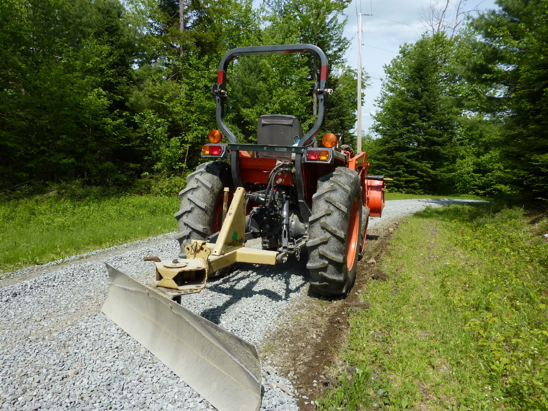

The gravel road I maintain is a mile long. I used a rear blade to maintain it for 10 years
It will do a very good job but there is a learning curve involved. I still use it when there is major work to do but the landplane I built 5 years ago has made the rear blade a seldom used tool.
Keeping the road in good shape by blading over it often greatly minimizes the traffic and water damage that occurs on seldom maintained roads. The landplane is so easy and fast to use it makes the frequent maintenance a snap.
