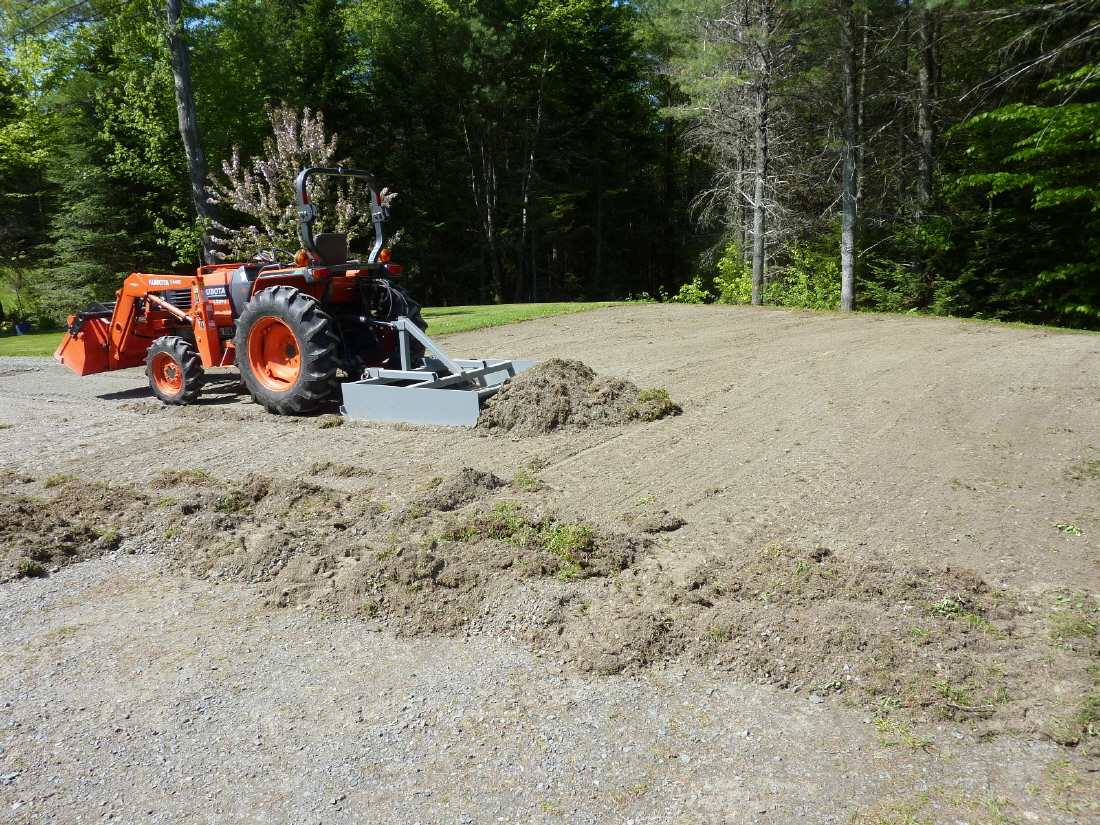

Don't have pockets full of $$$, but I could build one.
426160d1378419505t-best-gravel-driveway-maintenance-cornerlpgs-2-jpg
426163d1432418208t-best-gravel-driveway-maintenance-lowerrd1_sm-jpg
I like Gordon's pretty well & have exactly the same top surface material to work with. The grass is the center is not really desirable here as it creates a ridge that makes winter plowing difficult.

That is fine with me. You are welcome to come over and grade my driveway. Hopefully it will stop raining some day.
A LPGS will cut the sod off in the center or along the road edge. Looks messy for a couple weeks lying in the road but eventually it dries up and disappears. I can collect and pile the sod with my arrangement. I don't get all the roots so it grows back but it looks good for a year.
