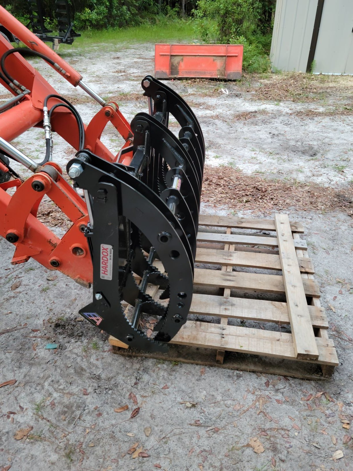

No wait, only the price jump. I found one in Valdosta GA right down the road from my Hunt Camp. I was able to look at three other brands (also equally price jumped), and the EA was the clear winner regarding the construction. So, I broke the bank and jumped on it. $2900 + GA tax, FUGLY!!!
I also noticed this L48 TLB has two brush guards/screens attached to the main brush guard. One if fine the other is course. It might be SOP for the TLB series as the dealer had an older B TLB and it also had the same two-screen configuration. So that item is well covered.
I am using one of the two rear aux units to drive the grapple versus installing a 3rd function. I got the hoses made and fittings made already. We shall see how this goes. If it is a PITA, I will add the third function.
As always, I appreciate all the wisdom and experience that was shared on this thread.

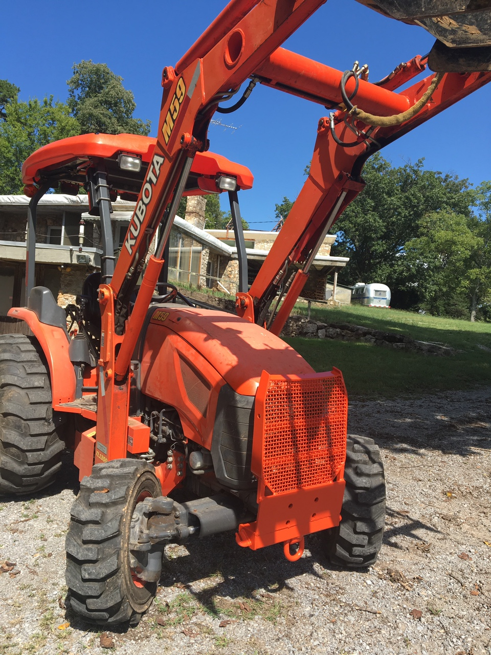

I have the same model/year TLB, but I added expanded metal to the front of the brush guard.
Those two OEM screens you mention, on my tractor, are well behind the brush guard, and are not beefy enough in my opinion to provide meaningful radiator protection, and they provide zero hood protection..

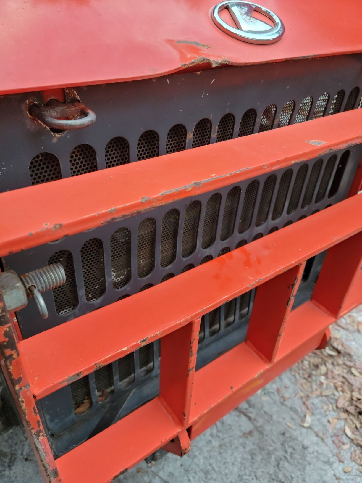

As always, good advice. I imagine the expanded metal to the front is all custom, or do they sell something?
   / Best grapple for an L48? #25
That is the same front look that my L48 had several months ago.
I took Oosik's grill/hood protection advice, and removed the very beefy front bumper frame, took it to a welder, and had 9GA. expanded metal welded on.
They did a nice neat job ($100), and I will paint it soon, since weather has finally warmed.
I see from the photo that your L48 has already suffered some hood damage by not having more protection.

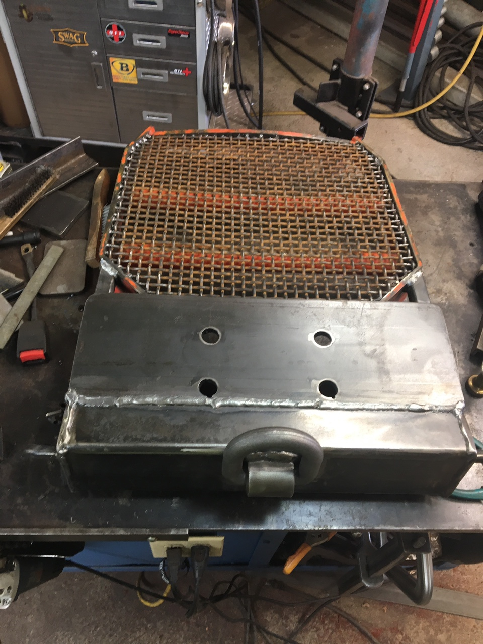

I will build in more protection for the grill for sure.
What about the bumper suggestion, can someone post a pic?
   / Best grapple for an L48? #28
I have never been able to do the TBN picture posting thing.
My expanded metal looks very nice.
Just a piece of flat 9GA. expanded steel cut to fit, and welded at each point where it touches the OEM nose guard frame.
   / Best grapple for an L48? #29
Bumper 3x6” tubing and 7x1/2” plate. Metal I had. Pushing over trees and stacking brush makes the lower part susceptible to damage. Gives protection to front axle from stumps and rocks. Added tie down hooks and ring for trailering. Added about 100# to the front bumper.
Also decreases the amount of debris buildup on radiator screens when bush hogging.
