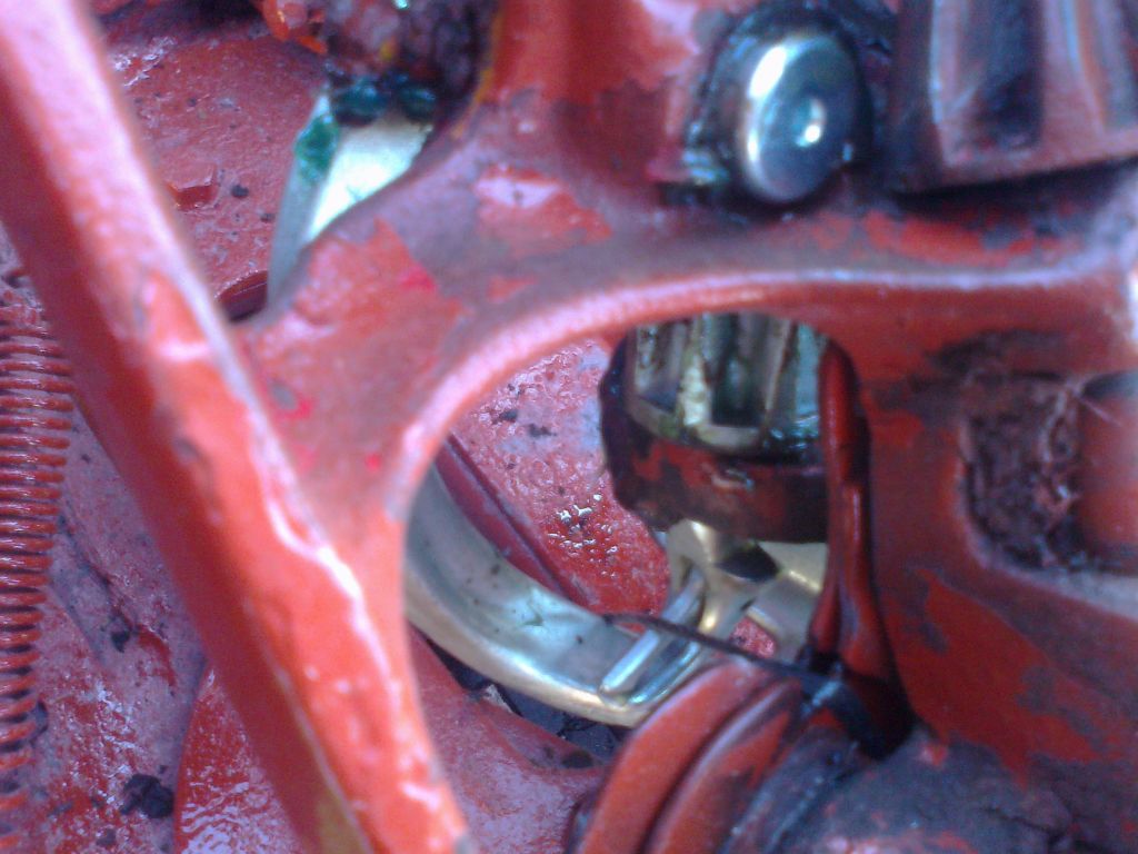

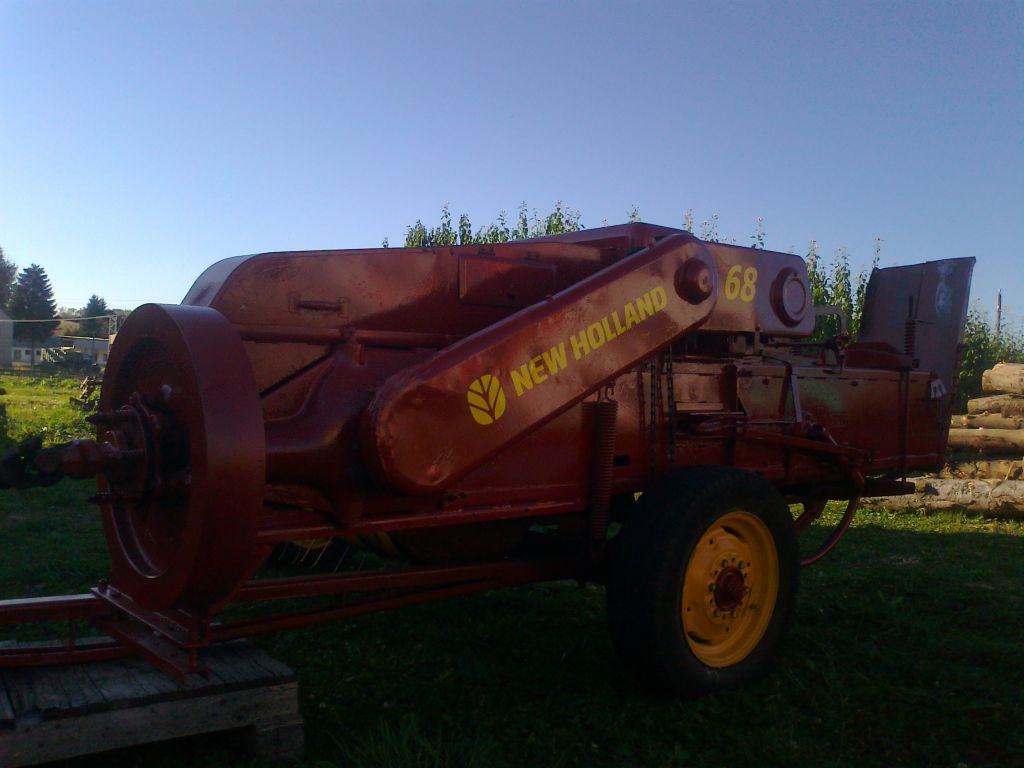

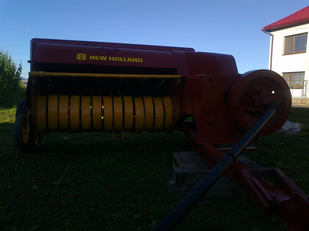

Hi, I'm new here on the forum. I live in Slovakia in Europe. I do not know English very well, so I'm sorry. This year in August, virtually in the season I bought a New Holland 68 baler. He was in very bad condition. Was not timed. Knotters did not work. I got to him he made before I put it together. Previous owner presses really understand. Bill Hook. was the sisal twine and he used plastic twine. At a press spring hay missing dog. Knife frame was completely bent. Knotters I rebuilt the plastic twine. I used parts rasspe. Press has a new clutch plates. I still need to make wooden gliders on the plunger and set it in the compression chamber. I need to deal with the placement of the fingers cross inserter. What is the distance from the first finger gripping the pin? It was set incorrectly, because the press did Packages C. I set it by eye. Now press works great and already I am looking forward to next season. Here you have some photos after the correction press.
