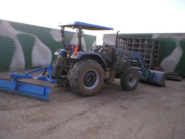

Charles, is your blade for your 3030, or the 59? I could see a possible problem if it is a small setup. Remember that weight is your friend when working with these things. I love my Land Pride rear blade, day & night difference from my MidWest rear blade. But then so was the price.:(
