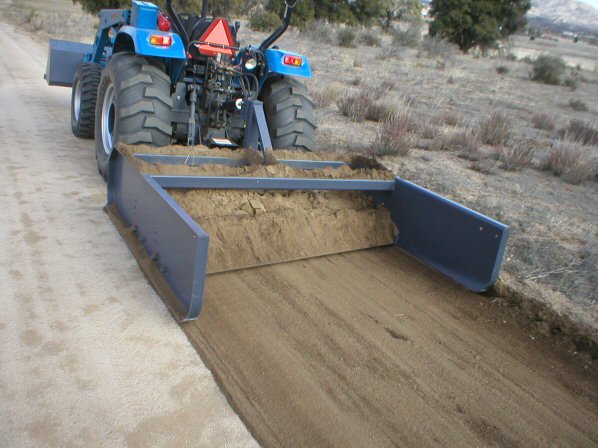

   / Best implement for road grading, for a 40HP CUT, regardless of cost? #18

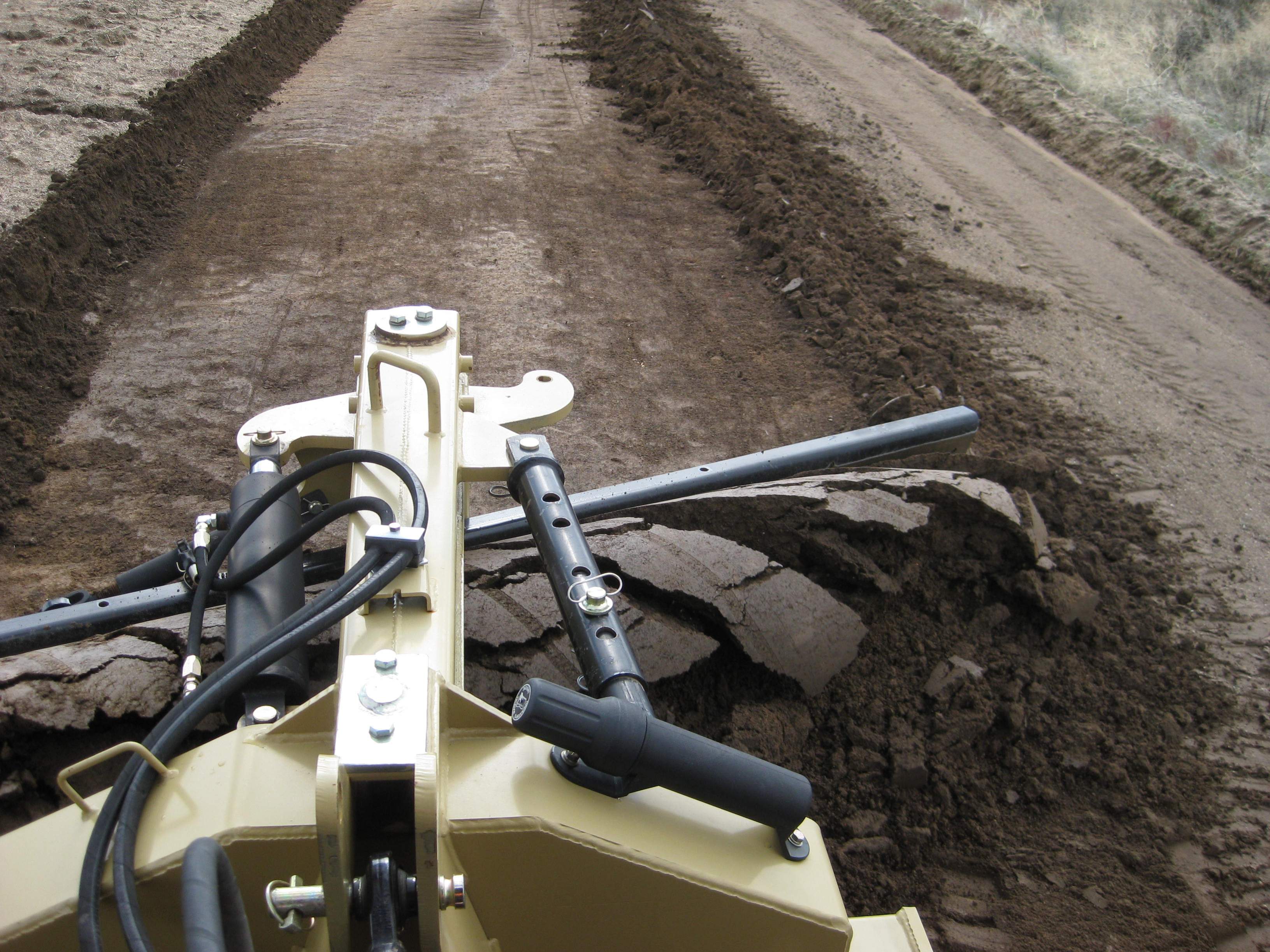

Chances are real good this type of machine would even allow for making a Ditch.:thumbsup:

This would be my advise also - Rear Blade and Landplain/grader.
#20
Woe, now we're talkin'! What is that? Who makes it? How much is it? That looks to be perfect.
