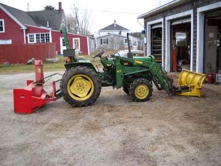

Within the next few months, I'll be moving out to our new place and taking over 450 feet of flat gravel driveway. I currently own a JD 3320 that I'm sure is up to the task. I'm trying to decide now which snow implement would be best.
I talk to my dealer and he basically gave me three options...
The first is a front mount snow blower. I cringed when he told me the price was about $5500. I could go with a rear blower for less...
The second option is a front blade at about $2000.
The third option is a back blade at about $500 or so.
The thing I hate about a blower or front blade is that it seems their only good for moving snow. I'm thinking I could use a rear blade for other things as well.
What do you use and/or recommend?
Thanks!

Front blower AND a rear blade. The only way it could get better is with a warm cab.

450 feet of flat driveway isnt too bad to handle with a rear blade as long as the accumulations arn't generally too much. you have any idea what your average snowfall are? I gave up on rear blade cause i had too much snowfall. went with a rear mount on my old JD870 and used it for 14 years. worked great, but very hard on my neck. i have about 1500 feet of driveway to deal with plus removal of shedding snow on my buildings. My new loader mount blower works great, but i also needed a plow for the early and or wet snow conditions that the blower doesnt work on. My blower was ridiculously expensive, but my health was more important.

Like many other things, the most expensive item the dealer told you about is the best! It is just a matter of what you want to spend. I plowed for years with a blade on a garden tractor. It was what I had, so I made it work.
Now I use a FEL and a back blade. I won't spend the money for a front blade-the FEL was not much more $$ and it is usable for so many other tasks. The back blade is another implement that has other uses besides plowing snow. I have thought about a 3pt hitch blower, not as nice as a front mount but it would fit on any tractor I will have for the rest of my life!!

I just went through the same thing. I wanted ONE thing for snow removal and I decide on the FEL mounted plow. I got it used on craigslist with the hydraulics and lines to run it 6 way. For me I have a 300' driveway and half is stone. The blower is expensive and I don't think works great for those pesky 4-6" slushy storms. Plus they take way longer to put bucket back on if needed for digging cars or neighbors out. Also I don't want any more moving parts to deal with during a major storm like we had last couple years. The rear blade seems popular up to 8" snow otherwise you have to push it in reverse. In my case I would have to take backhoe off and I would probably then need weights and chains which would negate the savings for me. Also I have box blade so I wouldn't get additional use out of a rear blade.
