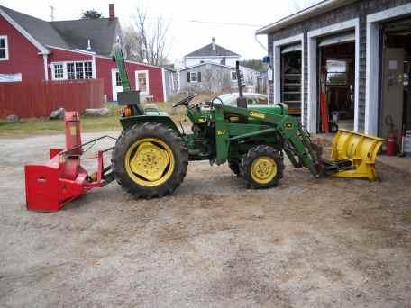

If you need to clear the road more than 2-3 times a week then having something of the front is really going to save your back/neck. A front blade could be mounted on the FEL bucket attachment and be fairly inexpensive and be good for upto 8-10" of snow depending on how wet it is. A rear blade will work the same but be really cheap purchase. You can clear deeper snow with a plow but it gets much more difficult. Dealer may try to sell you a plow that doesn't use the FEL mount but instead uses a bracket kit that goes on the front of your tractor that it mounts to. They are usually more expensive.
A snow blower isn't really effective(as compared to a plow) until you get 6"+ of snow. A rear snow blower is a good option if you only get a few deep storms a year or have a problem area or two that drift in. Snow blowing is much slower than plowing. A rear blower, used, can be as cheap as $500 and is good insurance for those occasional storms. If you get lots of heavy snow then a front mount blower is a good idea.
My plan is to use a rear blade and rear snow blower. We all drive 4wds to the road doesn't need plowing everytime it snows and the Chinooks melt it off in a week or so anyway so we don't get big accumulations building up. The snow blower will take care of the 3-4 big dumps we get a year.

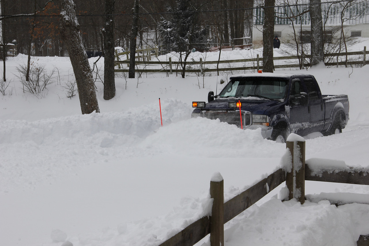

I got a front blower because when I remove it I want it gone. I have a plow truck and usually by mid Feb the banks start getting big. With the blower it's gone deep into the woods. For 450ft I would think about a 3 pt blower for about 1/3 the cost of a front. But it really does depend on how much snow you get and how much snow you get during a major dumping.

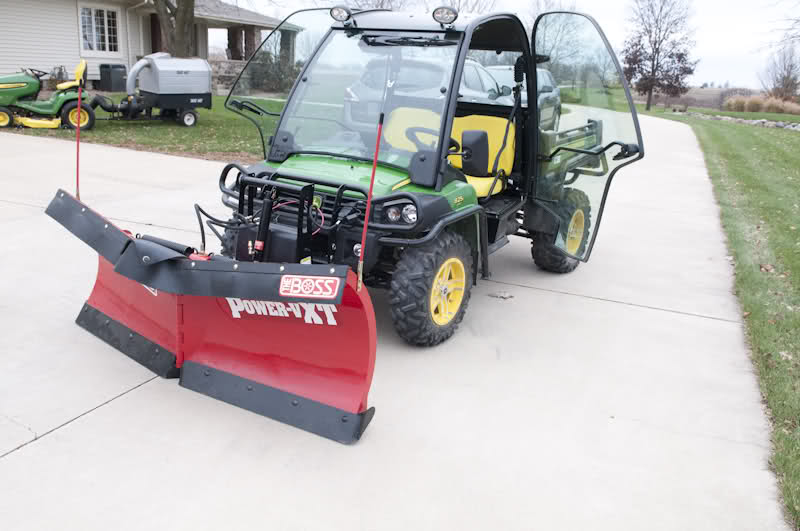

BTW, this year I'll be using a UTV mounted plow and let the tractor take a break...
