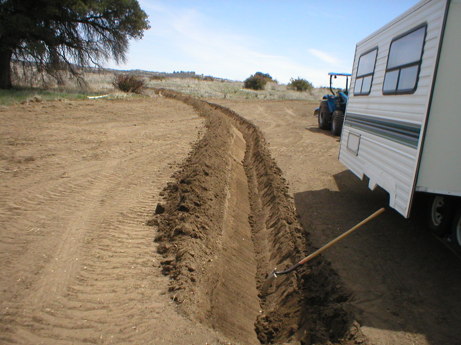

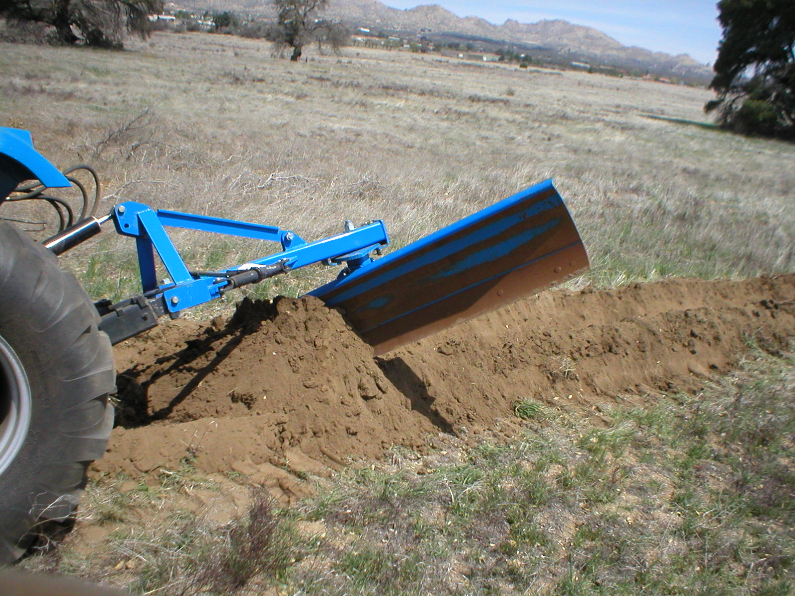

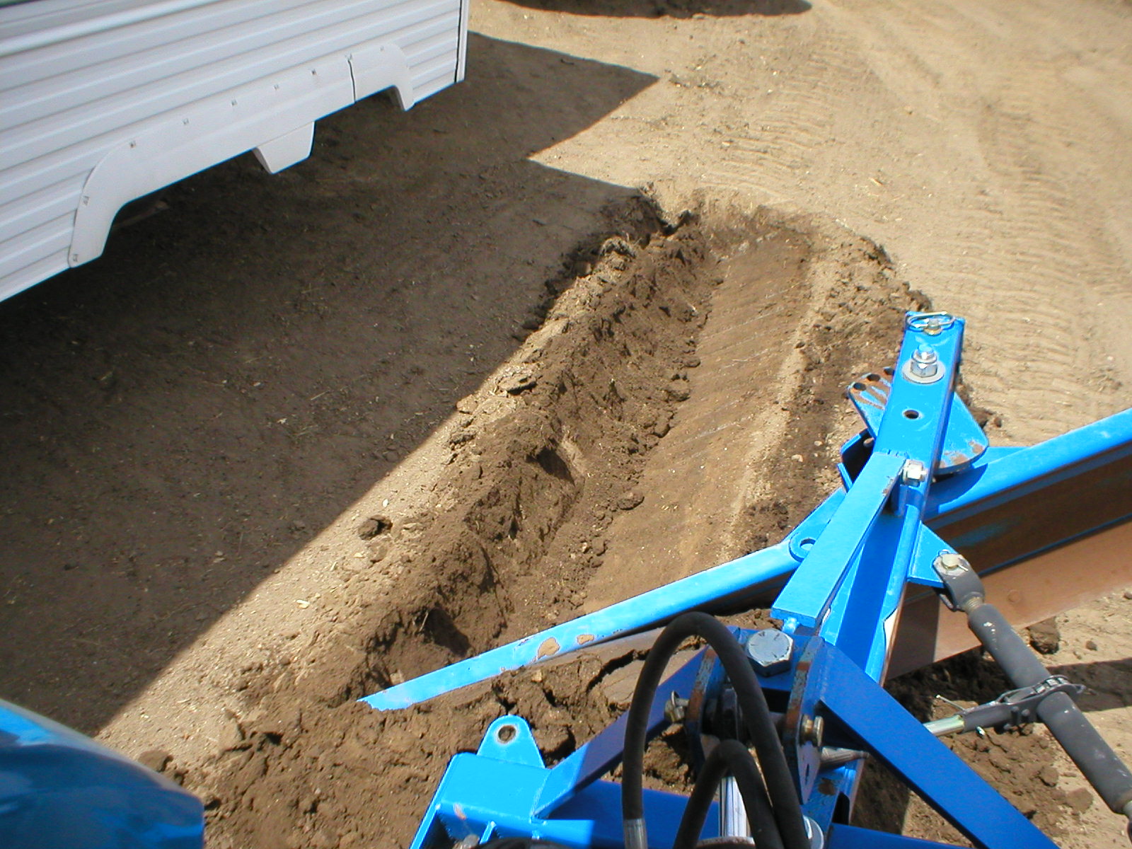

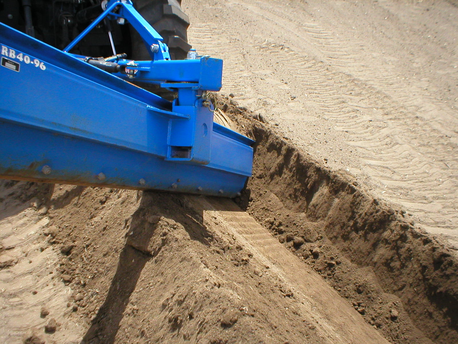

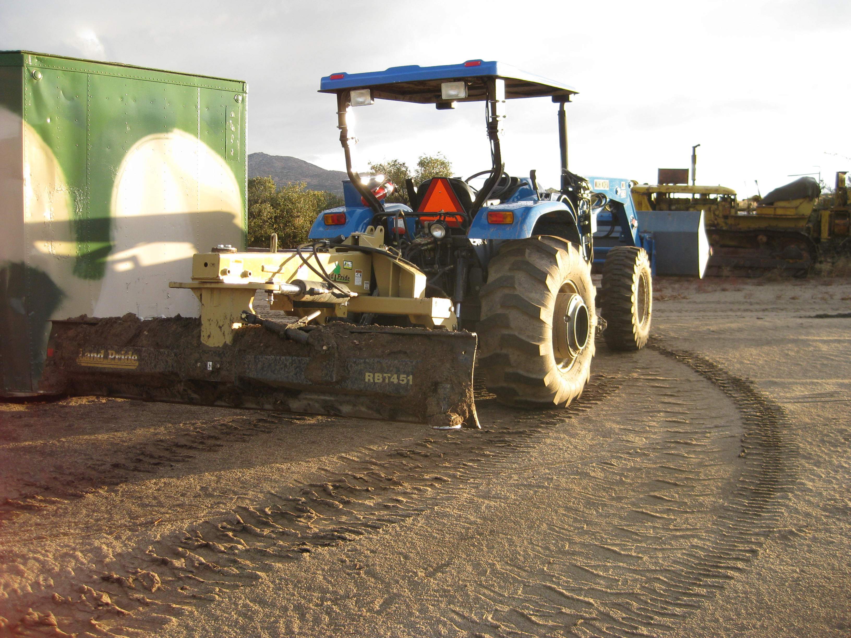

Do you have to remove the material that you remove from the ditch from the site, or can you redistribute it over the road? If you can just smooth it out back on the road, then a rear blade that has tilt capabilities is what you need to buy. I say buy, because you need to stay on top of this and not let it go anymore. No aux hydraulics needed, just the right blade. I would say this one for your CK25. With the right size equipment, (much bigger than what you have)your job would take maybe on the outside 2 hours to complete, probably less. :thumbsup:
The ditch in the picture is about the size that you say you have to clean out. If you have to haul the spoils away, that is where most of your time will be spent, but even with doing that, the offset able, tilting rear blade is the implement that you need to have to be able to easily stay on top of this.
Just my :2cents: and how I would deal with the situation. ;)
