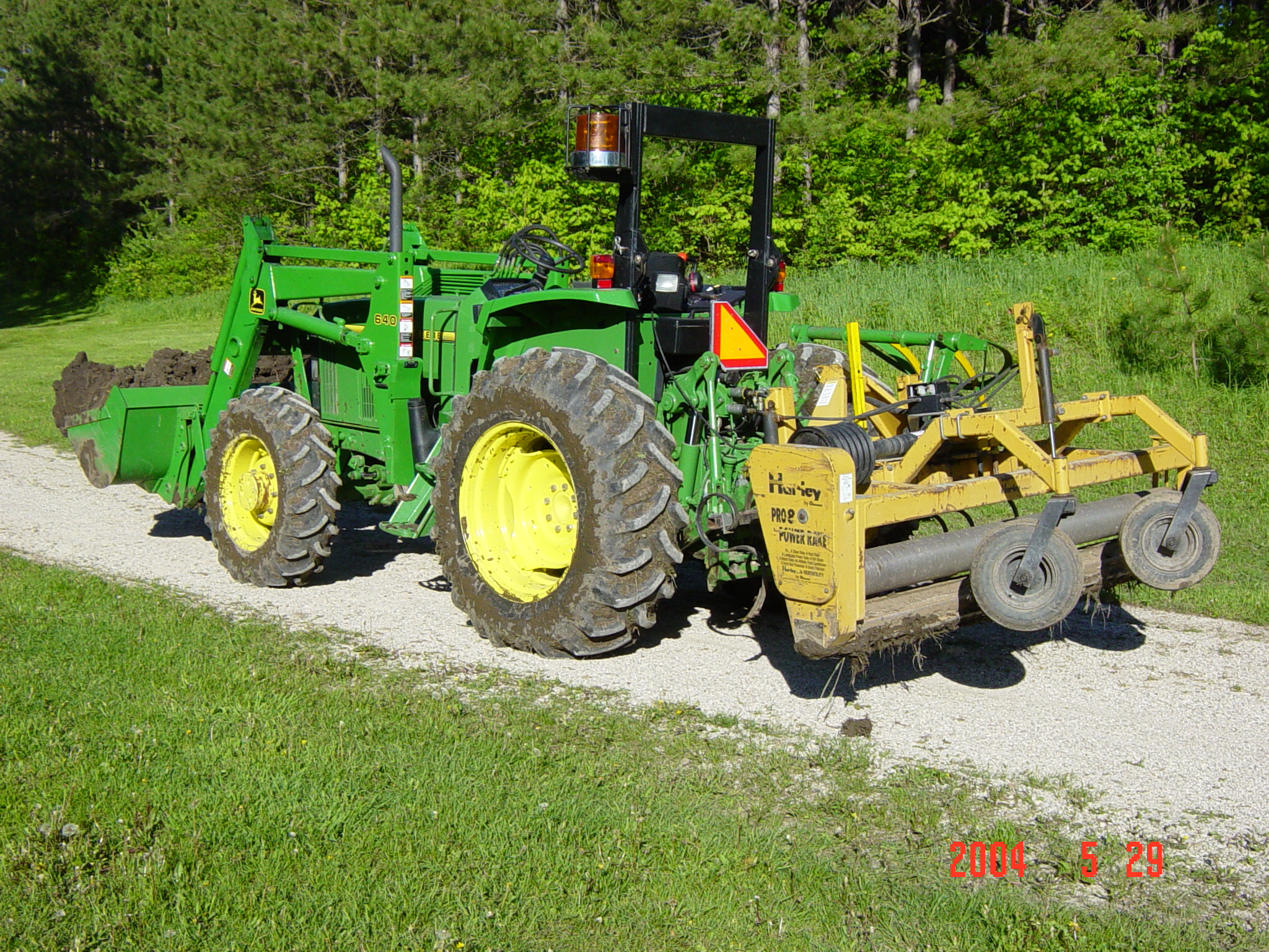

I have both, and the answer is yes and no. The rake leaves a finer finish, and also can angle so it pushes the rocks and debris to the side. A tiller just mulches it all up and lays it back down and is usually meant for deaper work.
I used my tiller and the York rake many times before I bought the Harley Rake. It can be done, but the HR makes it quicker. Even after the HR, I still go over it with the York rake just to smooth it out. After I plant the seed, I run the York rake backwards, and it covers up the seed pretty well.

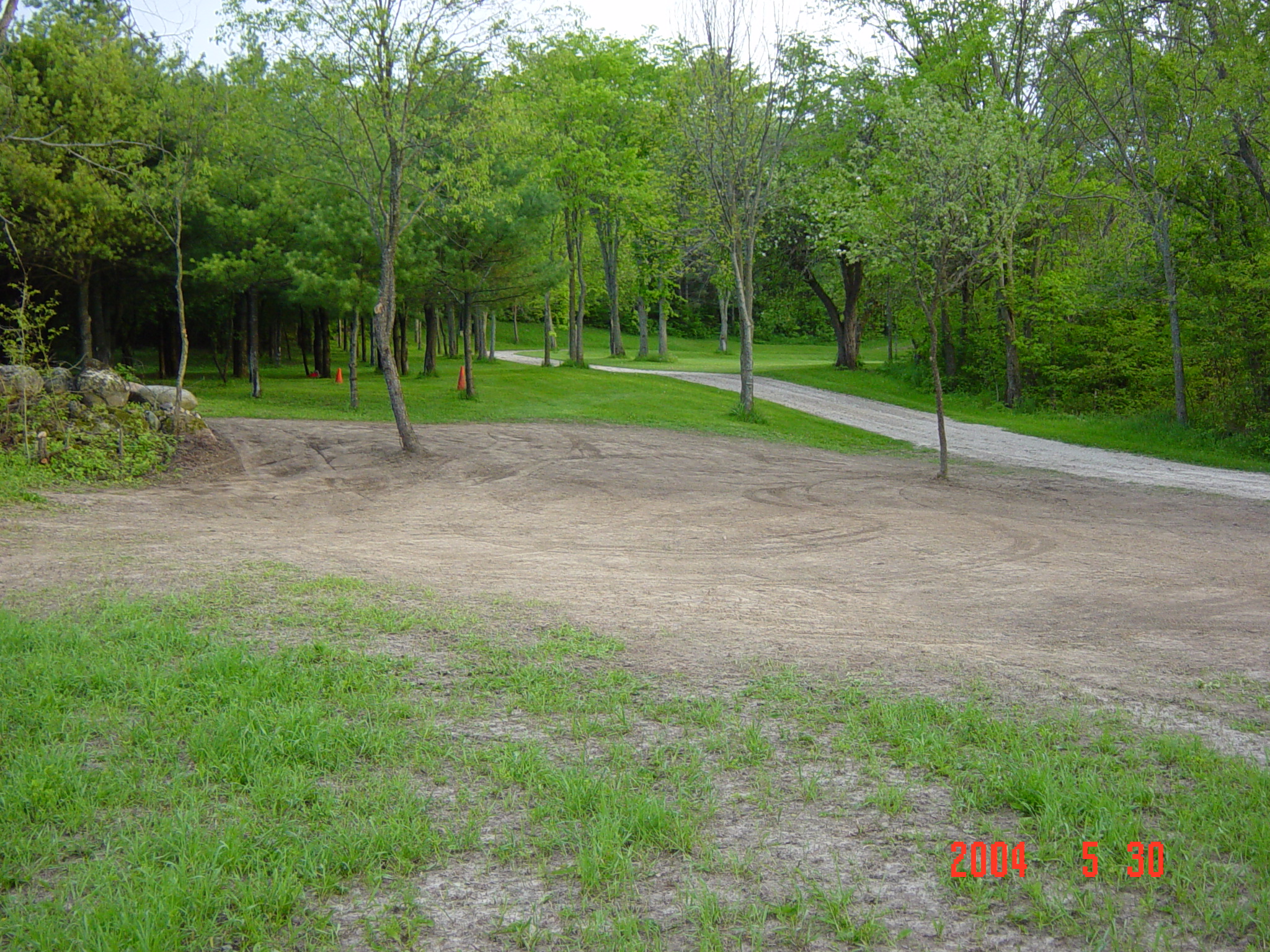

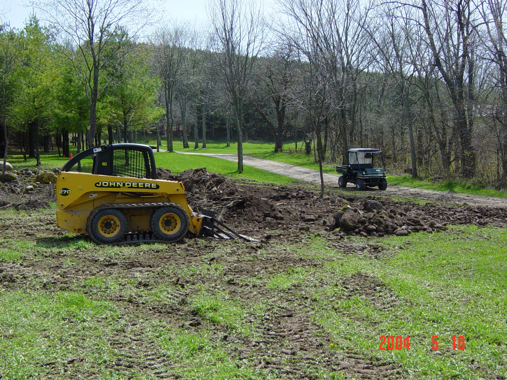

A rock rake will windrow rocks and seperate material.
A rototiller won't help you get from this:
To This:
The Harley Rake certainly will

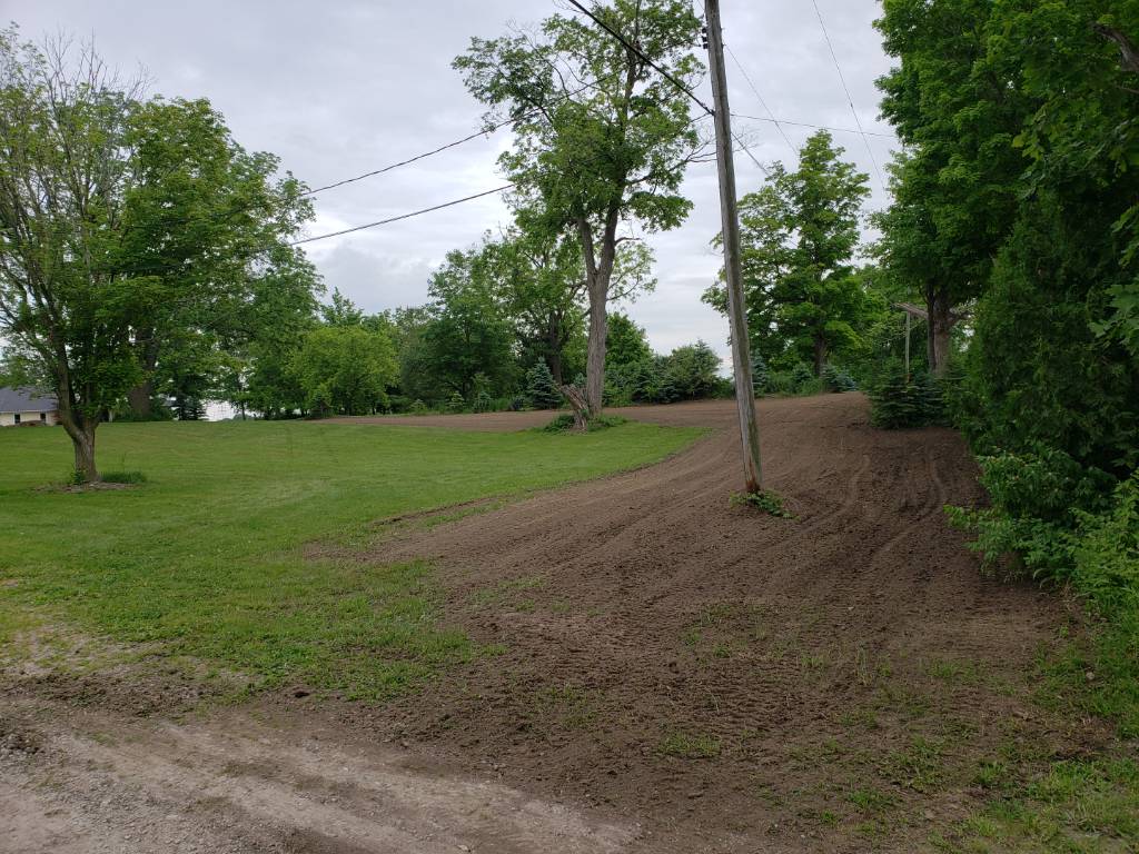

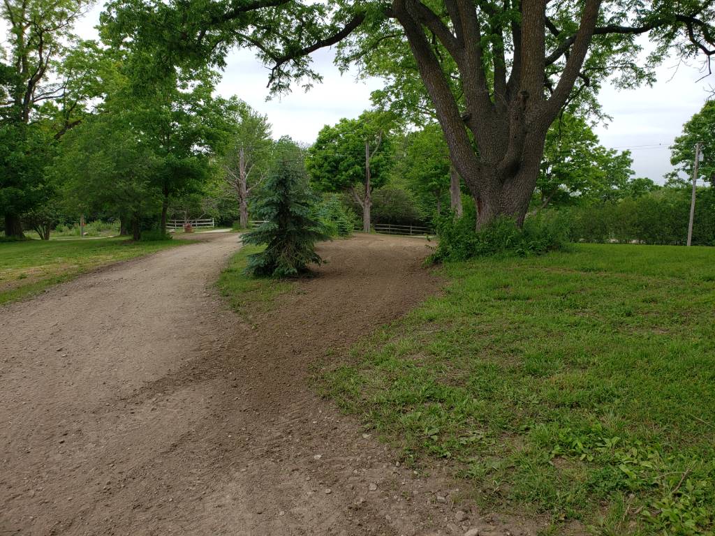

Did this yesterday with a harley take. 20190609_180245.jpeg20190609_180551.jpeg
