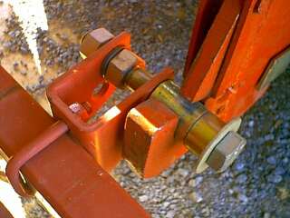

I also have a TSC(Speeco) quick hitch and agree that it well
worth the trouble. I had to get a PTO extension ($6.00)
because one of my driveshafts was a little short. The only
implement I had trouble with was the LMC (Sovema) tiller.
The hooks would just not go in and it was tedious to back up
to the little slots. I just used a couple of 7/8 bolts and some
bushings to make an adapter. See the attachec photo.

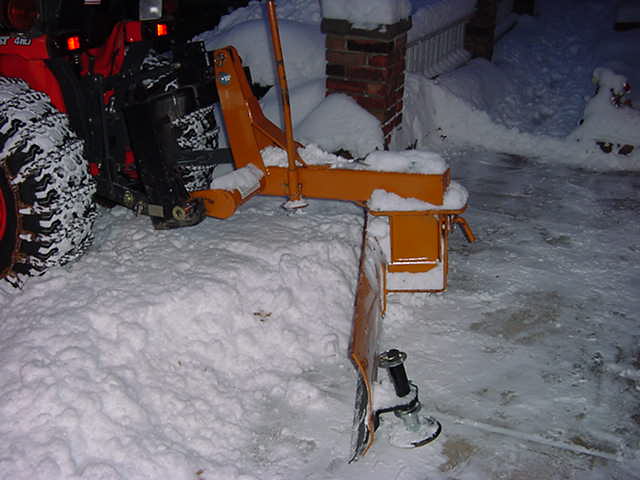

This is what the hitch looks like in action. We had 4-6 inches of snow here in northeast Ohio with a good deal of drifting.

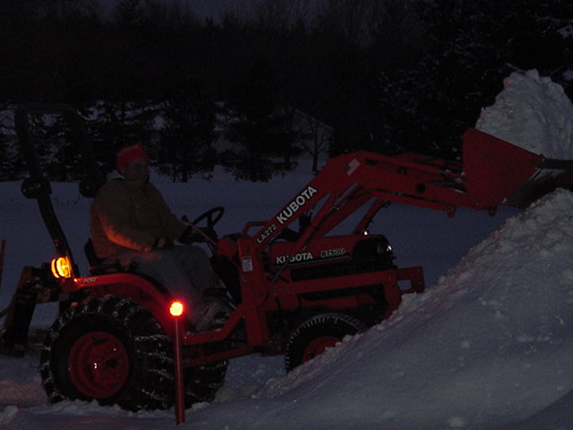

With all the snow I had to start stacking it at the end of the driveway.

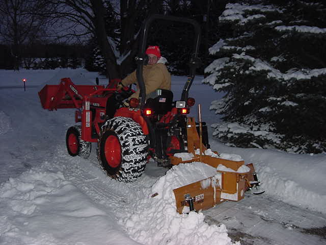

Here's another shot of the hitch in use and on the run
