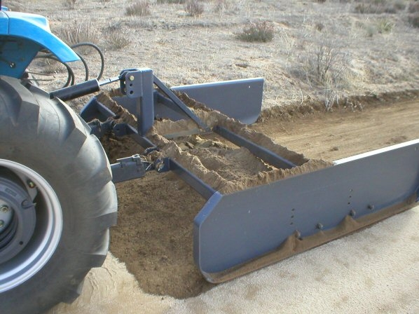

My LPGS is 7' wide between sides, 8' long and 22" tall. The tractor without a 3pt implement is over 12,000lbs.
You can see that material has been over the two support bars. This is with the material being with an ideal moisture content. When it has been wetter or with grass mixed in, it has without a tail gate pulled the implement full of material.
For me, this has worked very well at evening out (moving high areas into lower areas) acreage up to about 5 acres in size. As has been previously mentioned by sandman2234, the LPGS moves more material than a box blade (my BB happens to be rated at 1 CY) without a tailgate.
So yes, 4 CY with a tailgate and the LPGS is by far more than a one-trick pony implement. ;)
