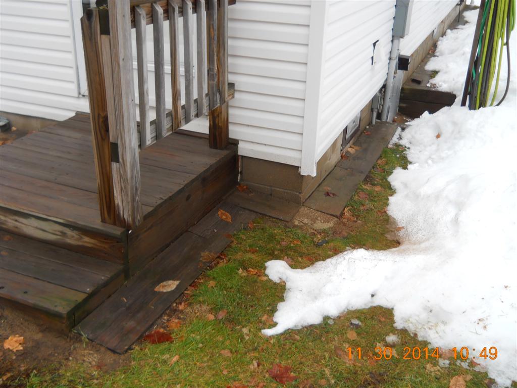

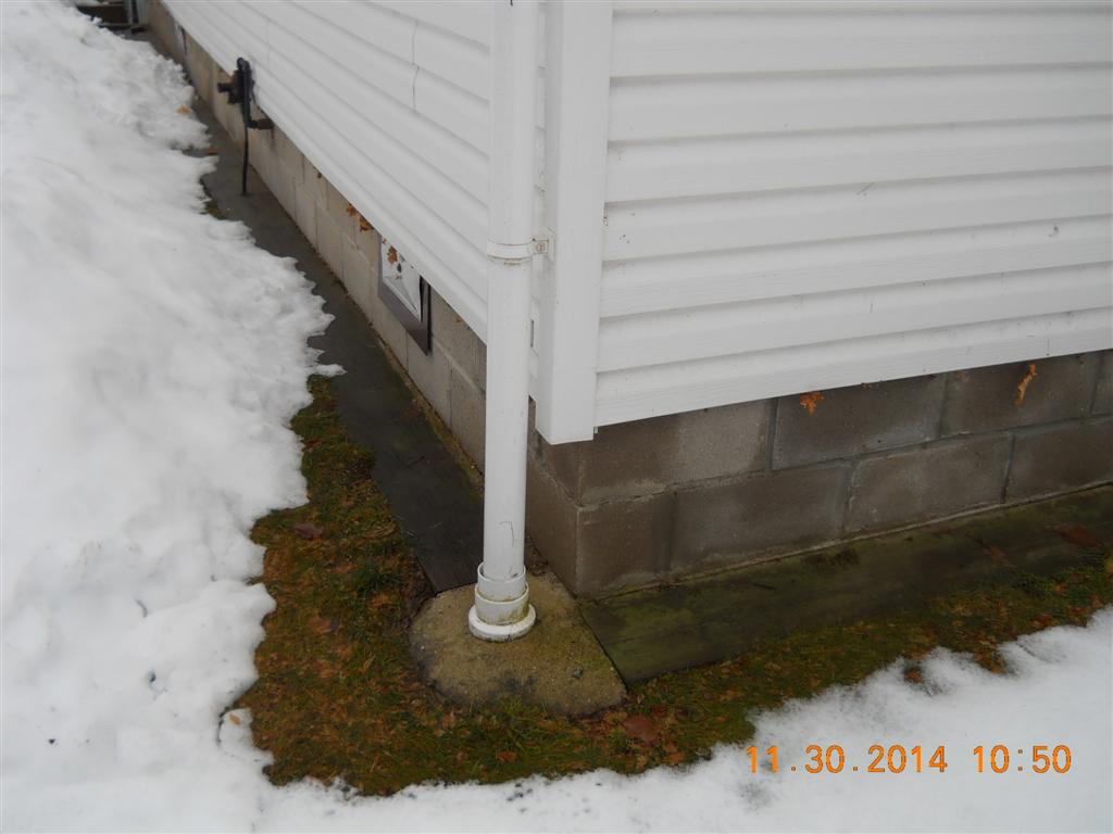

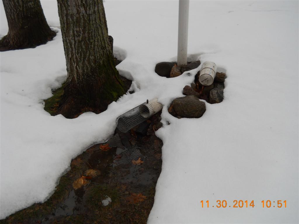

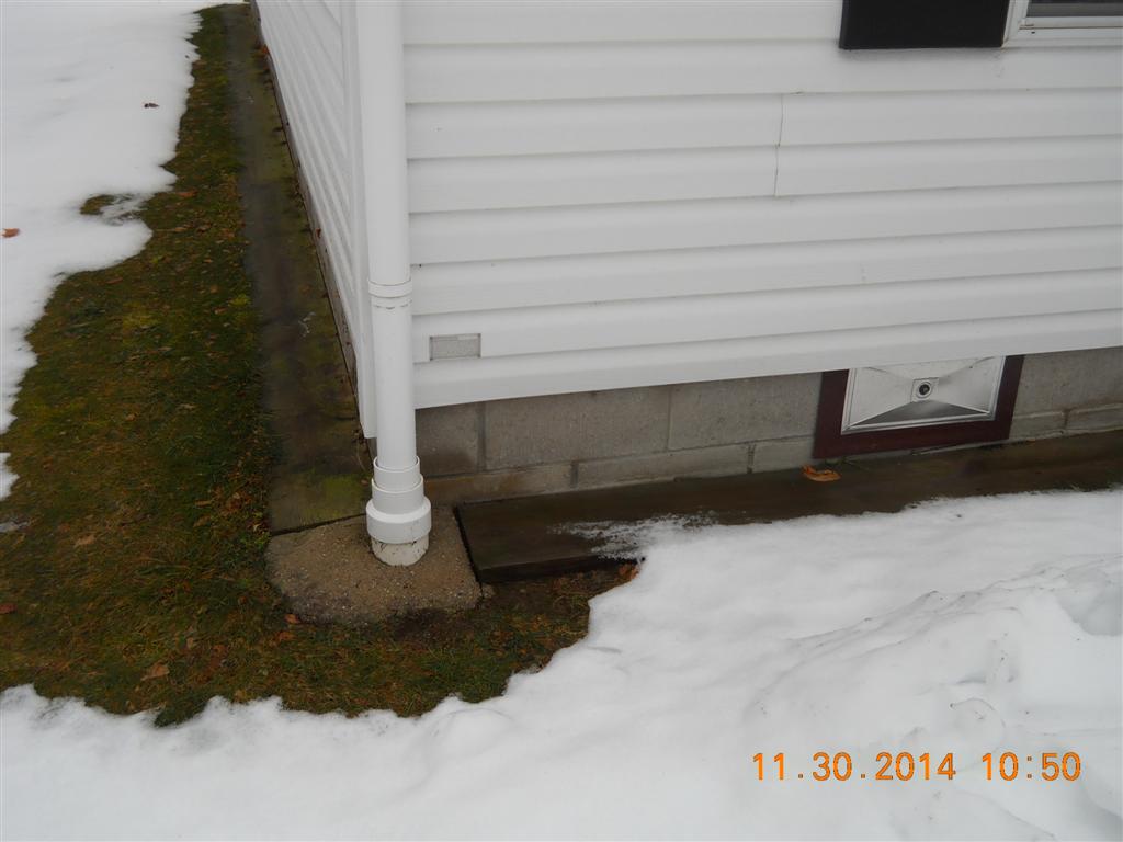

My old house, I poured 8-10" ish wide blocks of cement around the perimeter a couple inches thick [ over several year period ]. In blocks so I could move them if I wanted. My new house, I surrounded the house with treated 2x12's... with cement on the corners. Had a couple that I had to replace in the last ten years because of wild warping... but the rest are doing great. Everything is held together with treated screws so I can remove each if I need to. I also pour a couple inch thick cement pads around the well, address sign post, etc. to help with mowing. Very little push mower trimming on my acreage.....
When I pushed the dirt back around my foundation they told me it had to be ' at least 1" drop in ten feet ' minimum. If you put stone or mulch around the foundation, you are making a place that would help the water go down next to your foundation, which you don't want. You should strive to divert all water out that 10', including gutter downspouts. More slope is better than less slope, but remember that you might want to use step ladders around the perimeter some day..... :)
I miss remembered...... the min spec years ago was more like 4"/10' min.. so you 1"/1' is not too bad...

My final grade was probably more like 1" in three feet or so.... not saying this is great... but works for me... Drill a couple big holes in the end of the planks before you hand trowel in the cement corners. Holds the wood in place....
