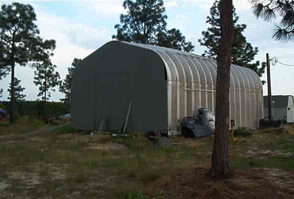

I am in the process of finishing a 25 x 32 x 16 Pioneer Building:
Cons:
Not as easy to install as advertised
Harder to Insulate
Pros:
Lots of room for my future lift
No rot
NO LEAKS
