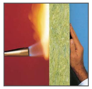

Im going to use Roxul mineral wool insulation in my shop building and house. It really is fire proof, not make believe fire proof like the other stuff, wont absorb water, the water just runs off it, bugs and mice arent fond of eating it since its made from basalt rock and steel slag.
You can get it in unfaced batts that are quite stiff that are pre cut to fit in stud wall openings or they also have it in 4x8 sheet boards .
It costs more than fiberglass but less than foam. Seems to me all the other choices cant compare to how good this rock wool is. Im doing the shop first then next spring - summer a house.

That's a good product with specific uses, sound proofing and fire rating for passing code. Only two kinds of that roxul have decent thermal ratings, 15 and 13 R-value for a 3.5" stud cavity wall and also its not "fire-proof". It has a 1 hour burn time that is good for a garage interior wall/ceiling for example. They make a special fire version that has a 2 hour burn time. Fire will burn it up, just gives you time to get out before it burns through.
   / best materials to insulate metal pole building #20
Yeah and it will also soak up water if it gets enough on it.
