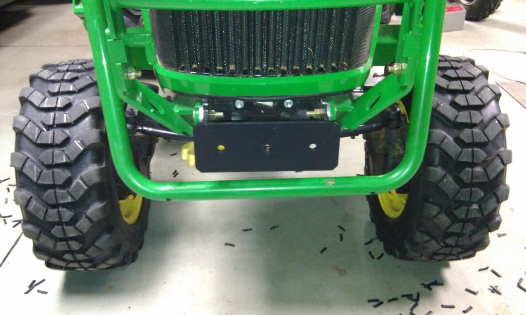

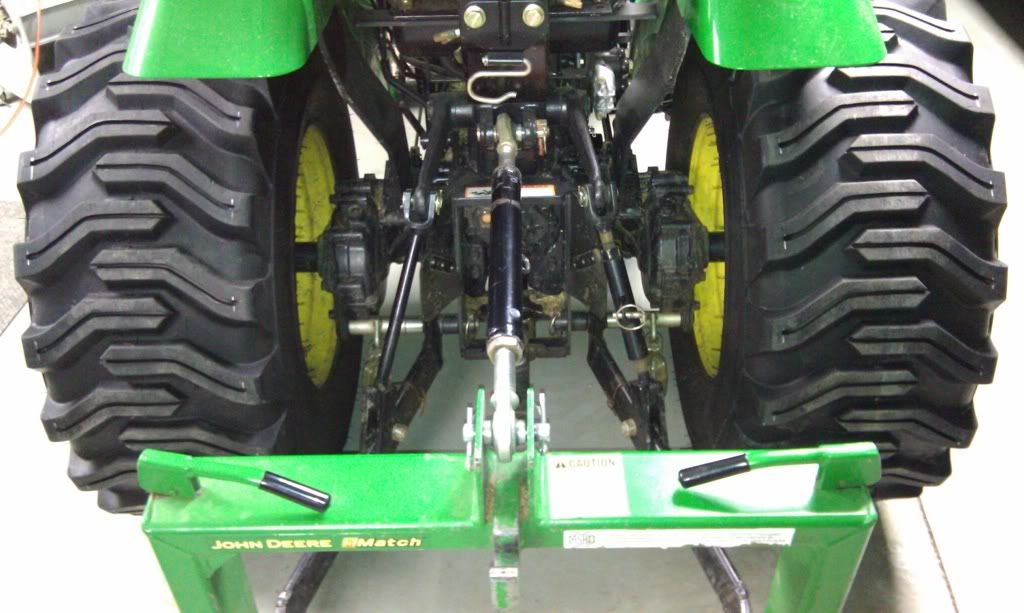

Loader mounted quick hitch.

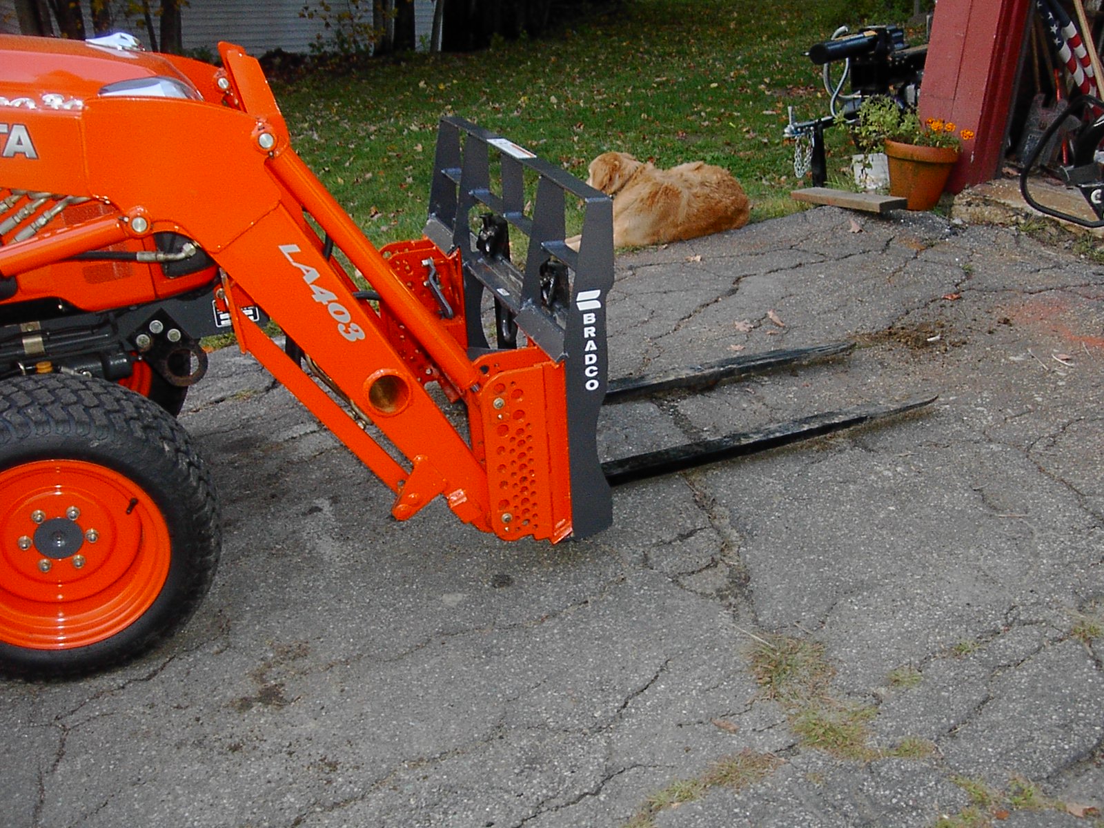

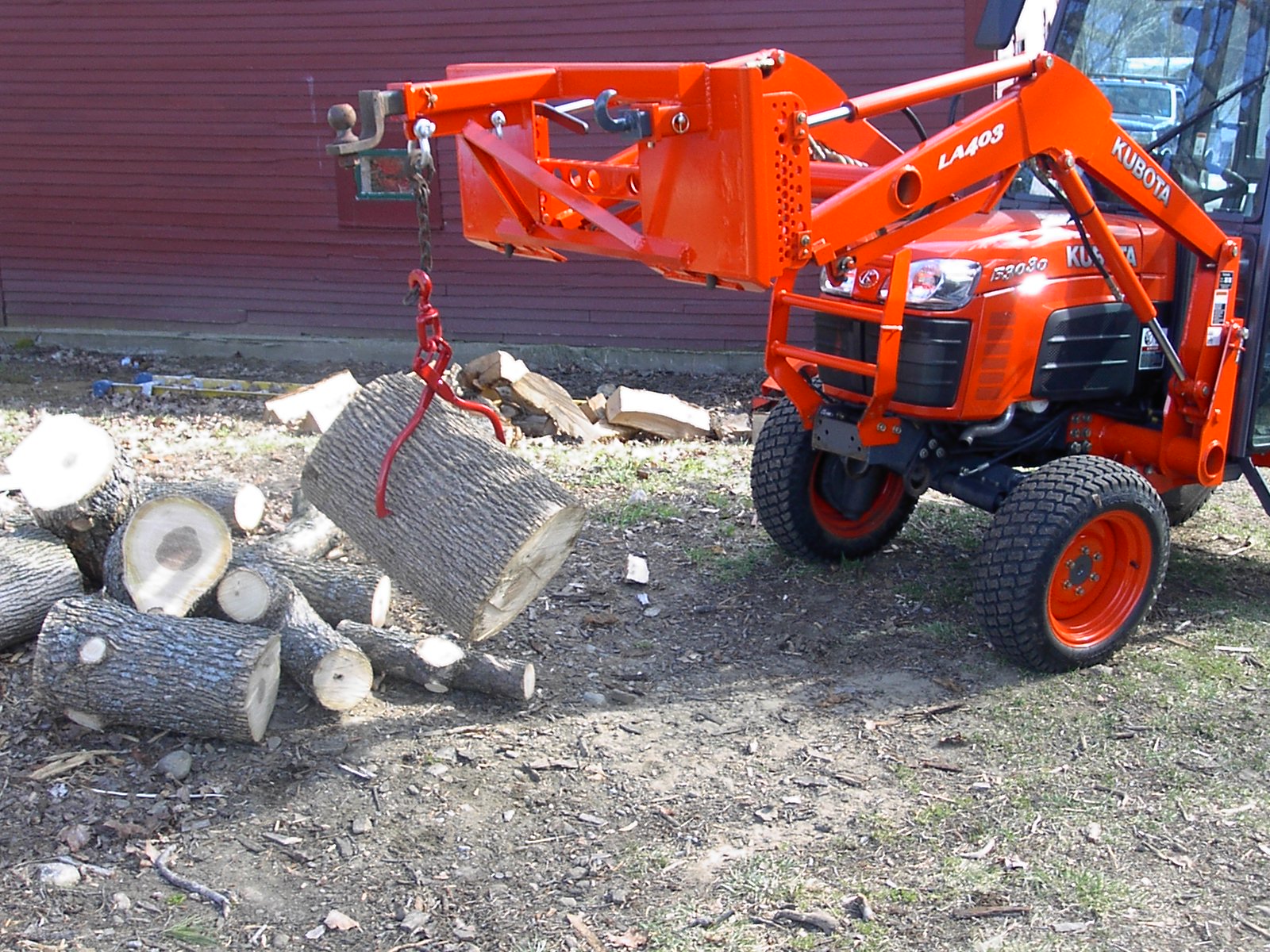

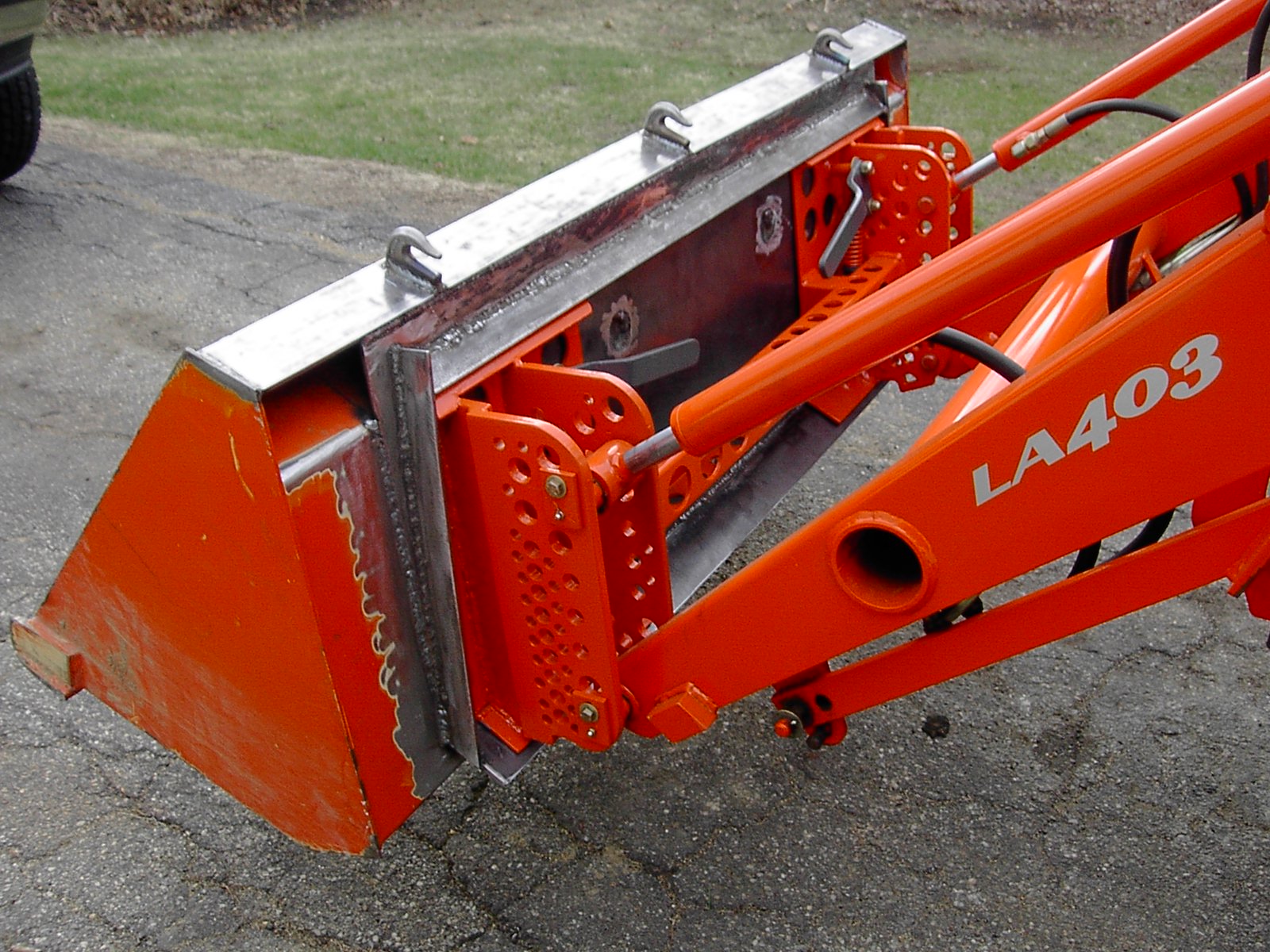

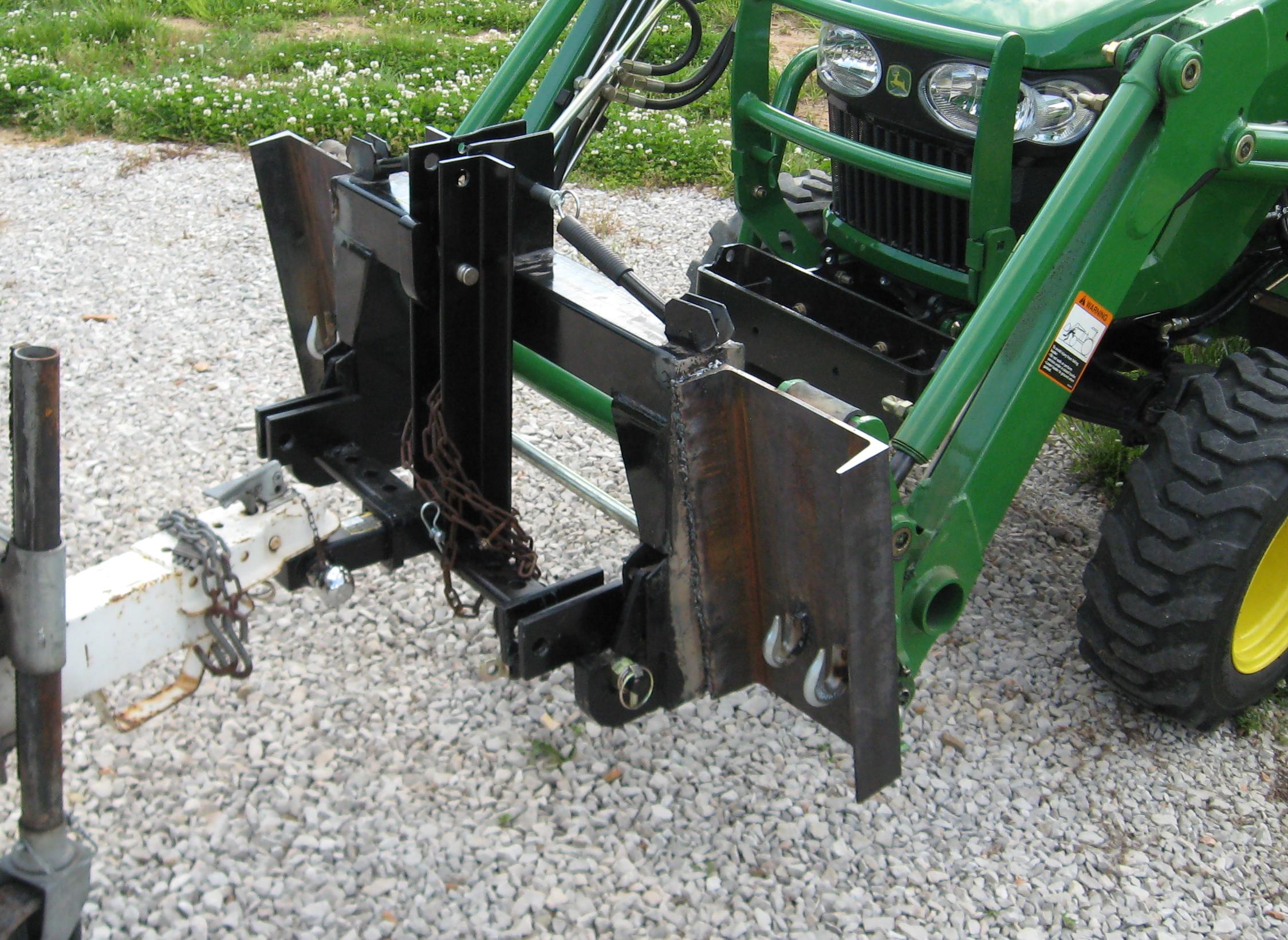

Single best mod I made was converting to skidsteer style quick attach.
