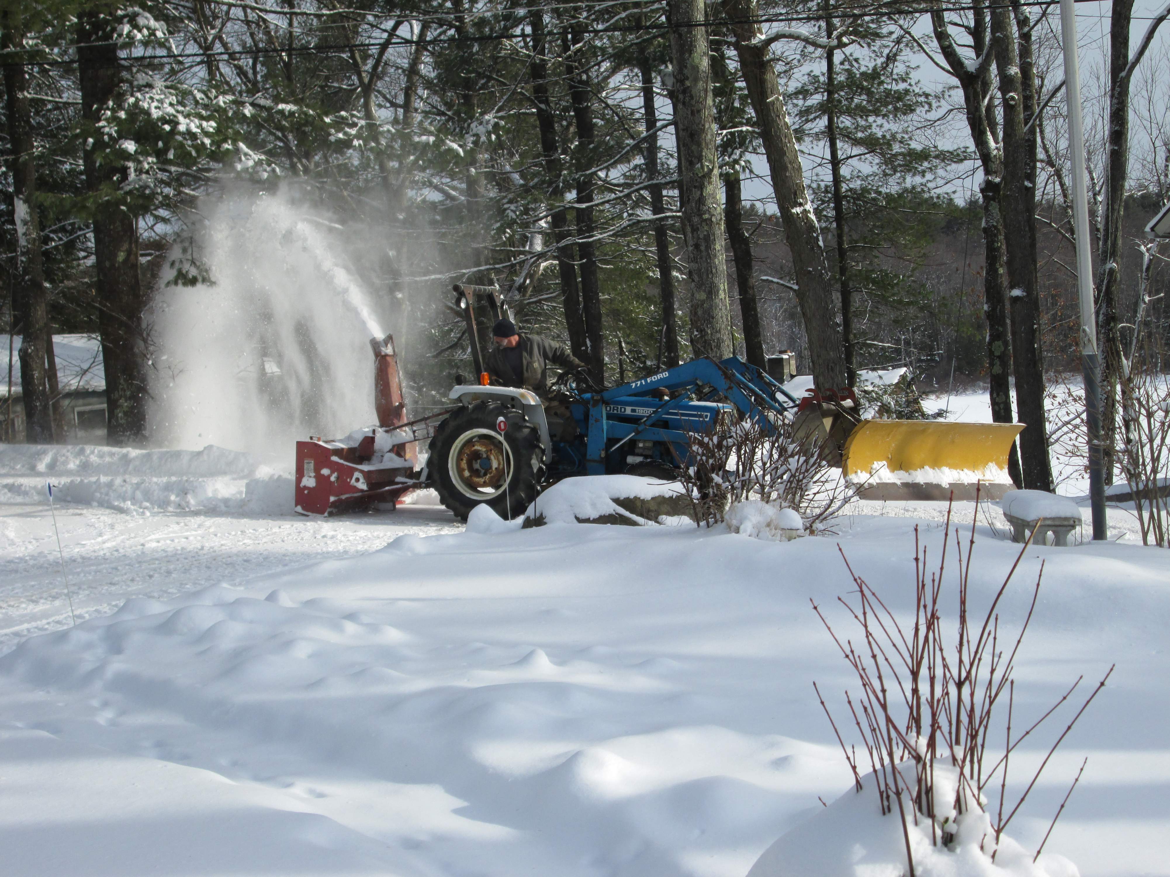

I am going to show my ignorance here. Other than not having to look backward and being in a cab - what is so much better about the Steiner set-up? Also you said it takes about 1/3 the time but the old snow blower is much wider wasn't it? Can you explain the real advantages?
That's not ignorance, that's a good question. First let me correct my first post - the machine is a 430 max, not a 440. That being said, there are several factors that contribute to the differences between the Ford/Meteor and the Steiner. The Ford is all gear with a live PTO, which works well but makes finding a suitable gear to match the conditions difficult at best - you spend a lot of time on the clutch. Both machines are rated at 27 hp but the Steiner with the hydro will take a full cut at a decent ground speed whereas the Ford labors, and again you are on and off the clutch. The Steiner is far more maneuverable than the Ford so much less time is spent putting yourself where you want to be. Looking forward is not to be discounted either - looking backwards over your shoulder while keeping your foot at the clutch is no fun. I would say that overall both machines will do the job well but the Steiner is just a more balanced, efficient machine, at least for blowing snow. I wouldn't want to have to do serious dirt work with the Steiner, the Ford is much better suited for that so the both have their place.
Again, thanks for the kind words, Rick

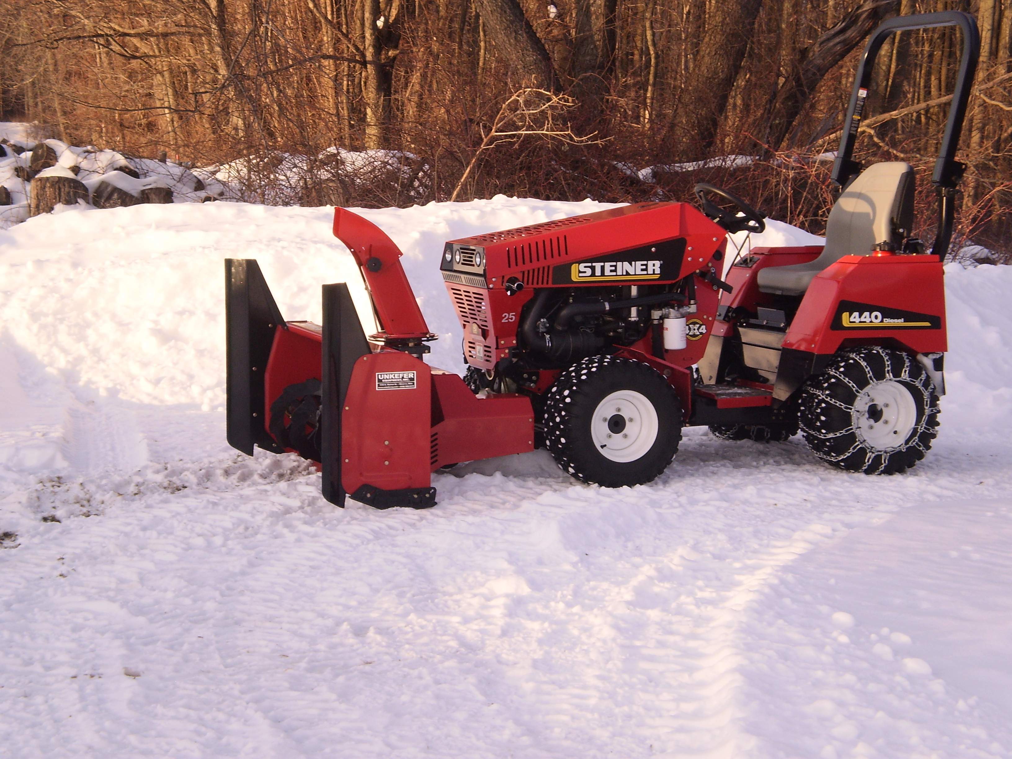

Nice looking Steiner linrick1. I 100% agree with you on the front blower verses the rear 3pt. I debated for several years getting one for my 790 but the thought of looking backwards while going up and down hills turned me away. Then last year the snow got bad enough I called the dealer and they said they could get me one right away and the rest is history. By the way your Steiner will do quite well with a front blade also. Not sure if you have one already.

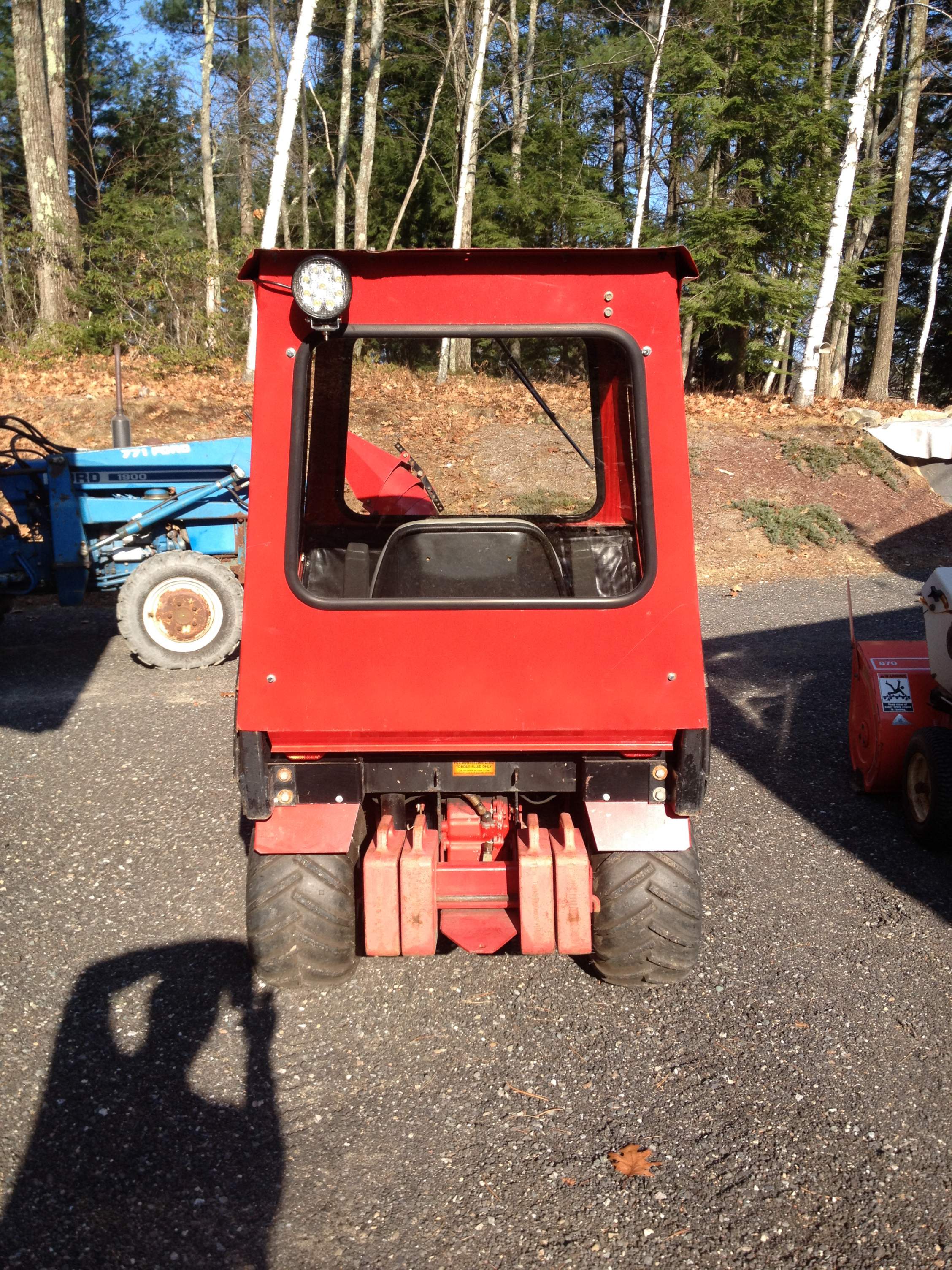

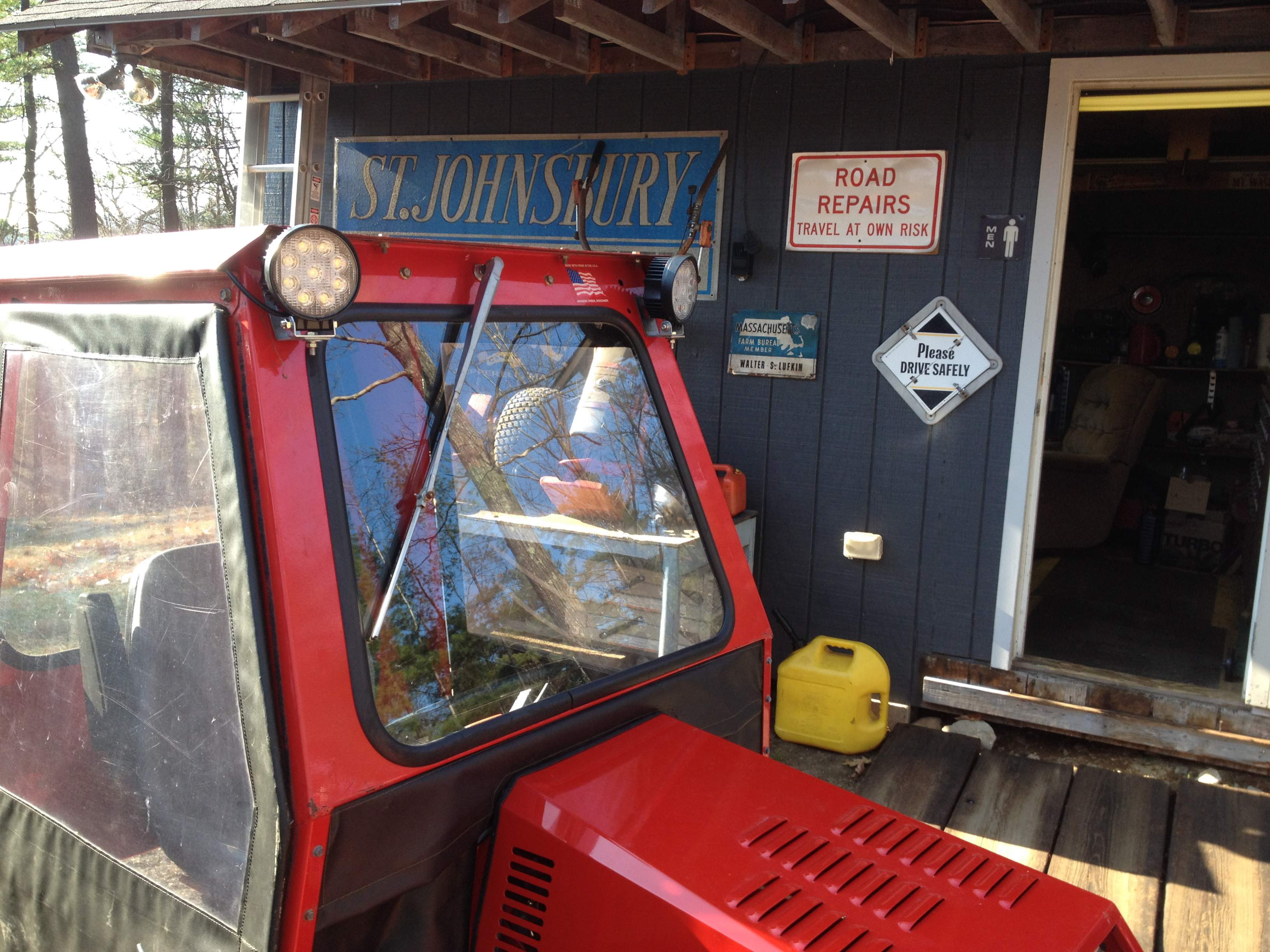

That's a fine looking rig you have there Double Deere. From looking at your pictures I can see quite a few differences between your machine and my older 430, the snow blowers look to be quite different. Good call on the blower for your Steiner, much more productive and comfortable than a 3 point for your 790. If at all possible I highly recommend obtaining a cab for your Steiner, you will not regret it.
Al, you hit the nail right on the head - while it takes me far less time to maintain what I generally have to keep clear you are absolutely right, add in the fun factor and I find myself clearing **** near the whole yard. Again the cab makes all the difference, being able to work in whatever weather and finish as dry as when I started makes it much easier for me to keep our driveway and road cleared no matter what time of day or night. I run a fleet of plow trucks, sanders and heavy equipment removing snow in the Worcester Mass. area so I am never able to plow my house with a storm. I have to take care of my place when I return home from work, generally at some ridiculous hour and I am far more inclined to want to do it knowing I'll at least be moderately comfortable........thanks again for the kind words, Rick
