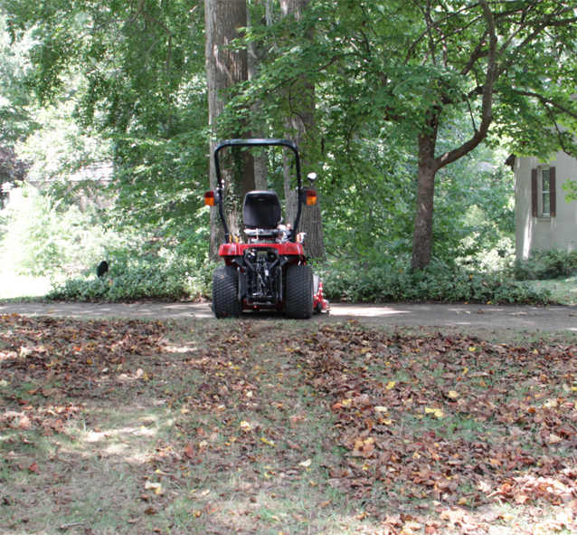

I own the 54-inch Massey mulching deck. I do not recommend it. It leaves (pun) un-mulched leaves in the center of a swath. Note the photo where a single pass left a poorly mulched area.
I also have a JD with a 48-inch mulching attachment. It does a far superior job of mulching.

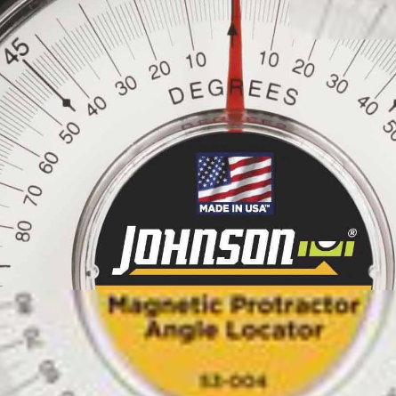

I really hope you meant 22%. No way I'd mowing anything 22 degrees, that's 40+%.

I laid down a 6' piece of angle iron and set a magnetic angle finder (see pic) on it and in most places it read 20°, but in one it read 22°.

Short answer, yes, it leaves a wind row in the center of the cut of un-mulched grass. Grass that has been cut, but not mulched. It almost looks weed whacked. Long pieces of grass that were just cut once and never touched by a blade a second time. Very strange
The outside blades of the deck mulch very well.
It is hard to see what I am talking about, but if you look carefully at the photos in this post, you can see what I am talking about. And this is one of Axlehub's posts. See the photo in #11
