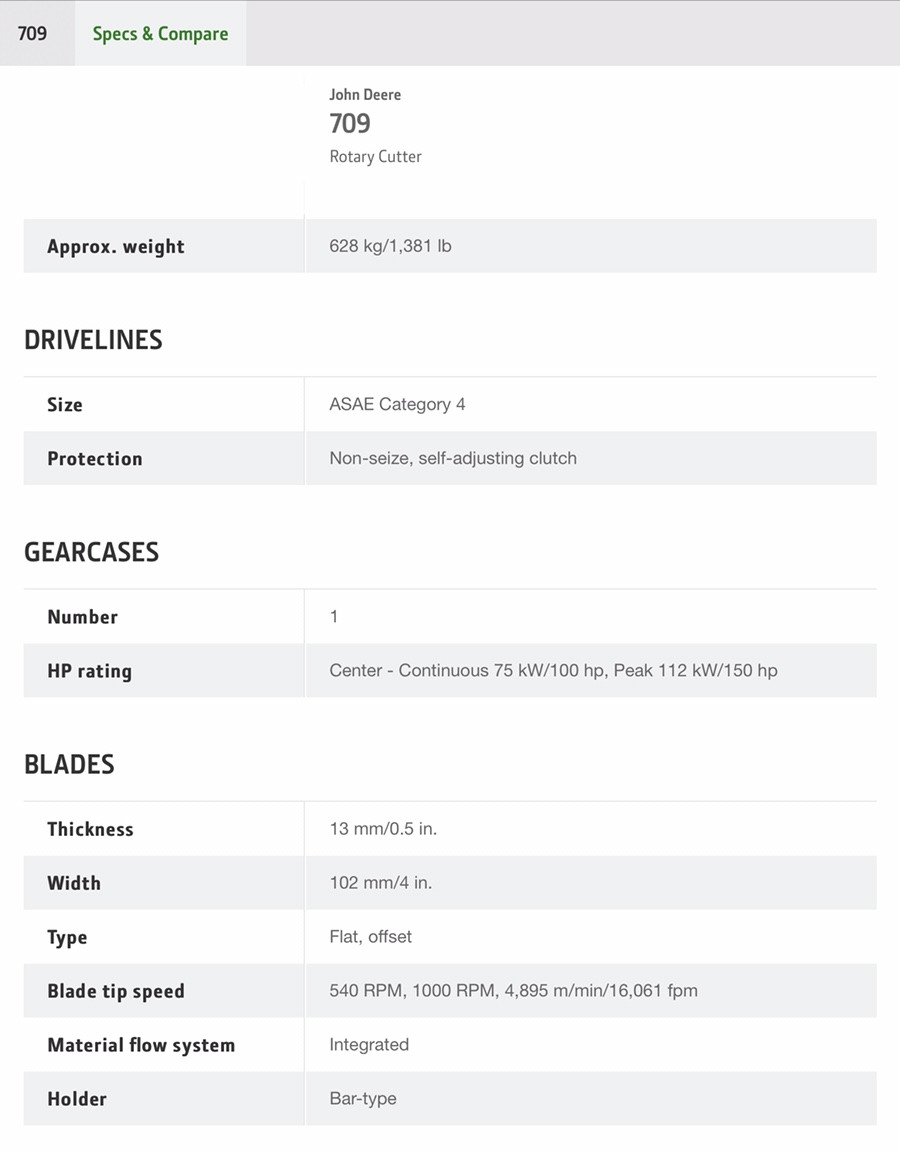

May or may not help.

JD 709 John Deere lists as HD/Commercial. 1381lbs, Deck is 4.5mm (.179") same as 7ga, skirt 6mm (.236") just under 1/4" , 100HP gear box (BB84 is 90HP) 16,061fpm blade tip speed. JD used several gear boxes over the years, so HP and tip speed may vary. JD says 100HP continuous, 150HP peak. I have not seen others rate their gear boxes that way.

Thanks Zebra, that fills in some of the blanks.
The puzzling standout looking at my spreadsheet thus far is the DEERE 709.

SO......everyone else throws on a 7ga top deck, BIG gearbox, 1/4" sides to boast a 4" cut capacity.....and this pushes weight up to ~1800+ pounds
SO....how does deere go to the heavy 7ga top.....1/4" sides, and 4" rating like everyone else.....but manage to stay 500 pounds lighter?.
