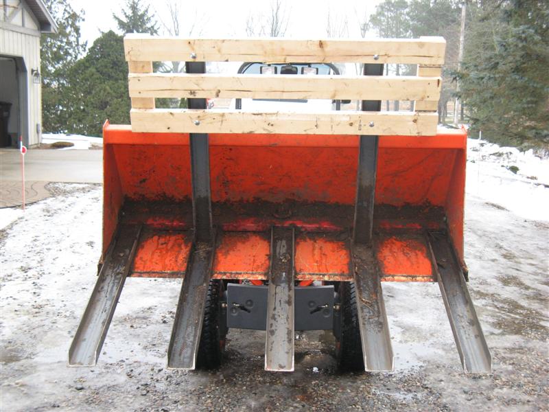

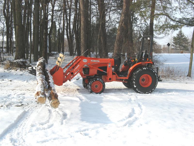

Here is something that a member made up that looks like it would work for you.
