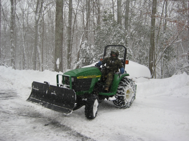

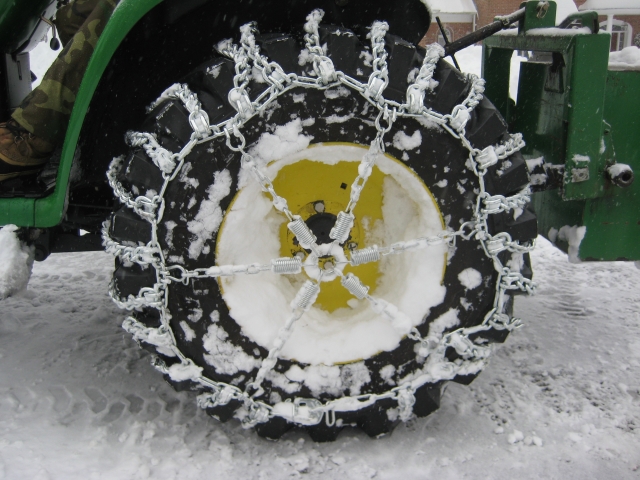

Tirechains.com two link chains. Get the tensioners, they are awesome. A lot of hours on mine in the last 7 days...
