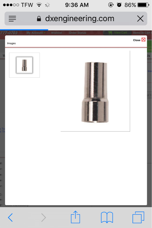

Yep, when I bought mine from Radio Shack, it also came with a torch tip, perfect for heating shrink wrap, or self sealing crimp connectors.
Here's a pic of one that's identical to mine, along with a pic of the torch tip. From a different company, but I'm sure ours were jus rebadged anyhow.
