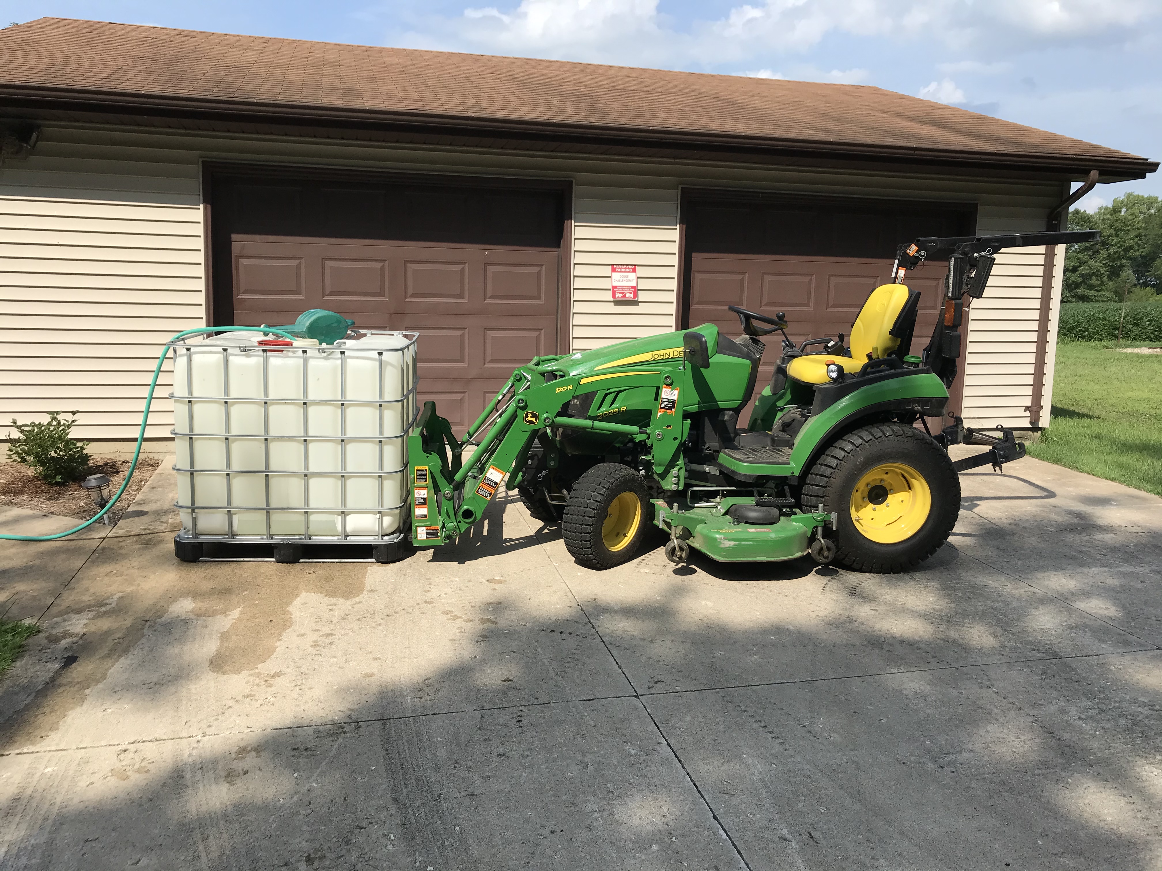

0D91AA2B-6B22-4623-89DB-76E959BF1ABF.jpegUp high on the ROPS is best. If you have the fold down type, that may or may not work. My main need for lights is snow removal. I don’t really like to put my ROPS up unless I have to and for snow removal I don’t have to. Mine are just about head level on the left upright on my ROPS. It’s fine most of the time but the forward facing on can blind you a little when looking over your shoulder and can also reflect off my glasses sometimes. You can kind of see them in the pic.

View attachment 667543Up high on the ROPS is best. If you have the fold down type, that may or may not work. My main need for lights is snow removal. I don’t really like to put my ROPS up unless I have to and for snow removal I don’t have to. Mine are just about head level on the left upright on my ROPS. It’s fine most of the time but the forward facing on can blind you a little when looking over your shoulder and can also reflect off my glasses sometimes. You can kind of see them in the pic.
Yes if I kept the ROPS up all the time that would be an easy solution. I can't get it in the garage with it up tho. Maybe mounted on the side of ROPS. . . hmmm that should work as long as I'm careful in the woods.

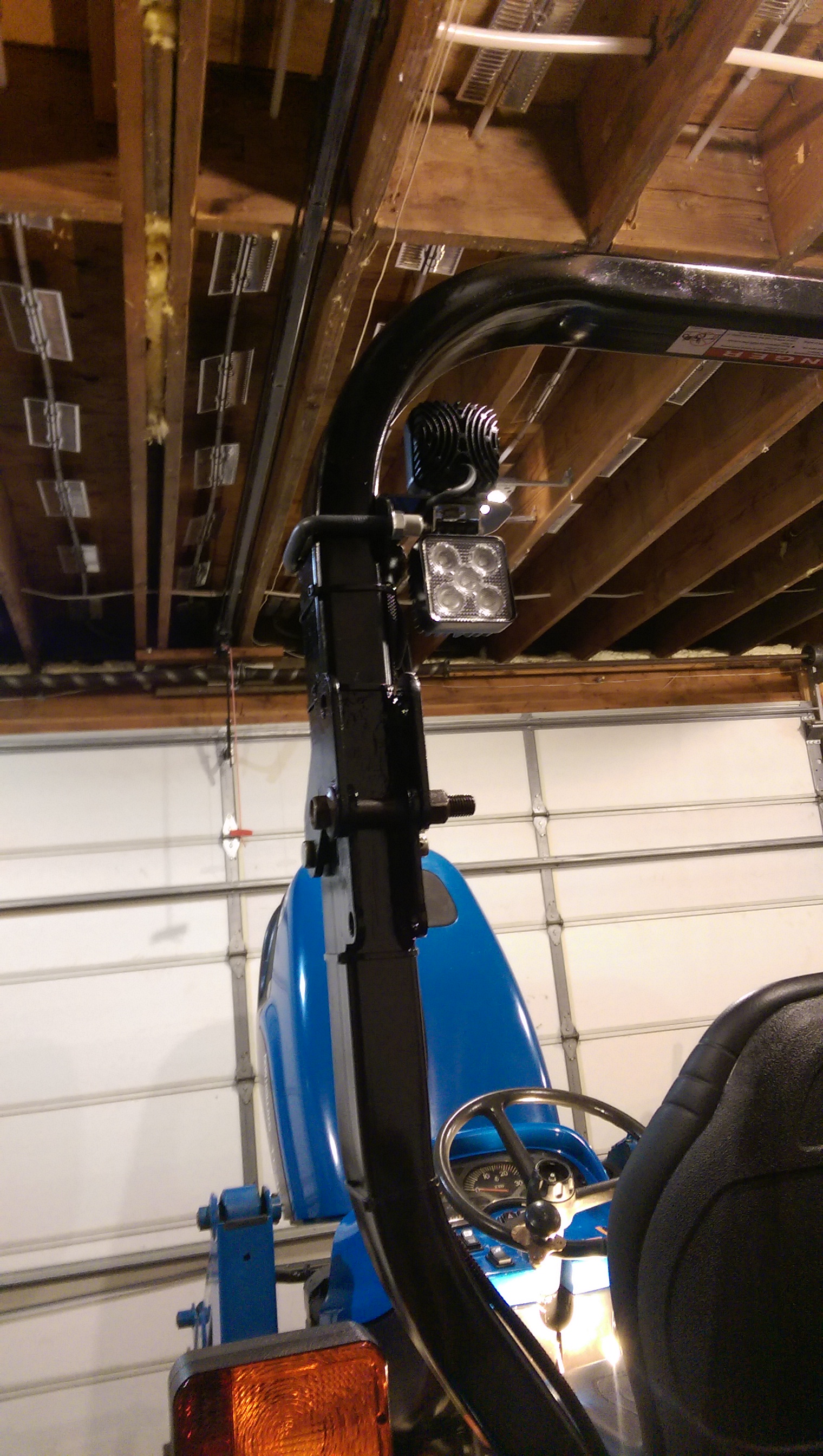

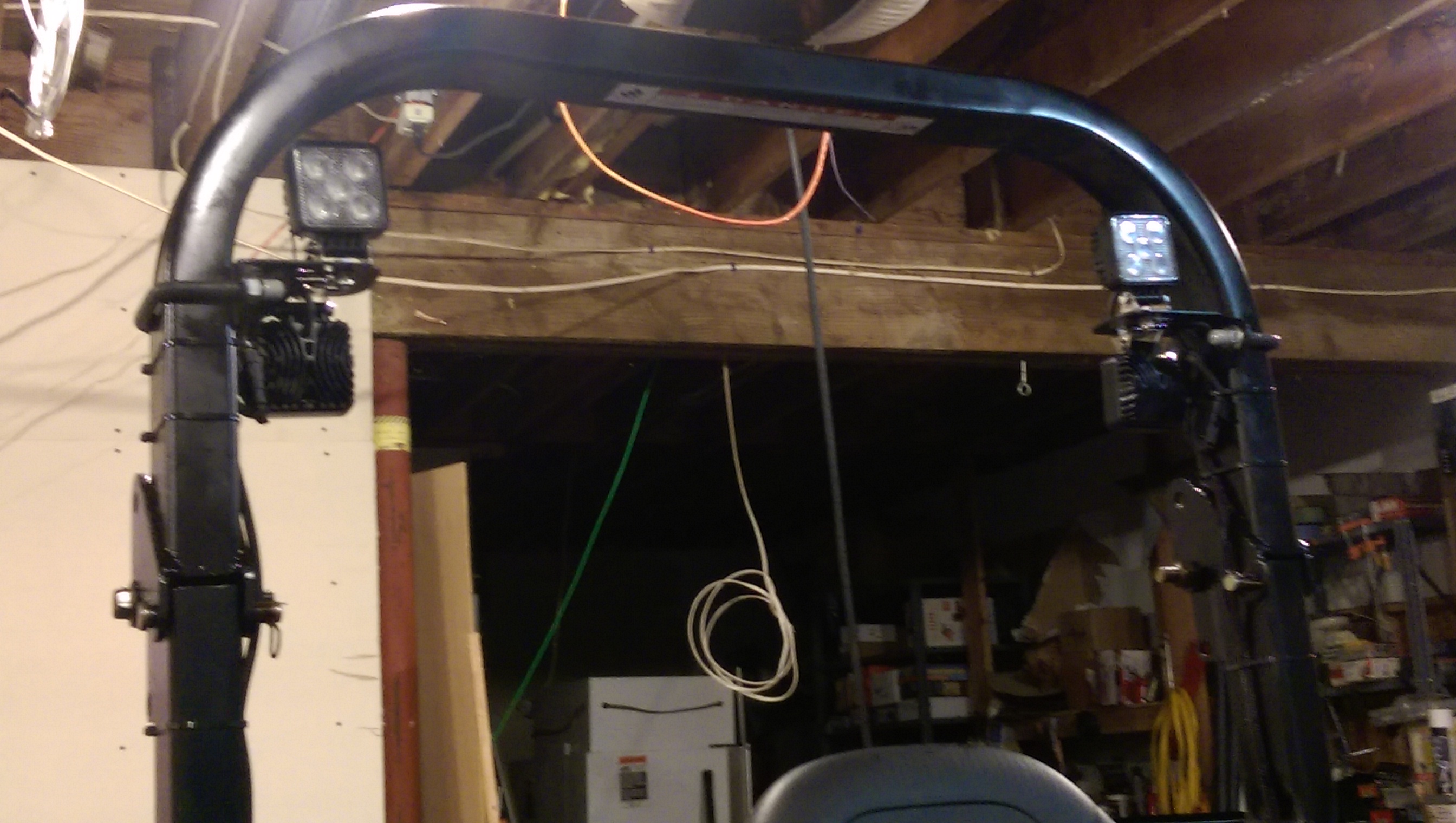

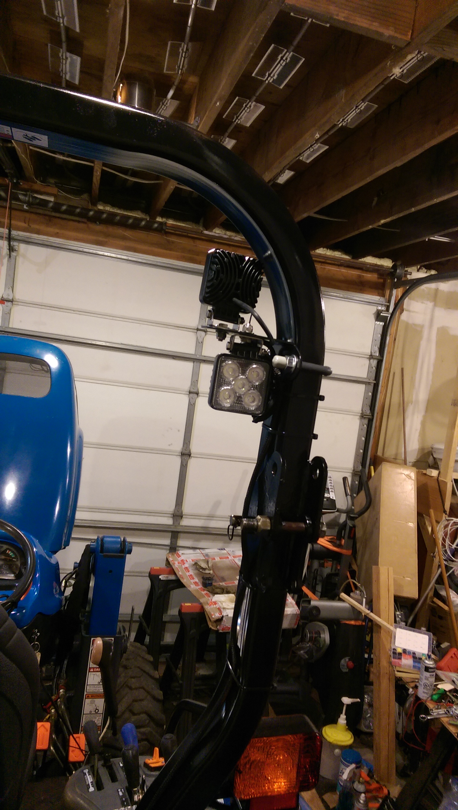

Like you I am in the woods often so I mounted them on the inner side of the ROPS. I used one bracket on each side to hold both the front & rear lights. I wasn't sold on the location at first but we have been very happy with them; glad we put them up high. With them mounted inside the ROPS we have zero issues with trees or branches.

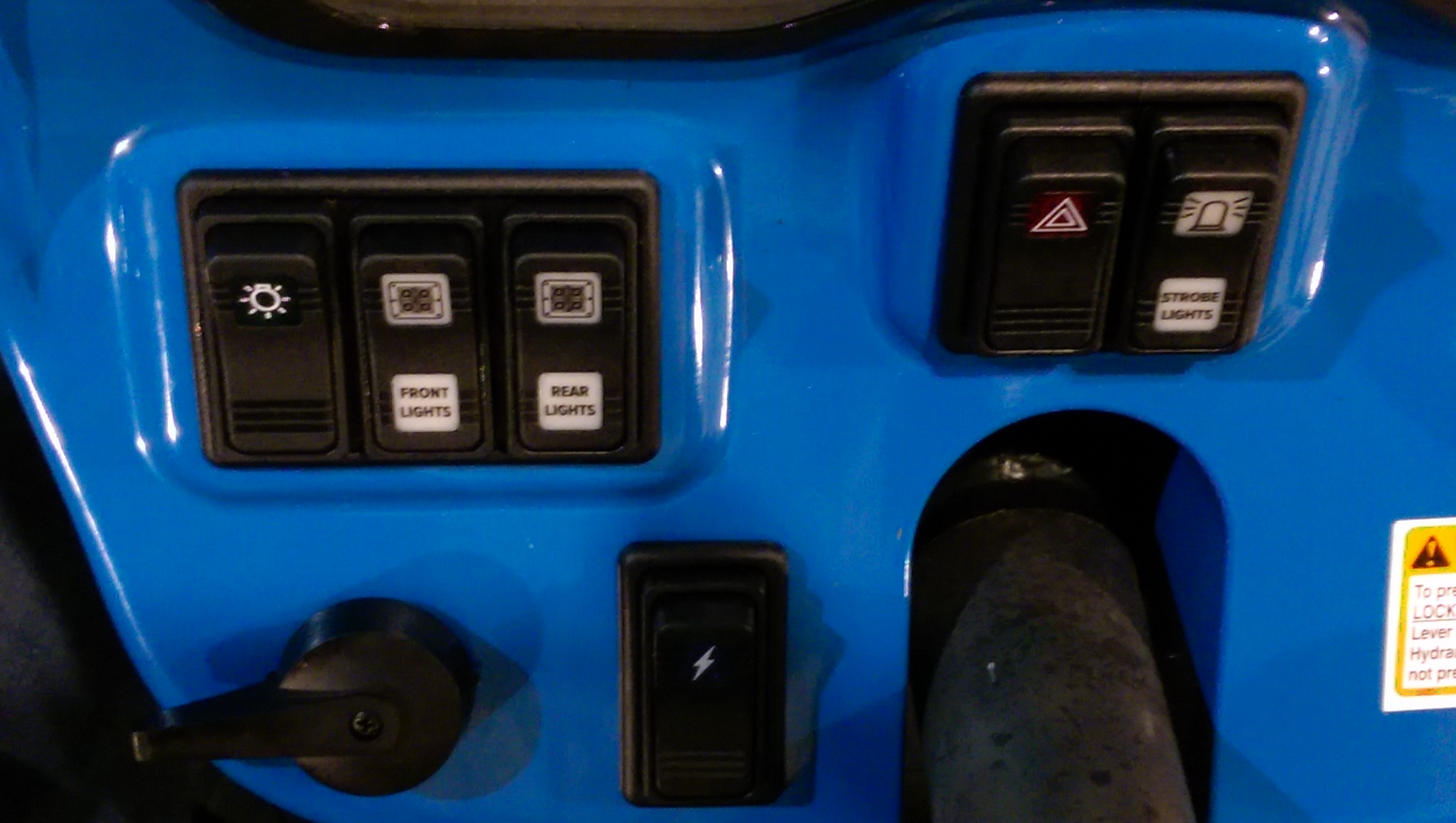

We setup separate switches for the front & rear
