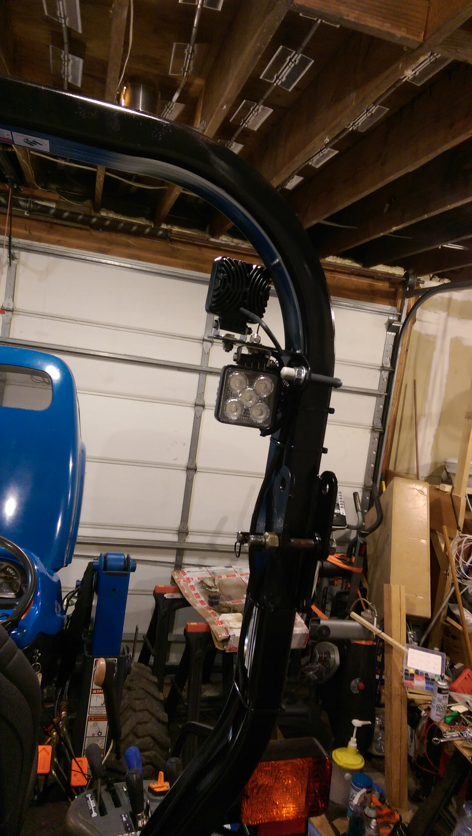

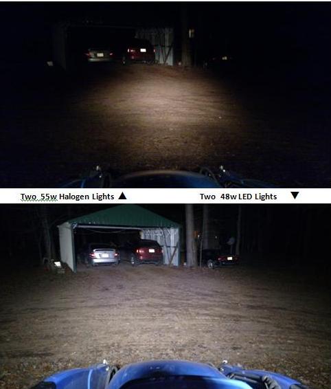

I put them under the top bar of my ROPS, and I like that because the loader bucket doesn't block the light. I first had 55W Halogens, and replaced them with 48W LEDs. The difference was amazing.

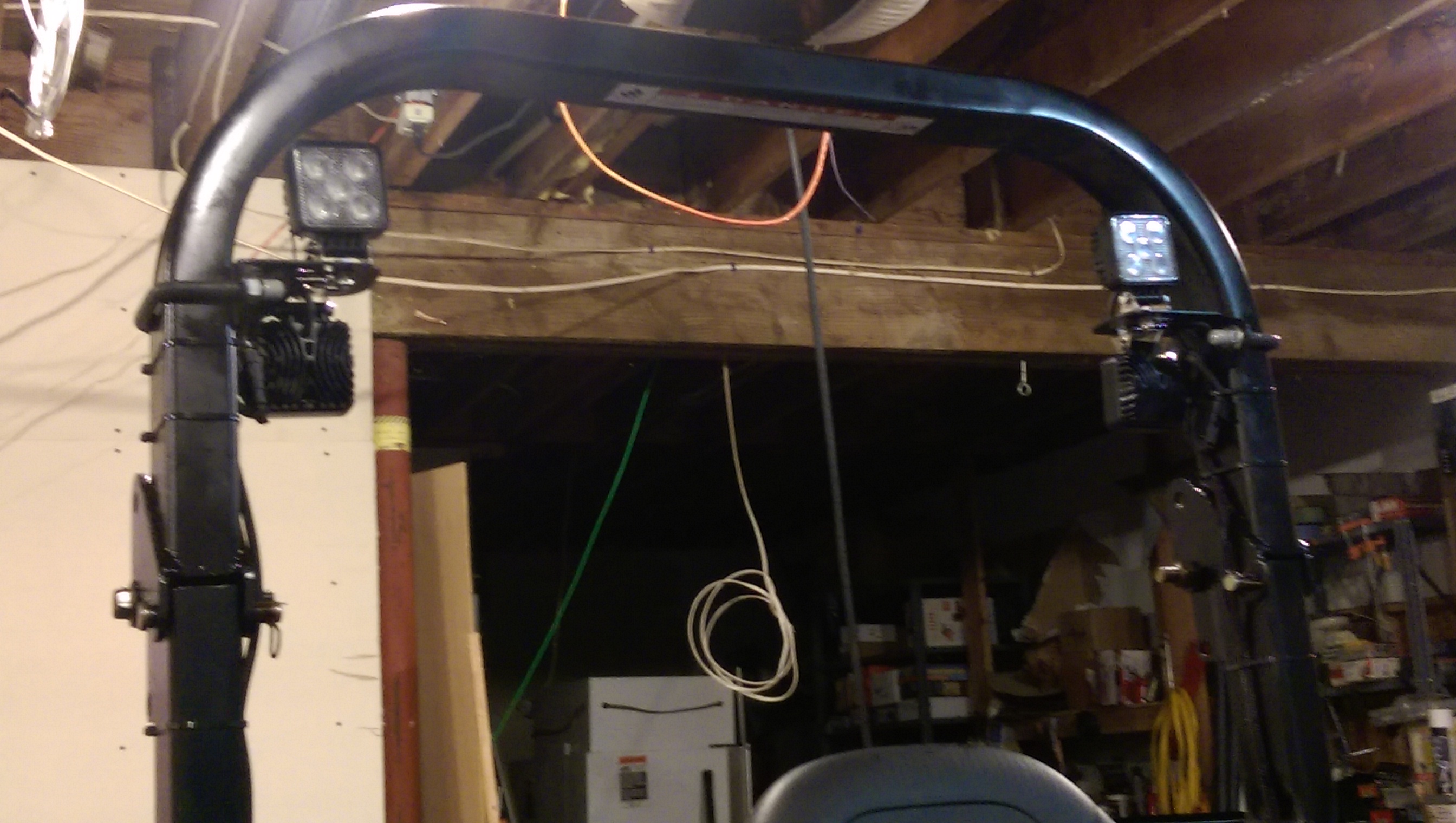

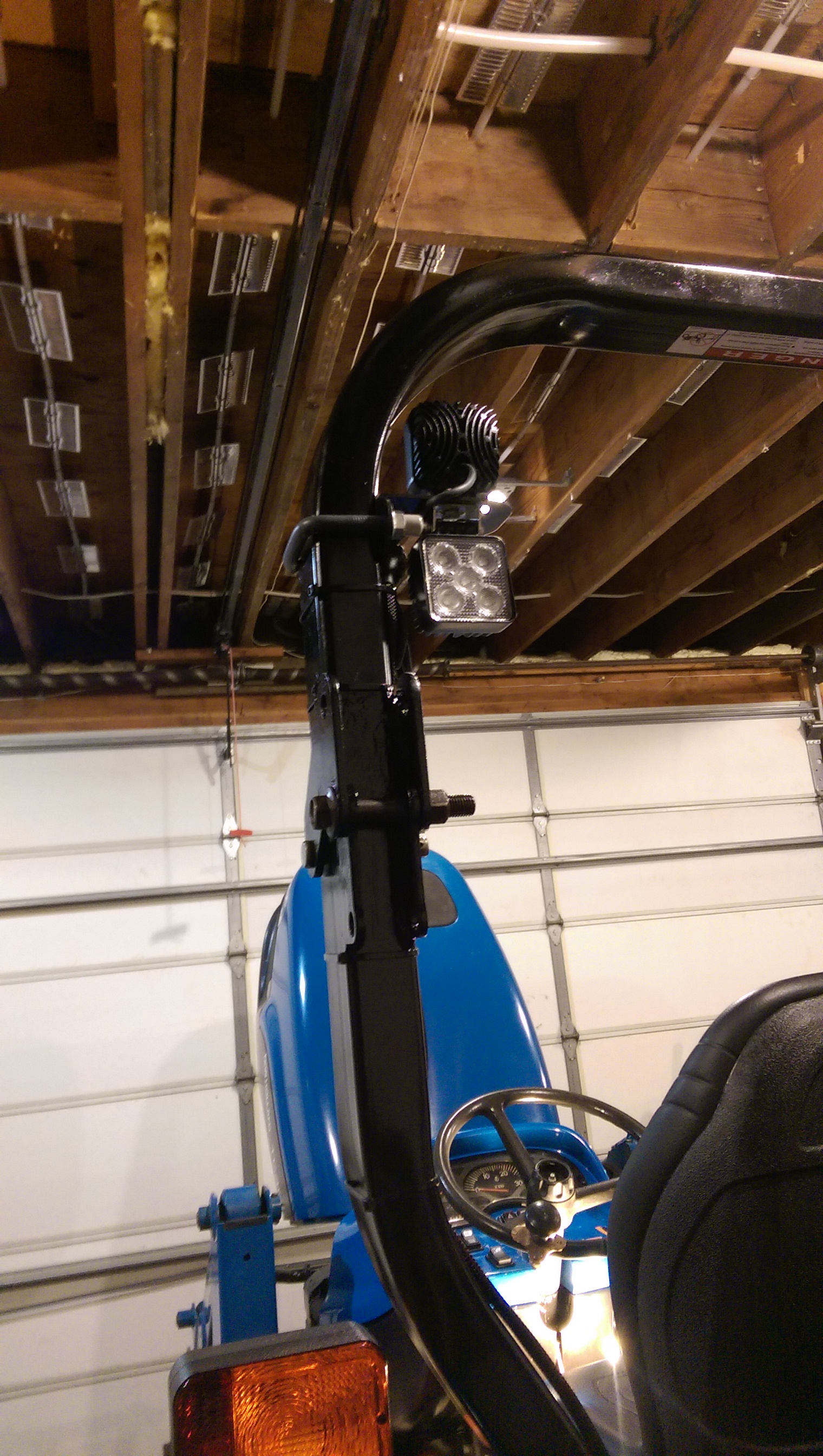

Like you I am in the woods often so I mounted them on the inner side of the ROPS. I used one bracket on each side to hold both the front & rear lights. I wasn't sold on the location at first but we have been very happy with them; glad we put them up high. With them mounted inside the ROPS we have zero issues with trees or branches.

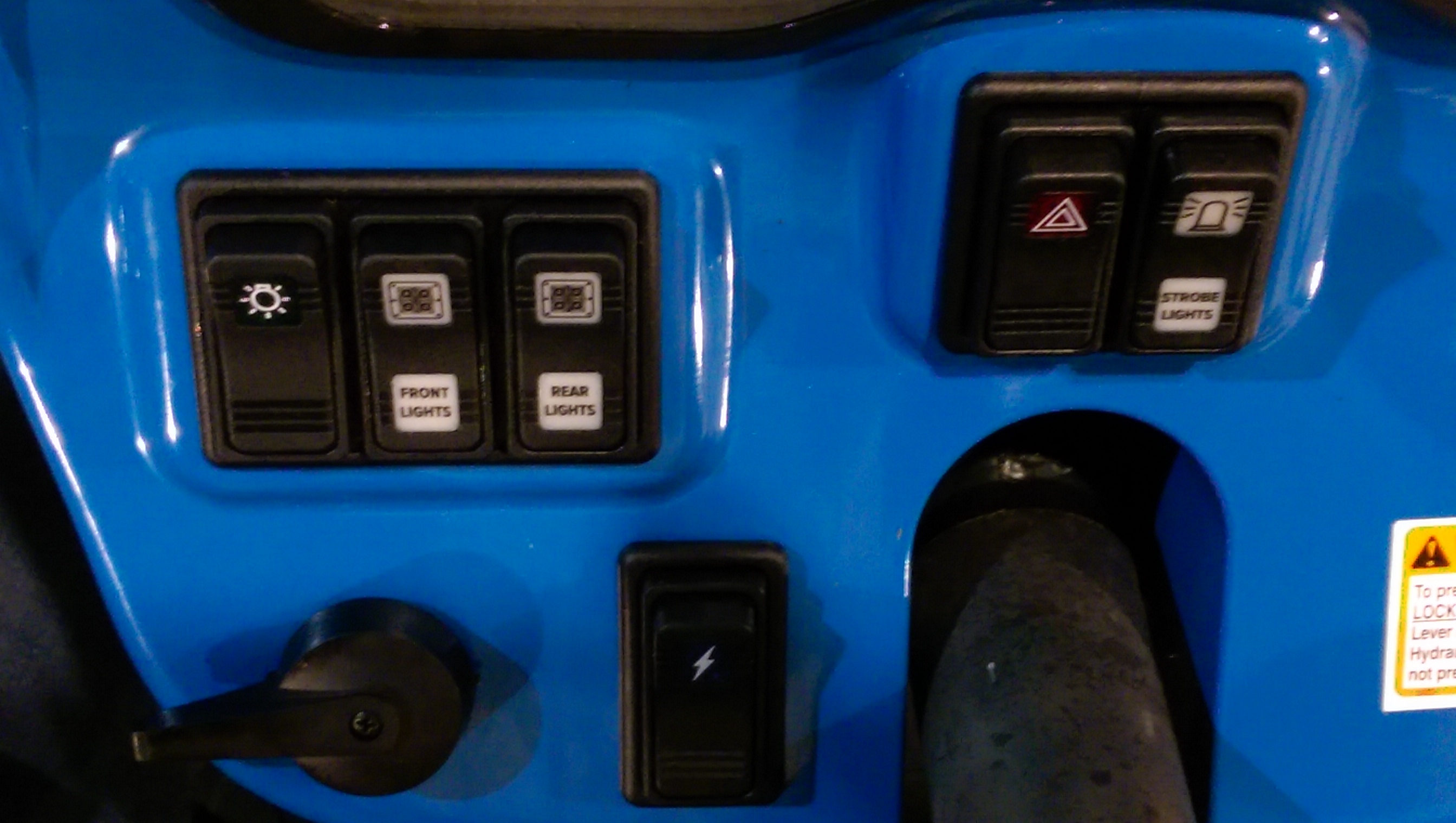

We setup separate switches for the front & rear
Thanks for pix and nice clean switch layout :)
