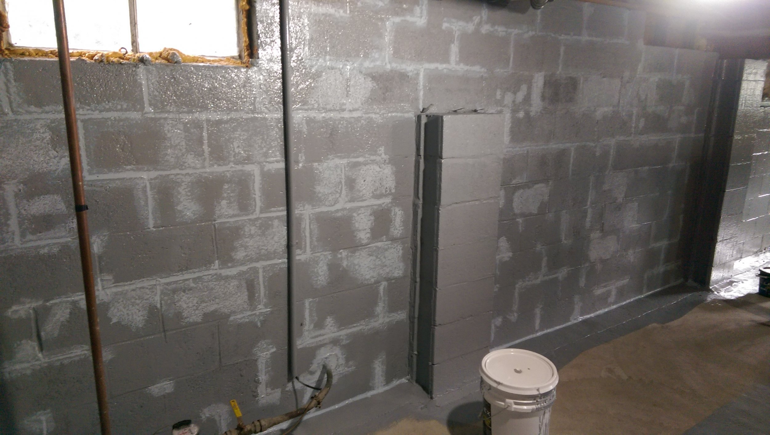

Walls Prepped prior & 1st coat of Sani-Tred

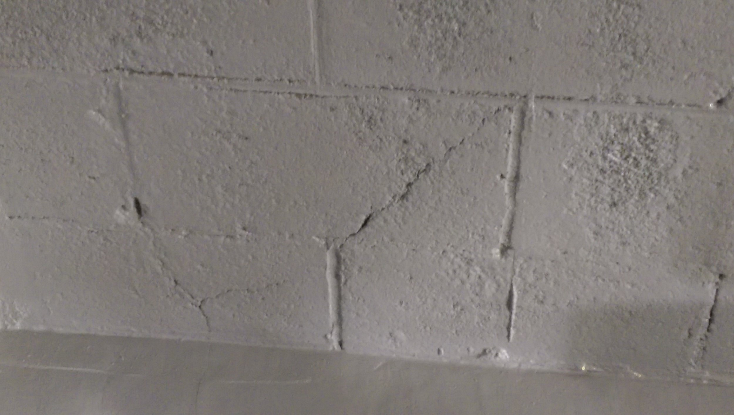

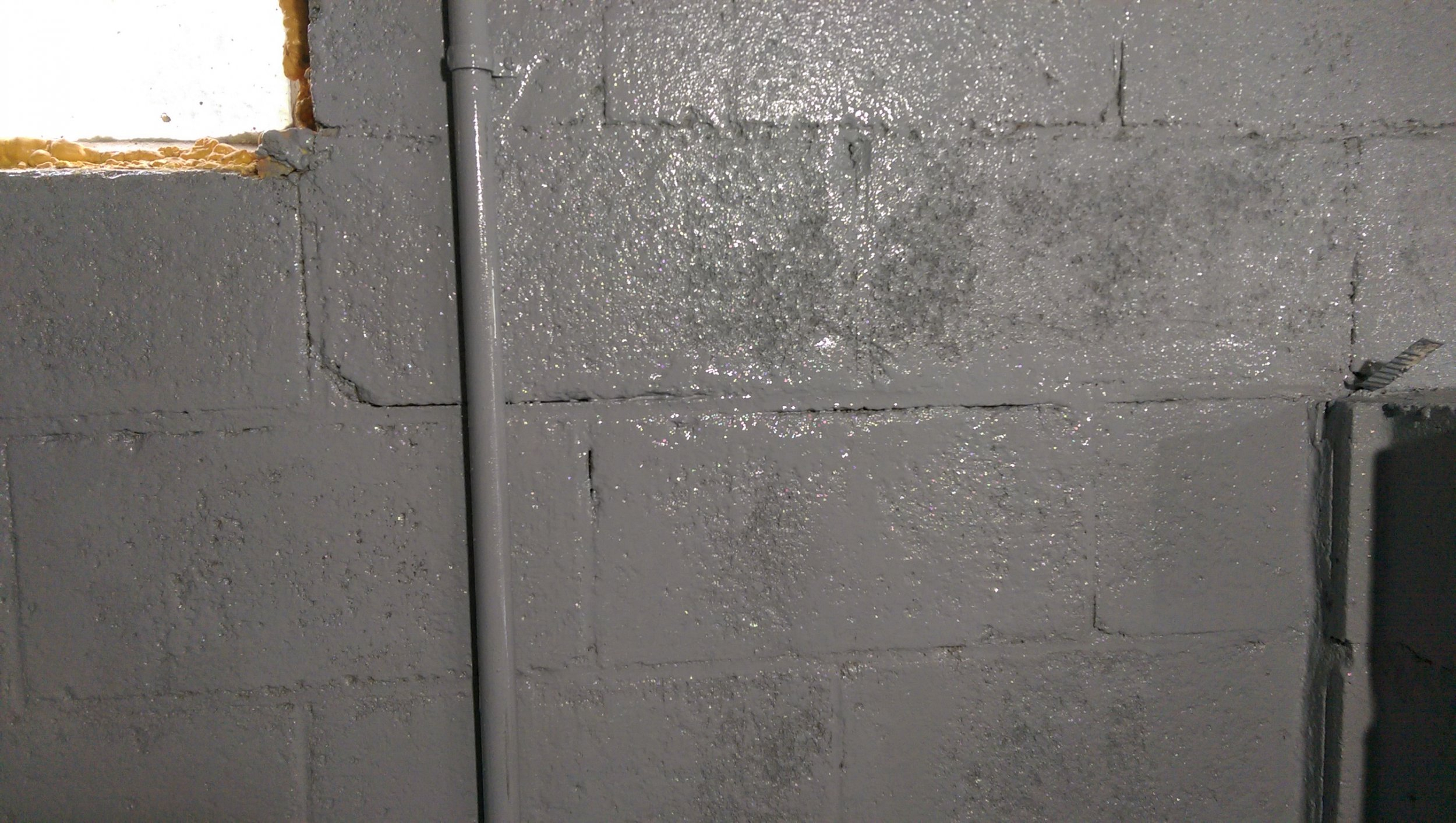

Typical cracks in the block (1st coat rolled on)

Cracks & flaws filled with LRB

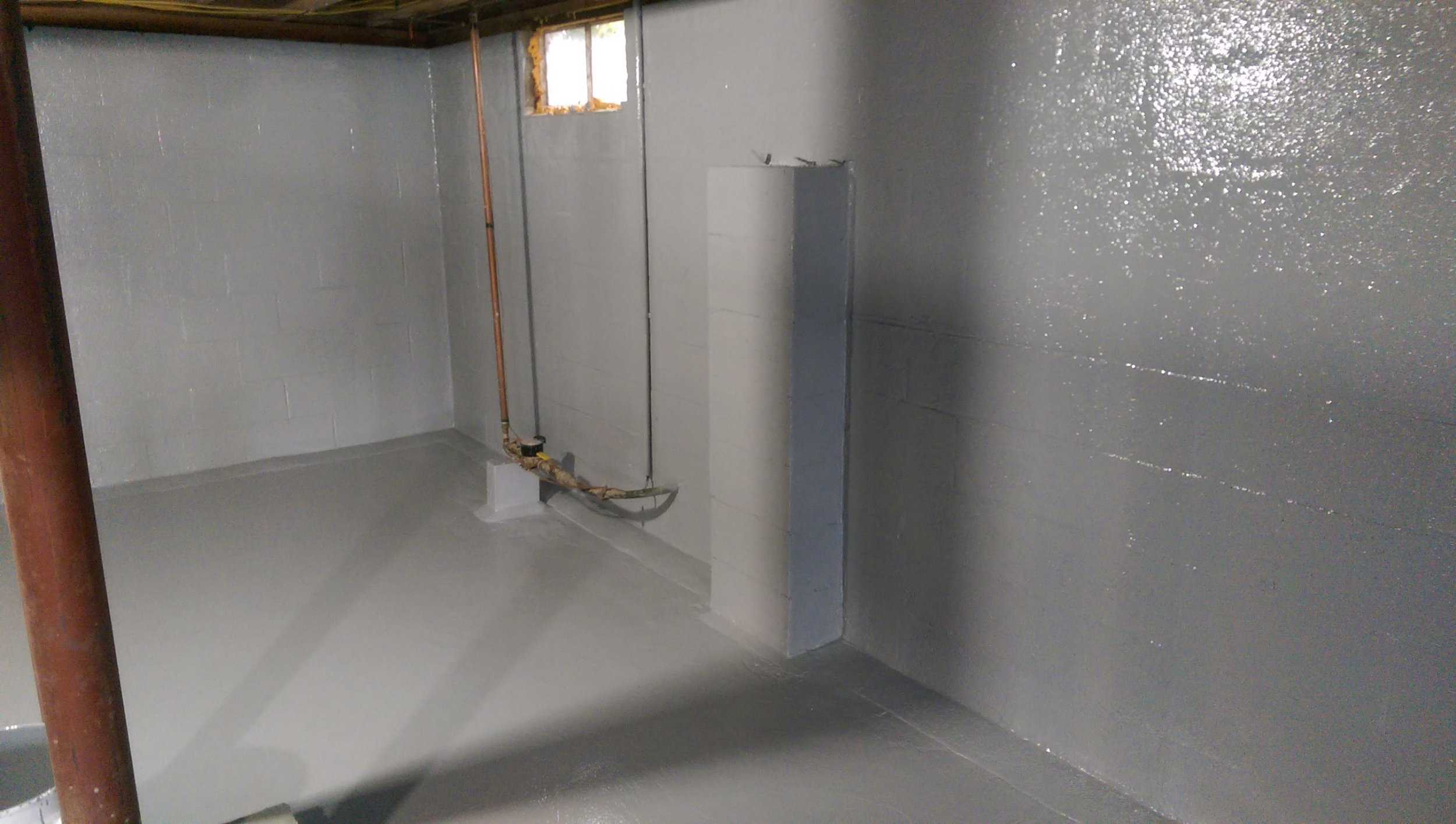

Final Coat of Sani-Tred

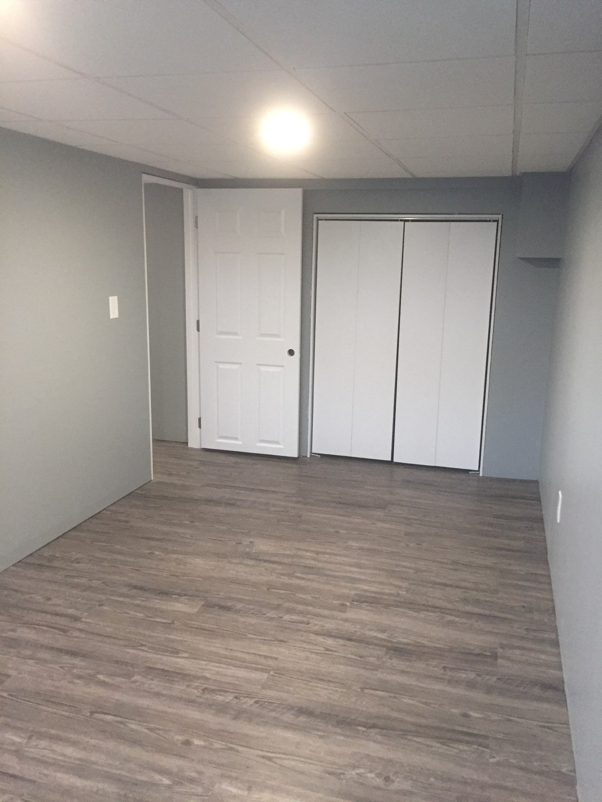

Part of the finished basement
