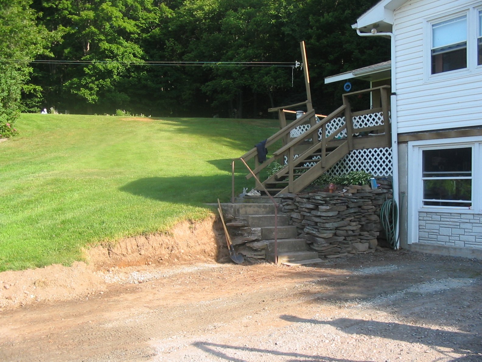

I have an outside entrance to my basement which takes advantage of the natural slope of the land. I built the retaining wall when I built the house 30 years ago - six posts set in concrete which I dug with my post hole digger.
Well as you can see time has taken its toll and it looks pretty cheesy and what you can't see is that after water will run down to the door and into the basement when we have a really really hard rain (every 2 or 3 years).

I have spent 11 hours over the last 3 days on the tractor digging a trench (8 hours digging 175% of what I needed to take out and 3 hours putting back the extra 75%). the pictures below are before I moved much of the soil back. As you can see my soil is like beach sand, so the digging and moving was easy.
Tomorrow I rent a transit to make sure thing are level across the trench and that there is a slope away from the house before we lay the footing aggregate. I can't imagine what this thing will look like when we are done, but want to complete it before we leave for a month long scuba diving trip to sub-sahara Africa in mid June.​

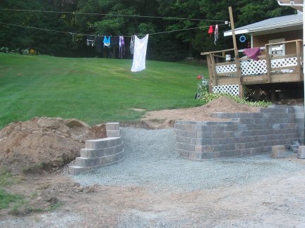

I had to make a road to do my excavating:
and finally the excavating was done and I put done 6 inches of aggregate:
Finally it was time to begin laying the block on a dreary and dismal day. We took our time with the first course. Hopefully we will make a lot more progress tomorrow:

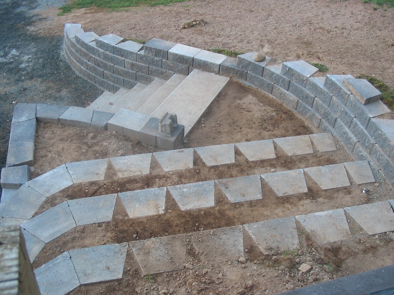

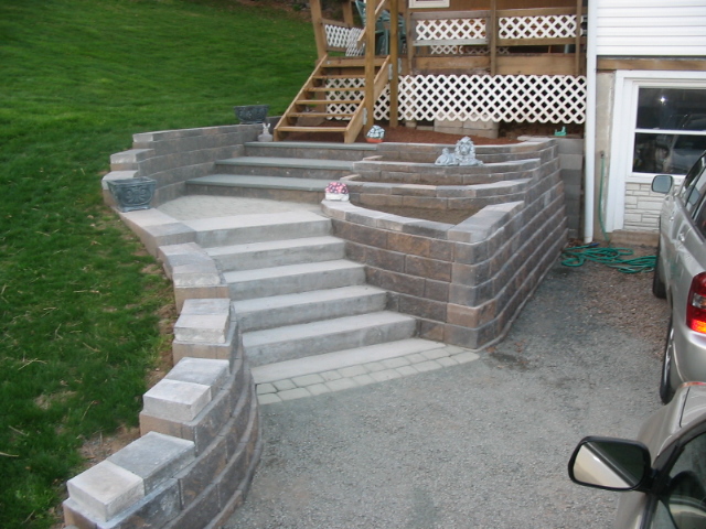

Yesterday my wife put the corners in and we finally developed a rhythm for the project:
Today we made really good progress despite the temperature being in the high 80's. This was the first 80 degree day this year. We completed the wall on the right side except for the cap. Tomorrow we should finish the other side and perhaps get started with the paving bricks.
The picture below is my wife brushing off the aggregate that accumulated on the ledges. The block are filled with aggregate and there is about 1 foot of aggregate behind the block. Without the tractor this project would have been difficult, if not impossible.
I hope to get everything done except the landscaping before we leave for our 1 month scuba diving/safari trip to Africa this Thursday.

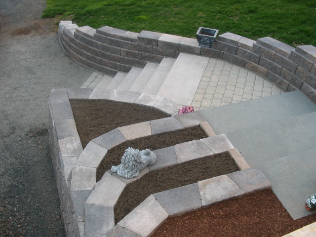

Very,Very Nice! I can say that because my wife and I just finished a project.
IMG_3343.JPG Finished_02.JPG<----Gizmo1 (He is the Boss)
