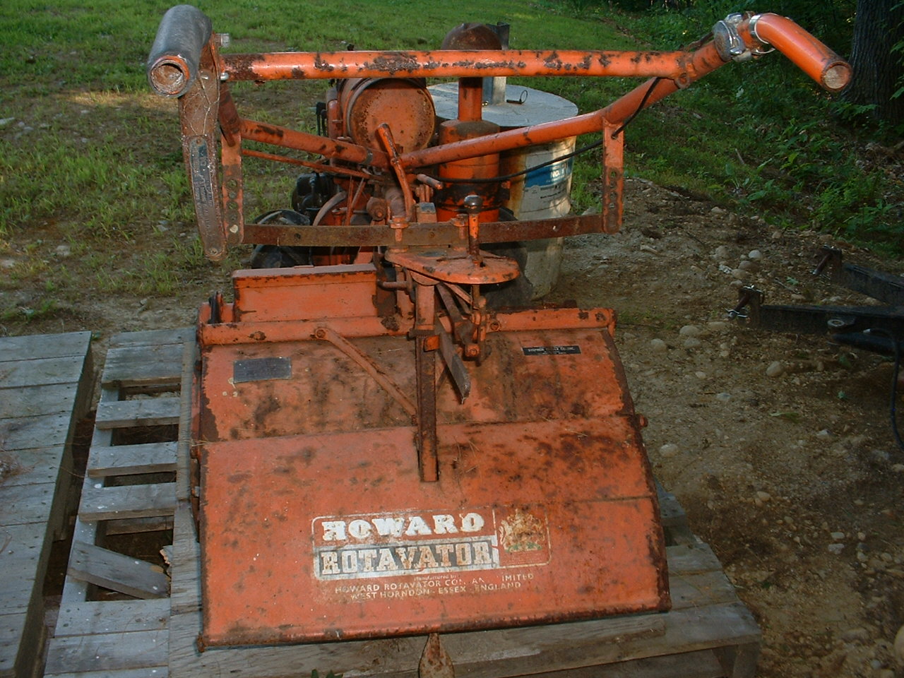

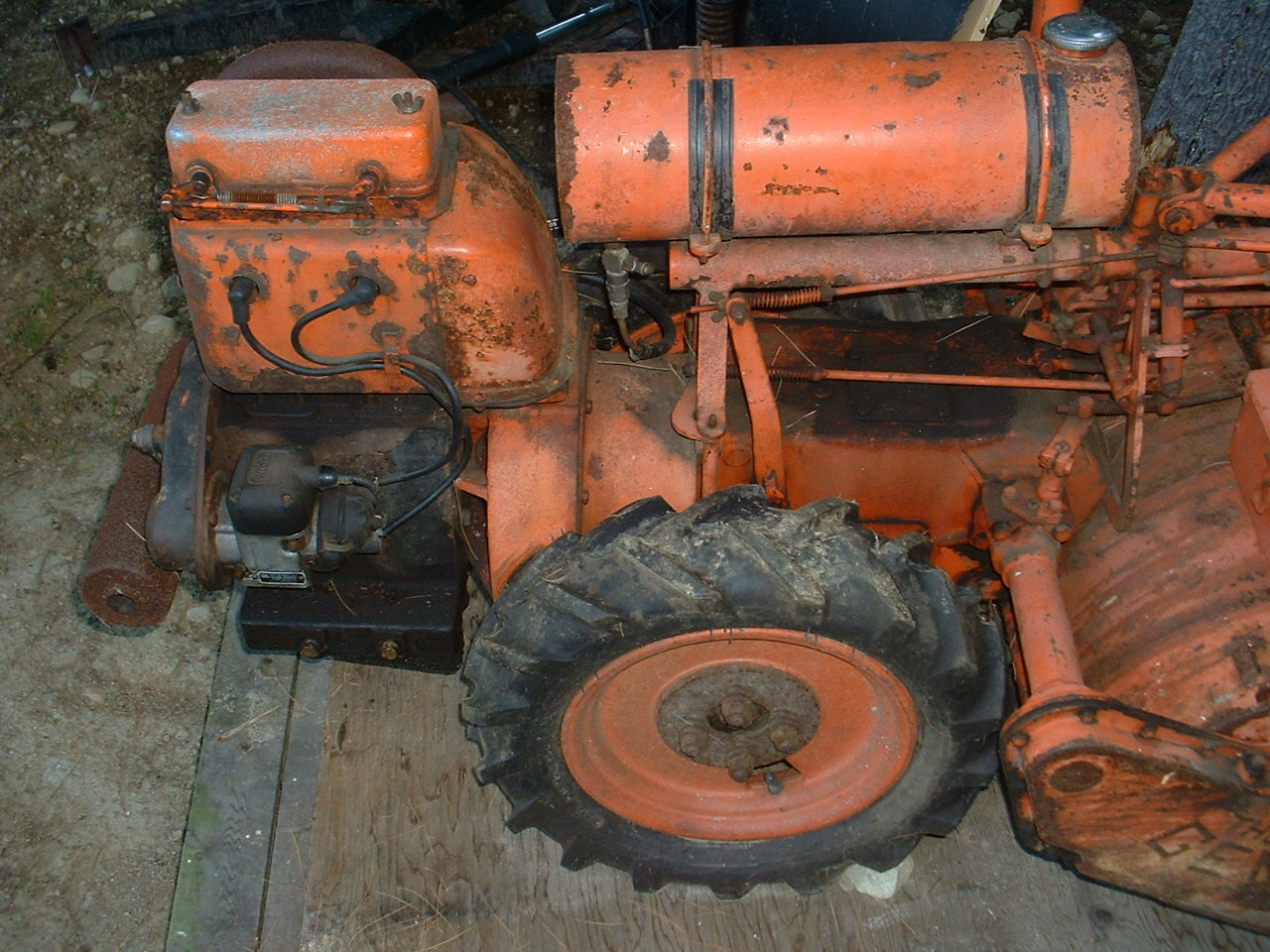

Its been mentioned before in this thread already but if you're after a tiller that will easily handle any ground that could conceivably grow plants than you want a Howard Gem.....absolutely, hands down the finest tiller made.
