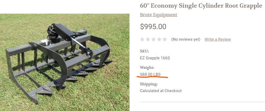

Well....I went and checked out the Westendorf. I still think it's too much. Would be nice not having any hydraulics to mess with. But, there's a fella that sells Brute Grapples up in Wisconsin and he has the 72" grapple for $875 I believe. I would need to have hydraulic hoses made to run to the rear SCV, but that could be done for about $200 I think. So I think I'm going to run up there next week on one of my days off. Look like a pretty stout product. Anybody have a Brute grapple?
   / Best/reasonably priced grapple? #32
A search found this: http://www.buyattachments4less.com/60-economy-single-cylinder-root-grapple/
What is the lift rating of your loader?
#33
I believe it's about 2400 or somewhere close to that.
   / Best/reasonably priced grapple? #35
This does seem like it could be a good grapple, plus its made here in the US. I wonder what kind of steel it is made from. I could find no mention of it anywhere on their website. If it is a good quality hardened steel, that would seem to be a pretty good deal!
say's A36 on their website.

That one I was looking at is for a bigger tractor. My loader is rated for almost 4k lbs, and will actually lift a fair bit more. The link was mostly provided as a link to the company.
Your RX is rated for 3300 to full height. A 1200 pound grapple is going to seriously compromise the lifting ability of that size machine. I had a 1700 pound grapple on a 95-2 Kubota CTL and I hated that thing. It was way too big. I’ve got a 600 pound ar400 grapple on my 3800 pound rated M59 and it’s a much better fit.
