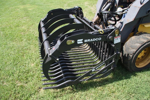

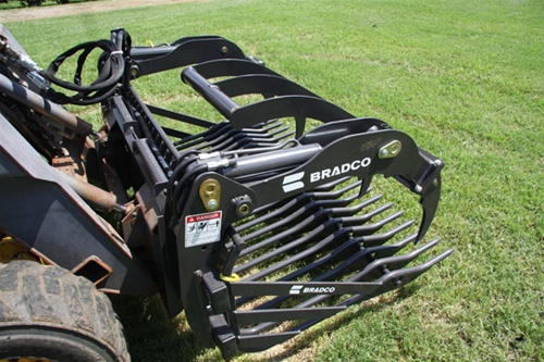

To get the the thread back on track, this is the basic Rock Grapple, sold by EA, a site sponsor.

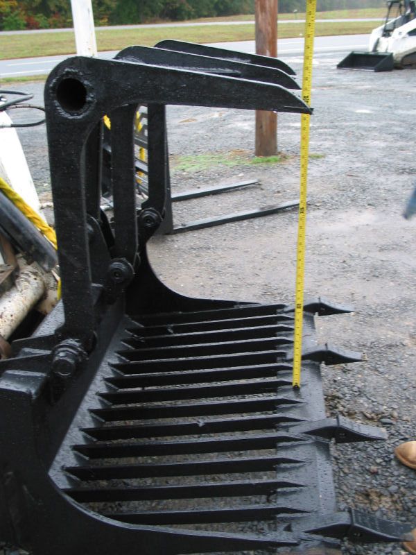

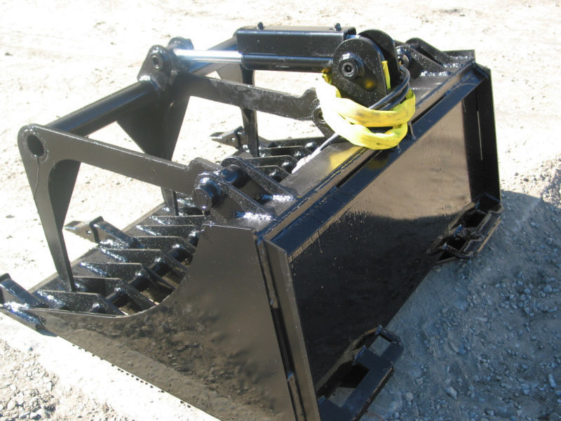

This is a 48" from Wildkat.

The problem I see with the Wildkat is the same one that I have with my Wildkat Stump Grapple, and that is the solid backplate that keeps you from seeing what the heck is going on at the front of the grapple. With a skid steer, where the operator's station is right on top of the action, it might be better. But with a tractor, where the grapple is 6' or more away from the operator's seat, you can't see what's happening up there.
I need to remember to take some pics and video from the tractor seat the next time I'm using my grapple, which would show it better than explaining it.
The Bradco rock grapple you show does not have a solid backplate. I would much prefer that setup. That one looks pretty slick to me.
