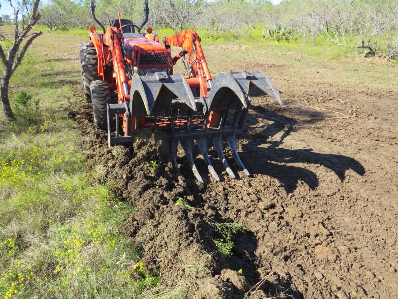

The biggest difference I can see between the Everything Attachments CA Xtreme Grapple and the Rake Shop version appears to be the front tines.
The Everything Attachments grapple has a horizontal cylindrical bar which ties all of the tines together. To me, this would be good for limiting depth for digging up roots, but if I'm correct, it would also limit functionality when attempting to dig up rocks or something that requires more depth. The Rake Shop version would seem to offer more usage flexibility assuming the tines would not bend (they sure look strong, but hard to say).
I like the idea of buying from the larger company to get what is sure to be good warranty coverage, etc. and I haven't talked to the folks from Rake Shop yet to get stats on weight, cost, etc. yet.
Thoughts from the experts here?
   / Best Root Grapple for 75hp Tractor? #15
The biggest difference I can see between the Everything Attachments CA Xtreme Grapple and the Rake Shop version appears to be the front tines. The Everything Attachments grapple has a horizontal cylindrical bar which ties all of the tines together. To me, this would be good for limiting depth for digging up roots, but if I'm correct, it would also limit functionality when attempting to dig up rocks or something that requires more depth. The Rake Shop version would seem to offer more usage flexibility assuming the tines would not bend (they sure look strong, but hard to say). I like the idea of buying from the larger company to get what is sure to be good warranty coverage, etc. and I haven't talked to the folks from Rake Shop yet to get stats on weight, cost, etc. yet. Thoughts from the experts here?
I looked at the rake shops online. The light duty ones look very weak to me. I know how I use mine, and I guarantee that I would bend those long unsupported tines. Their trash grapple version looks better. As far as digging, I really don't think having tines connected really limits depth, as frankly, about a foot or so deep is all you're going to get with a tractor, each pass. But having them splinted together really adds strength. I would also be afraid of wedging a log or limb between those tines, requiring a lot of work to pull it or cut it out. That's just my opinion. Never seen in person, but that EA X treme looks like a Mac daddy grapple.

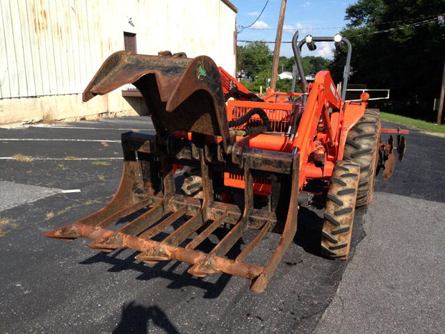

   / Best Root Grapple for 75hp Tractor? #18
I have not heard of the Rake Shop grapple tines bending. I have a different brand with long tines and have not had a problem. I like the penetrating ability into tree branches, etc. That dang cross tube stops the tines from penetrating.
