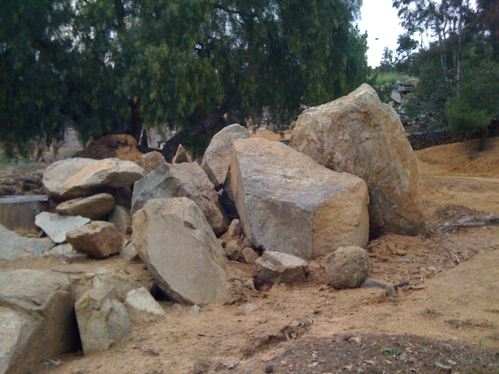

Well.... when I said large (VW size) I mean big. Here are some pics:
IMG_0388.jpg The smaller ones up to 3' x 4'

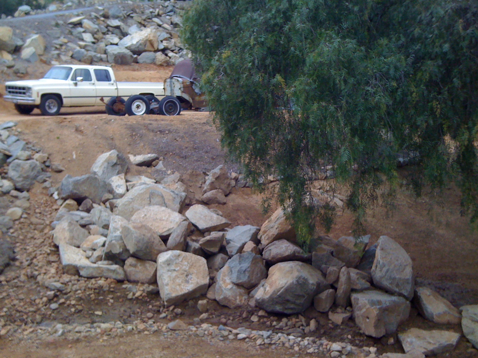

IMG_0389.jpg The big uns 4' x 6' up to car size.
Some are bigger as they are still down in the ground. I rented a skip loader to work some of them out of the ground and move them around.
Hope the pics are viewable.
There are other larger ones to split. I don't want to just break them up I want to split them into slabs for steps and landscape slabs. I've seen it done on youtube with rotary hammers and hammer drills with the use of feathers and wedges. I was just wondering which rotary hammers seem to drill granit best was well as hold up to the chore. There's lots of rock on my property. I spent over $1,000.00 blasting on the property in order to get my foundation and septic in 33 years ago. Not worried about the time. Just thought that if I'm splitting them up I might as well get some use out of them and possibly sell some of them as well. The flat landers in the area seem to love rock cus they ain't got none down there in the dirt!
