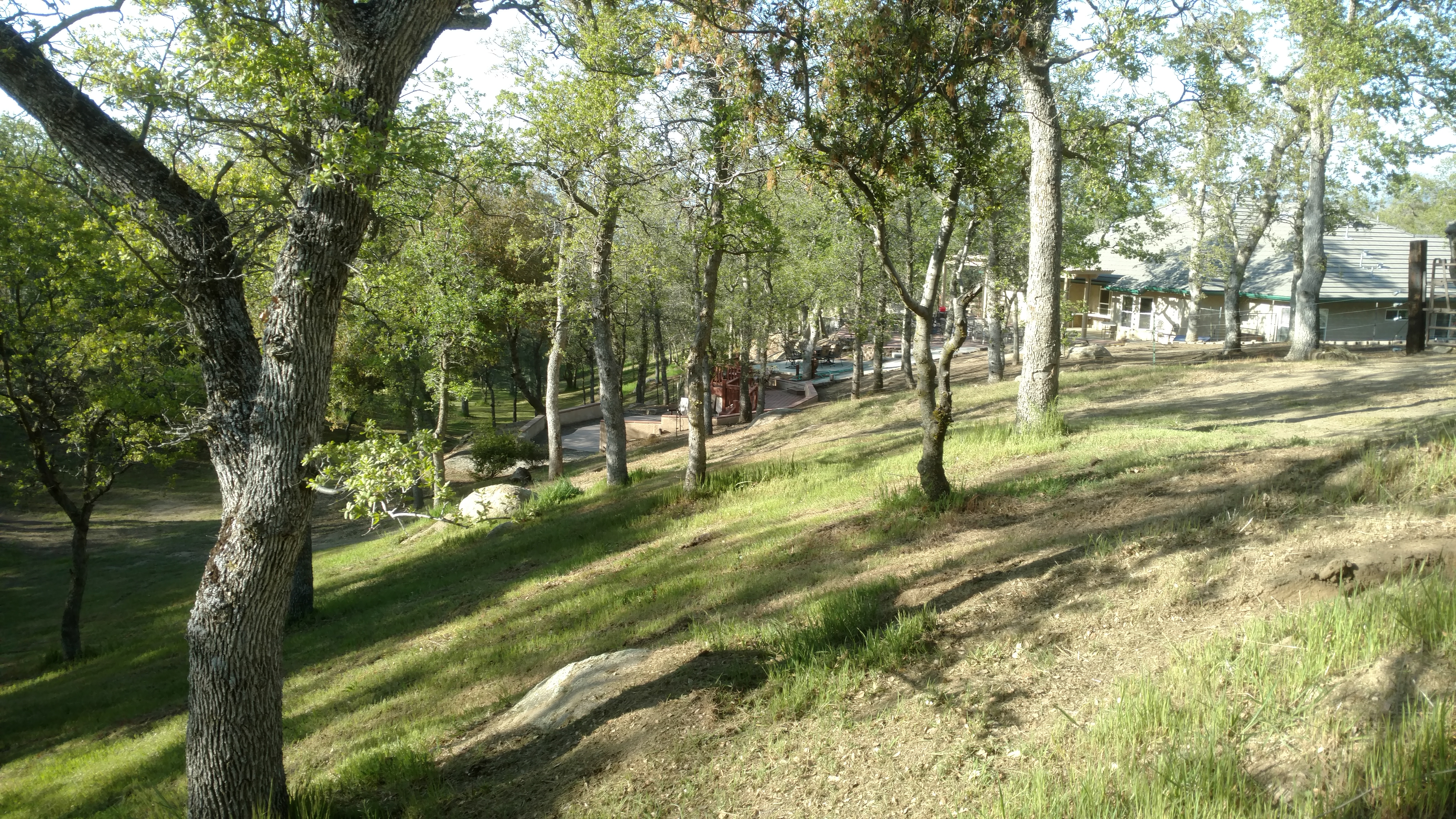

That's my neighbors hill I cut for them, there elderly and I wouldn't feel comfortable with them cutting it, they stopped cutting it 5 years ago, a few years before I bought my place I cut all the brush down and cut it byweekly for them.

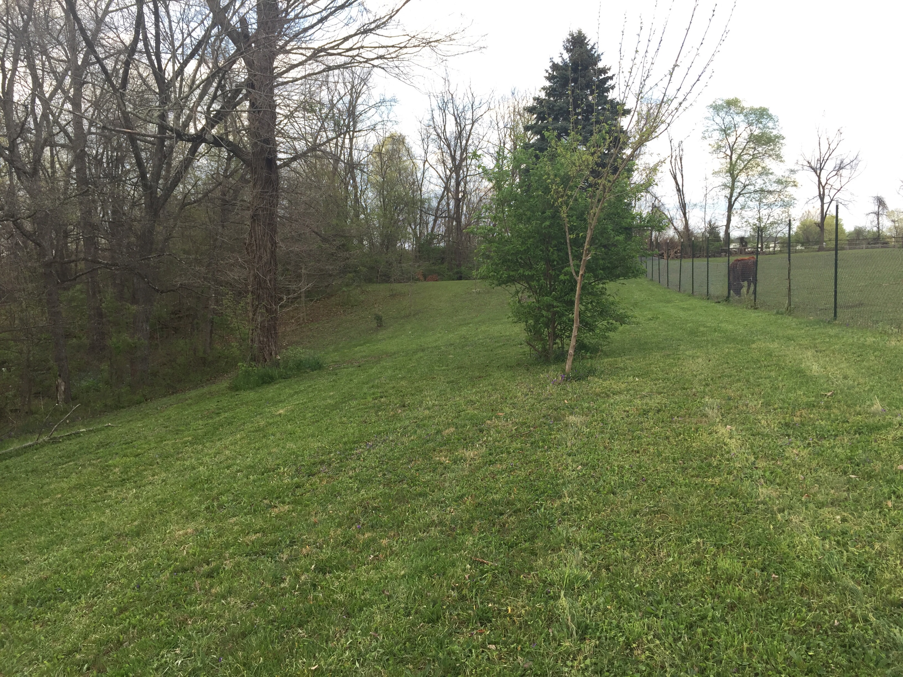

That slope looks about what I'm going go mow.
