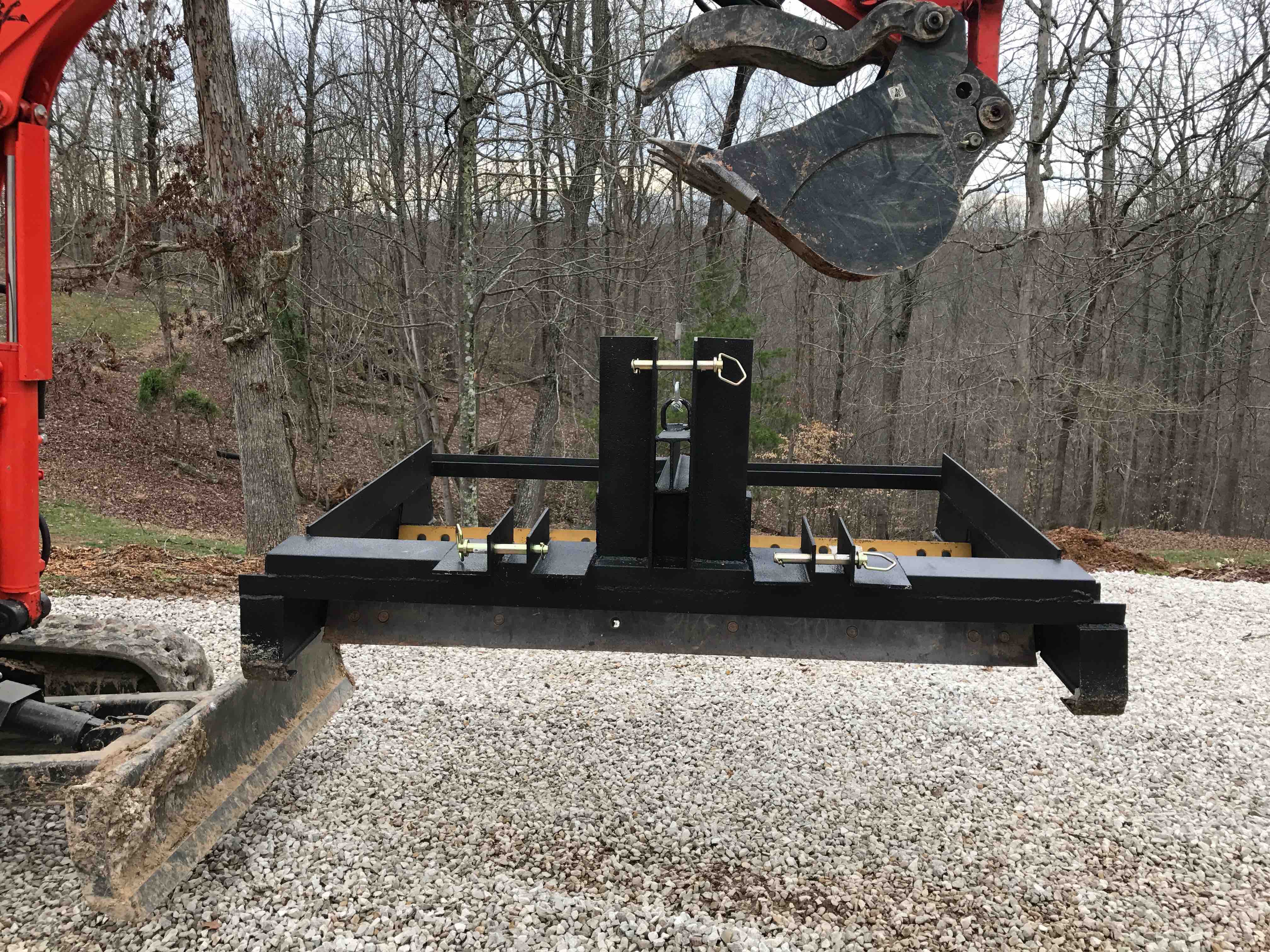

I have used RAPTOR bedliner on several projects including a Kawasaki Mule, Weight bracket, Land Plane, rear weight rack, ATV racks, workbench and several other projects. it is great, works excellent and with the prep does not come off. For about $125 bucks you get a kit that should do at least a short bed truck and you get the gun to shoot it with in the kit. A little hard to see in the photos but give you a little idea.
